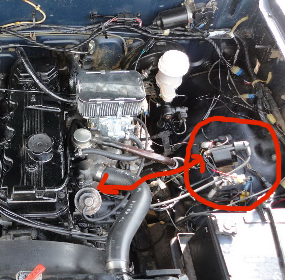

    hi littlebluedawg
    i have a 88 dodge ram sport with the 2.6l automatic
    does your truck have this kind of set up on it? *see pic*Click image for larger version.
ID:	16635 if so this is what happen to me a few weeks ago and it sounds just what happen to you. the wire that comes from the dist. to my setup on the fender was lose and when i hit a bump it lost connection . the truck died and would not start no matter what i did it just turned over and over. i was under the hood messing with the wires just kind of wiggling them and had the wife trying to start it when all of a sudden it fired off. kool yes? then i started wiggling wires again and it started sputtering acting like it wanted to die. long story short it was a lose wire tighten it up put some hot glue on the nut and bolt threads and good to go problems went away. hope this heads you in the right direction .

    ^I'd be upgrading the ignition coil to a transformer type coil like that anyway as the oil filled coils get weak from a few decades of doing it's funky thing and getting baked and rattled around. You'll get a much cleaner fuel burn and it will maintain a good strong spark when you push the engine hard.
    *don't use hot glue to anchor a wire in an engine bay james - under hood temps will soften it, it more than likely isn't solvent resistant (plus it looks like a nasty ghetto fix). Crimp up a new connection and wire and match the connection type (eyelet or male spade terminal). It will eliminate the problem coming back to haunt you when you need it least.
    agreed
    it was just a temp fix
