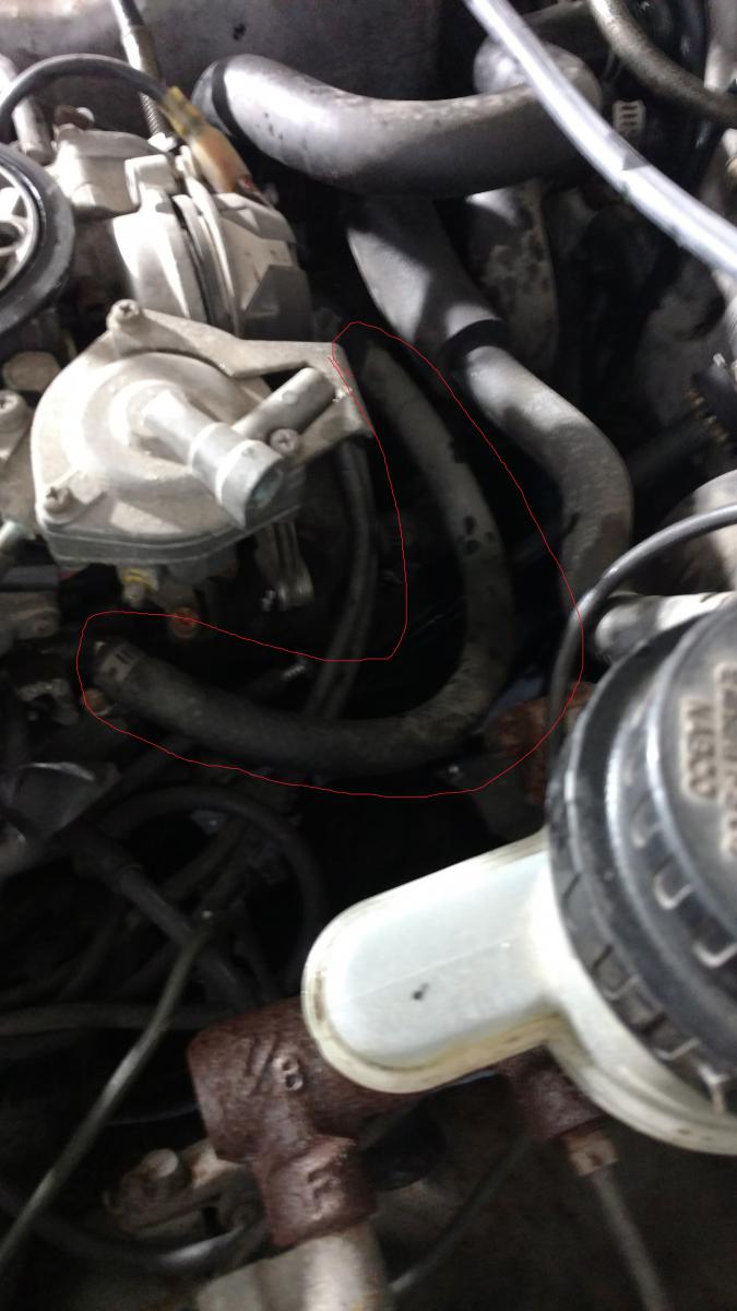

'88, 2.6L MM. Under the carb. Anyone know? (of course you do) Thanks!
That's the external coolant hose from the auto choke to the recirculation barb on the base of the carb. Got issues with it or just had to know?
Thanks! It blew this morning. No one at the parts store knew what it was so they couldn't look it up, and didn't have 3/8" coolant hose anyway. They ended up selling me overflow hose, which I'm not going to leave on there because I assume it's not rated to take actual pressure, but I just needed to complete the circuit so I could test for a HG leak, which fortunately came up negative. Now I know what to ask for when calling around for another one. Thanks again!
