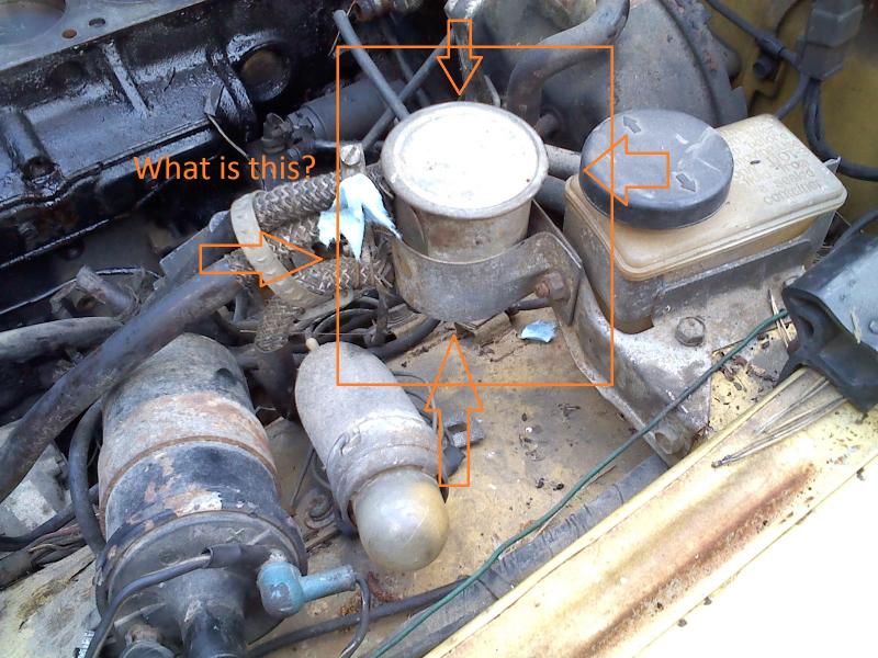

    I need some help with some parts identification from the D50 xperts! What exactly is the carb in the first pic? And what is that in the 2nd and 3rd? (looks like its for an automatic trans. And wth is the last pic of? lol

    But remember the hood said 155.93 CI, haha, I really don't care what it is, i think it is a 2.6. Anyway, I have only owned 2nd gen pickups, a 2.0 (RIP) a 2.6 4x4 and will be getting a 2wd 2.4, that carb is a minuki carb, but the second gens dont have all that other stuff, actually are you talking about what you are holding in the third picture, that actually might be the automatic tranny kickdown linkag.

    One of the previouse owners installed a manual 4 speed and the 4G52 engine. Yea that looked like it went to a automatic trans and sombody was too lazy to take it out. Im deleting the WHOLE evap system...worthless and takes up too much room. im gonna try to get rid of all the vacume hoses as possible too. This isnt the first rebuild ive done to a truck...but i know this will be the best yet >
