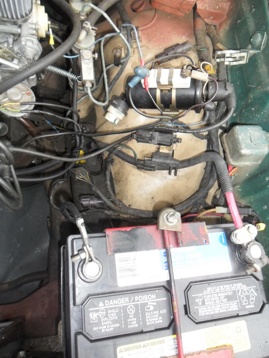

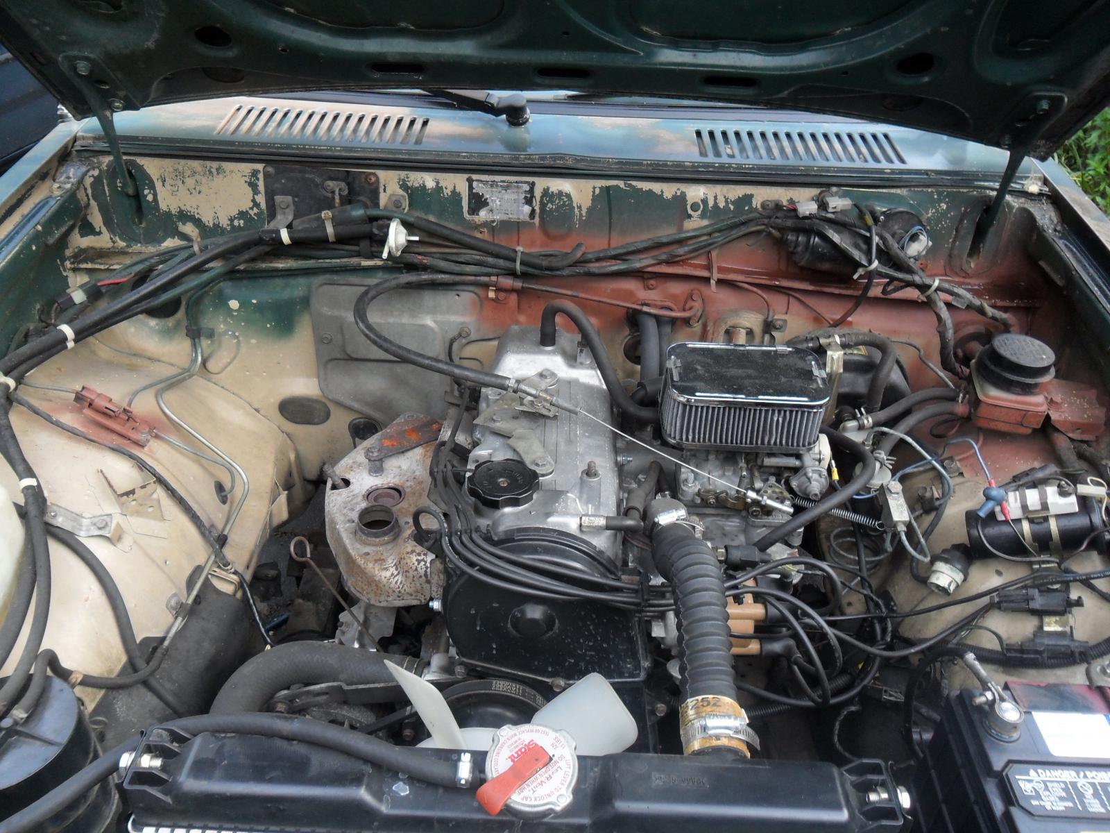

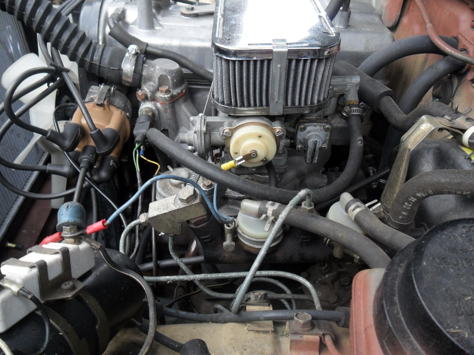

    You can see the setup. except for adding a new head, new rad, new hoses and hammering a freeze plug into the exhaust mani port after whatever was in it popped out and a new battery last month It is as I bought it. IDK what wires to trash and I suspect the carbs choke don't work right since I sometimes have to hold the butterfly open to get it to start. It probably could use a new coil. I'd like to remove all of the excess wiring to clean up the motor compartment. Oh yea I replaced the heater with a good used one. Click image for larger version.
