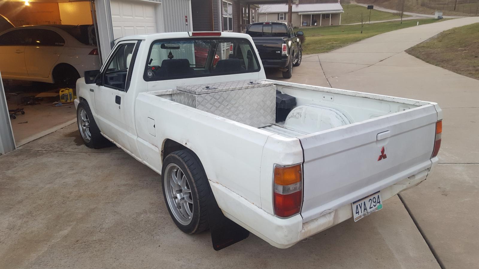

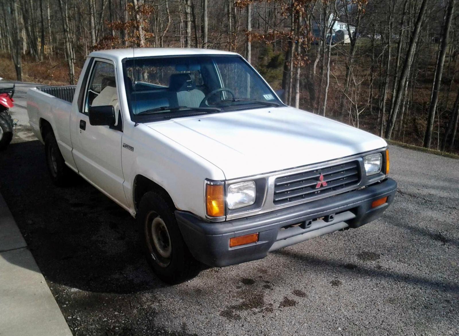

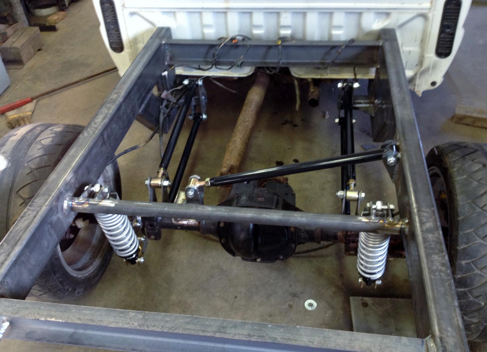

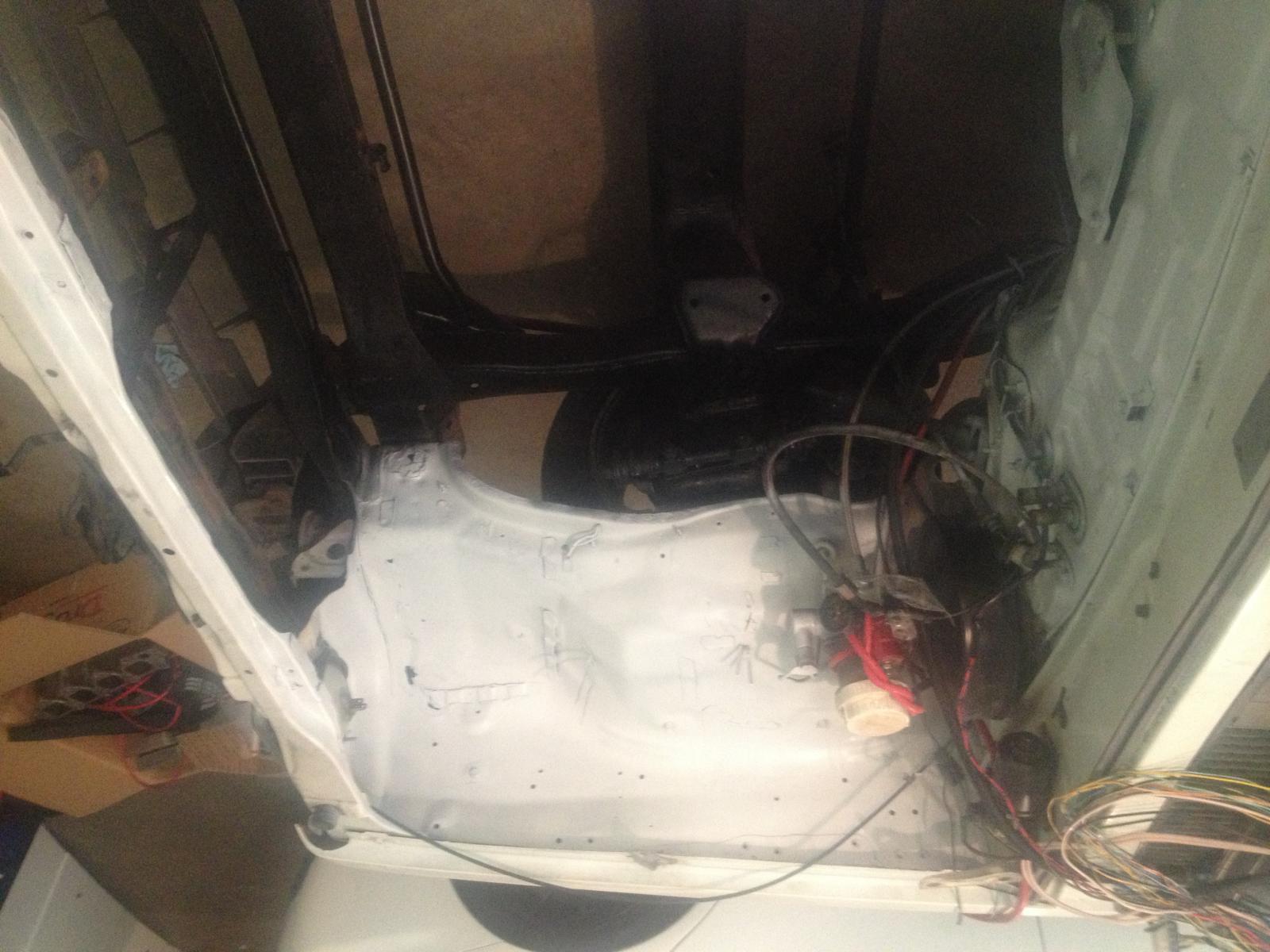

    Found a 94 Mighty Max 4G64 and got it to do a dohc turbo swap. It didn't look to bad when got it, engine bay was dirty a few dints and a bit of rust here and there,

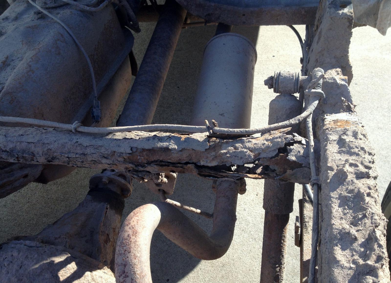

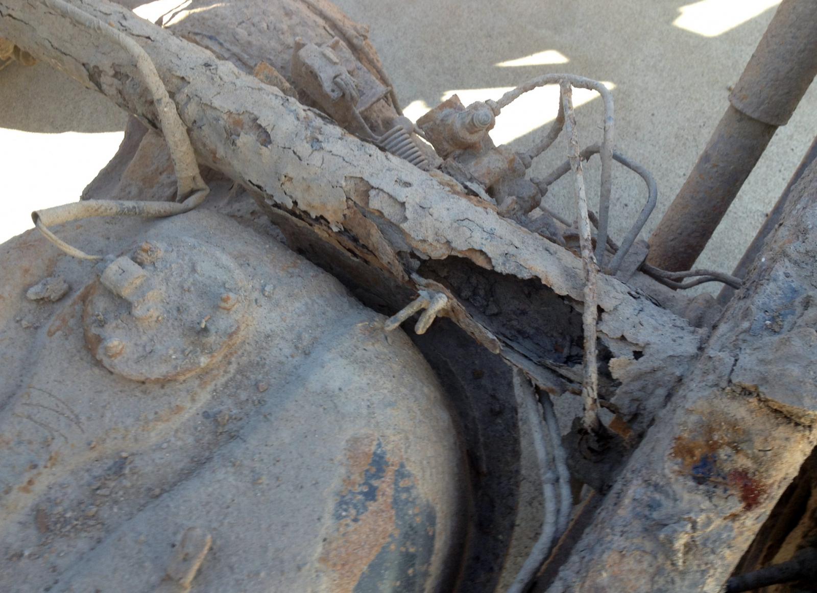

    until I got it home and pulled the bed off, the frame from the cab back was pretty bad.

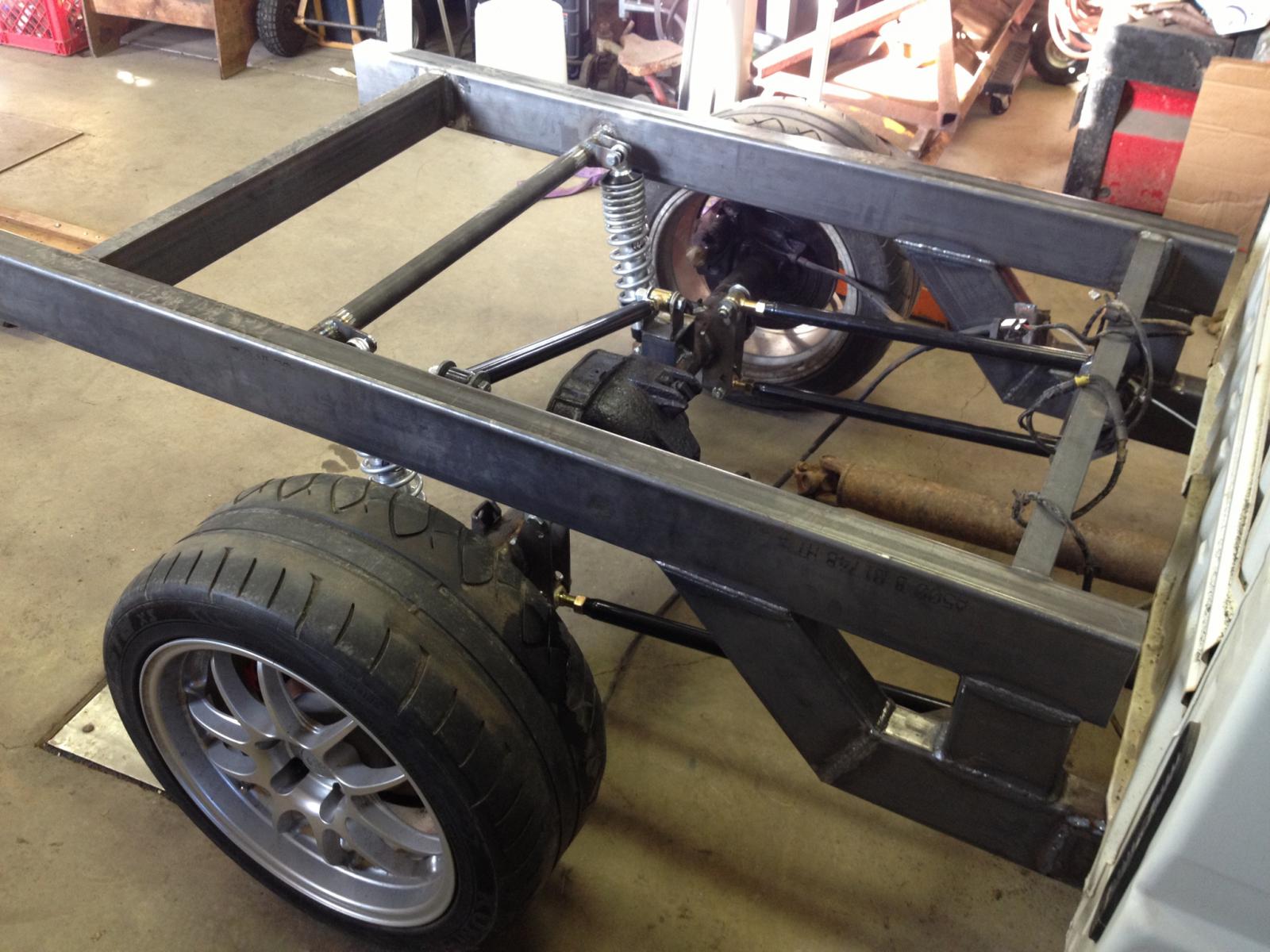

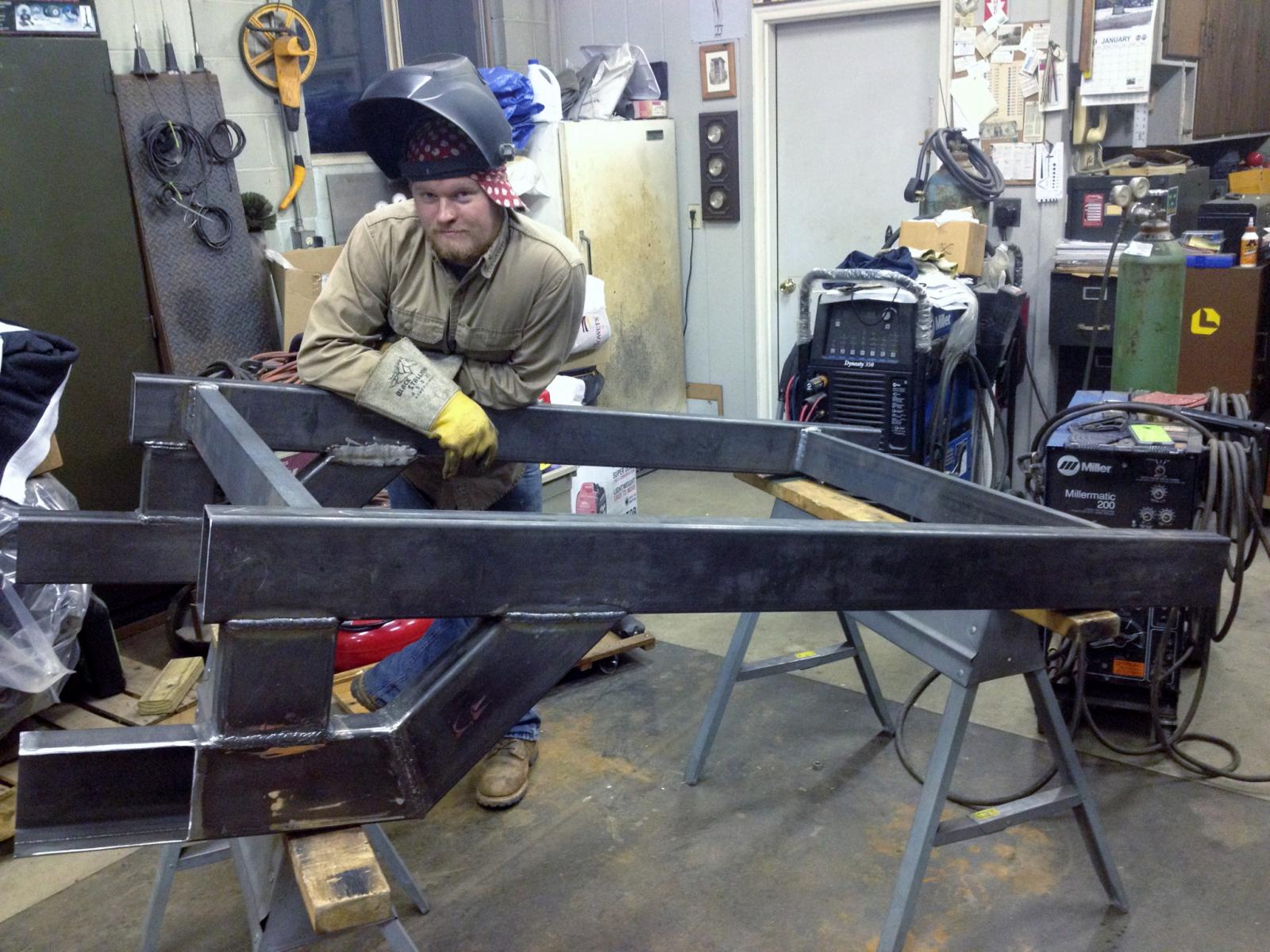

    So we cut the frame off at the cab and built a new frame.

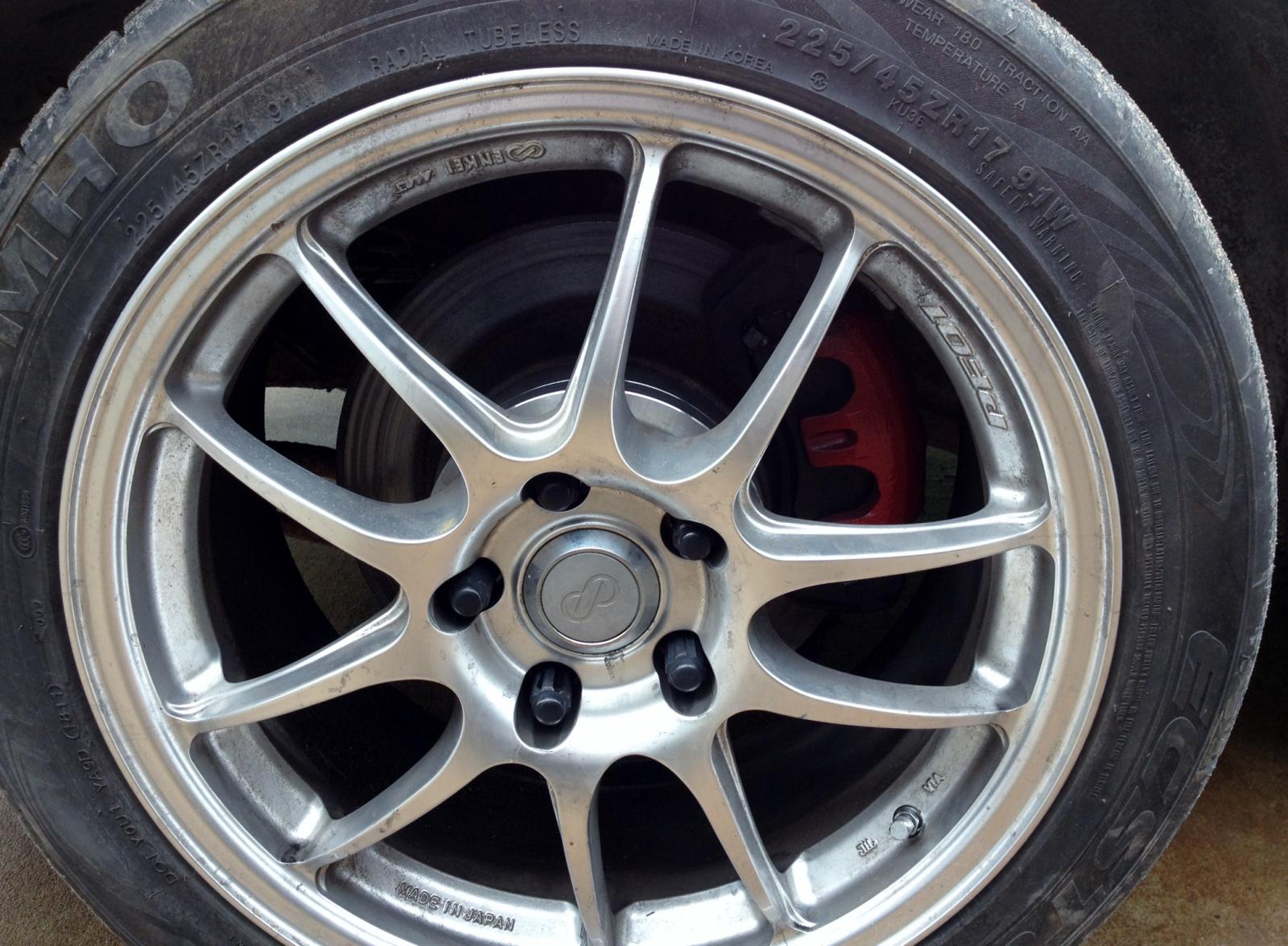

    Then we put in a 4 link with QA1 coilovers, a Ford 8.8 rear end out of a Explorer with the 4.10 gear lsd D2 axle code and Enkei PF01 17x9.5 wheels.

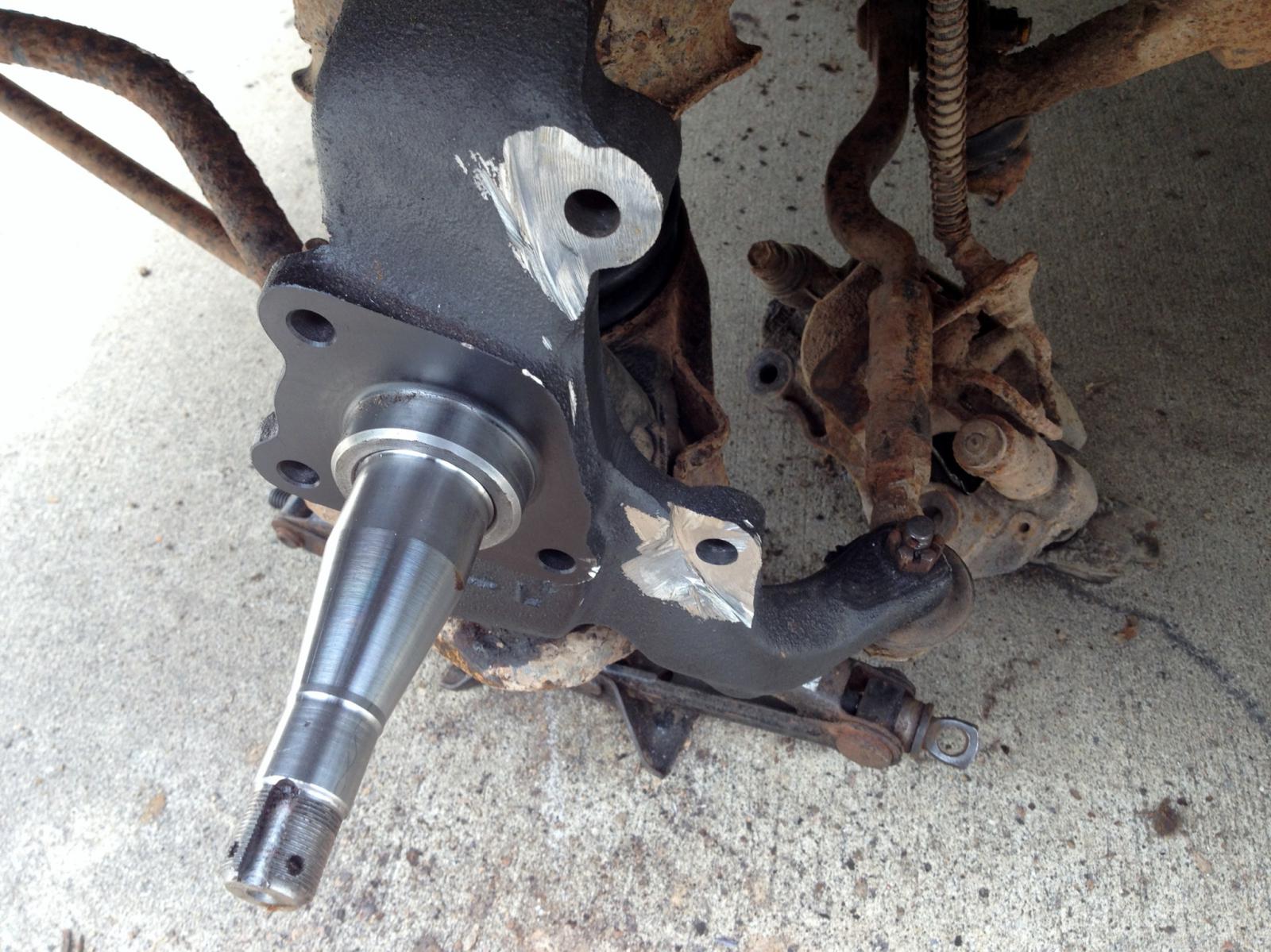

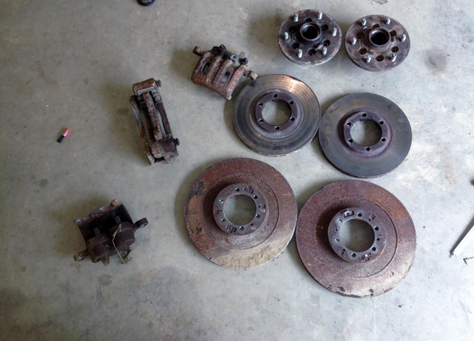

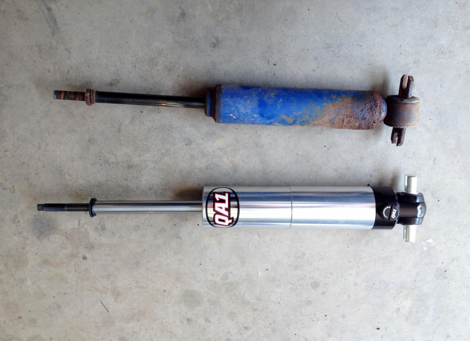

    For the front I got some custom QA1 adjustable shocks, 2" drop spindles, Montero big front brakes, 6 to 5 lug adaptor and Enkei PF01 17x8 wheels.
    Next will be the engine bay and interior.

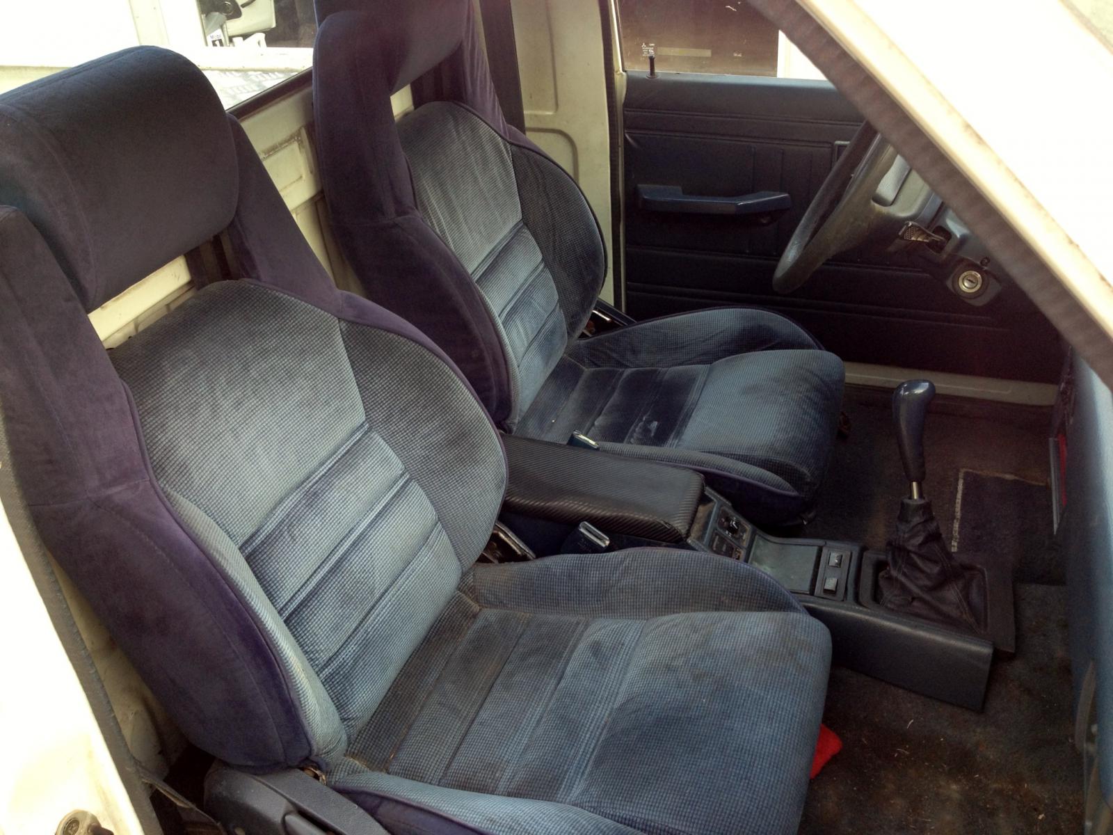

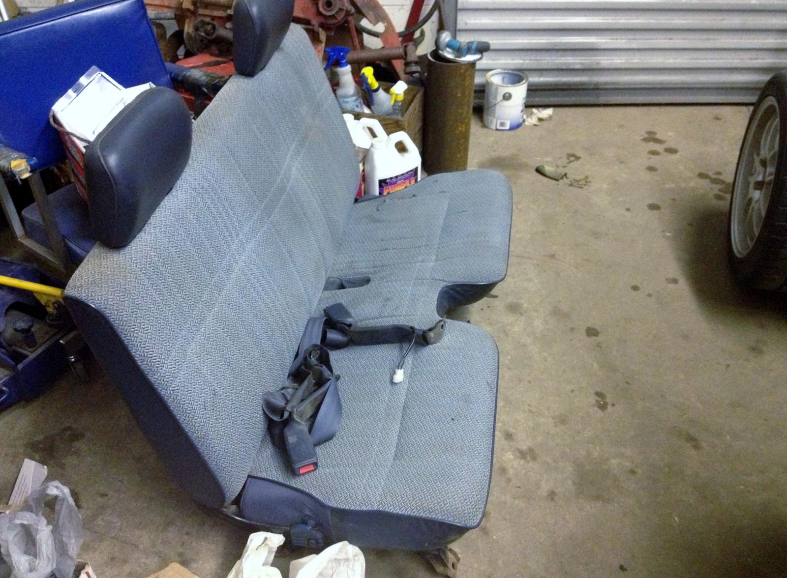

    For the interior I have a 87 Supra parts car I got the seats and center consul.

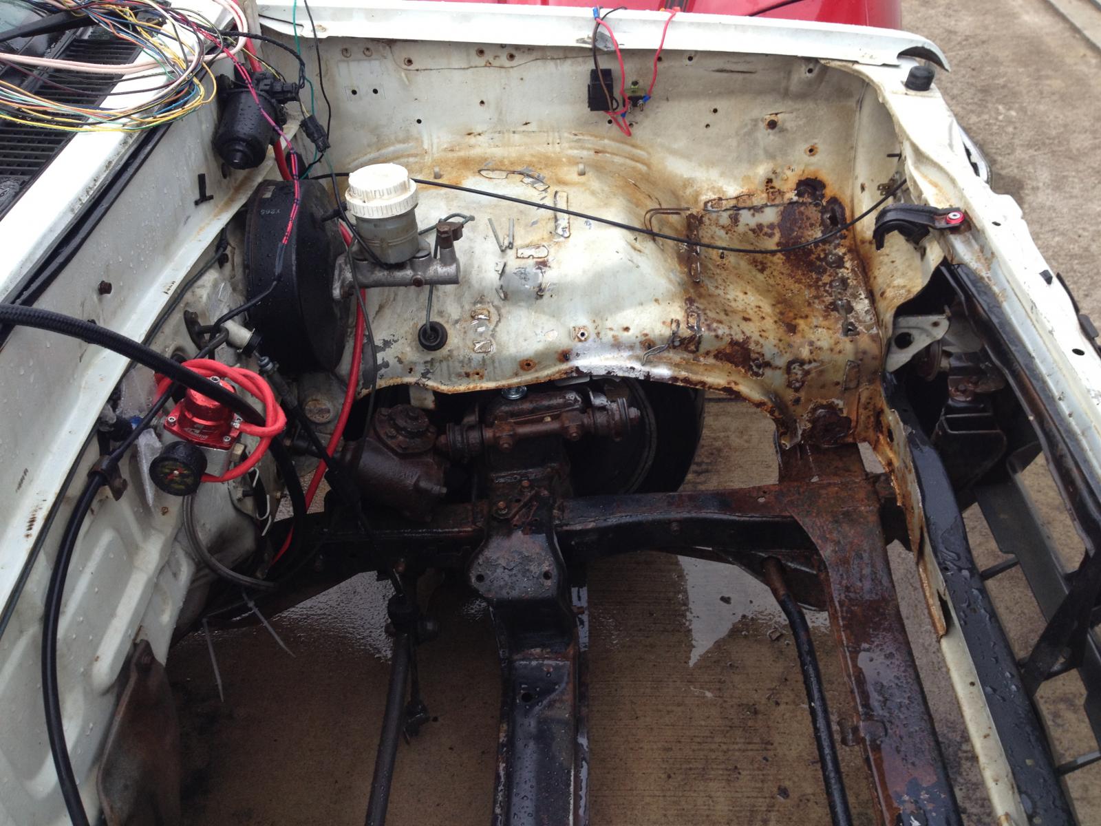

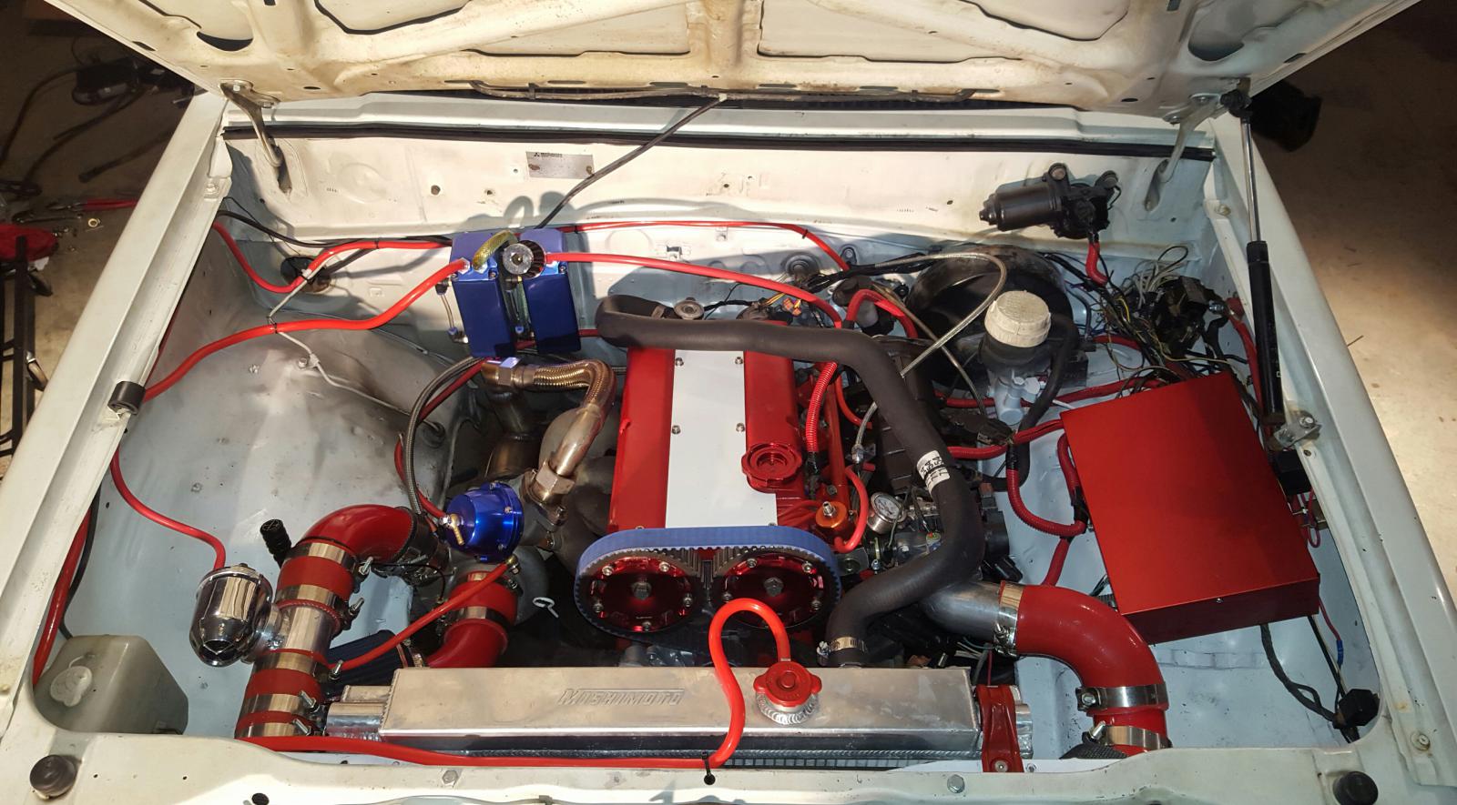

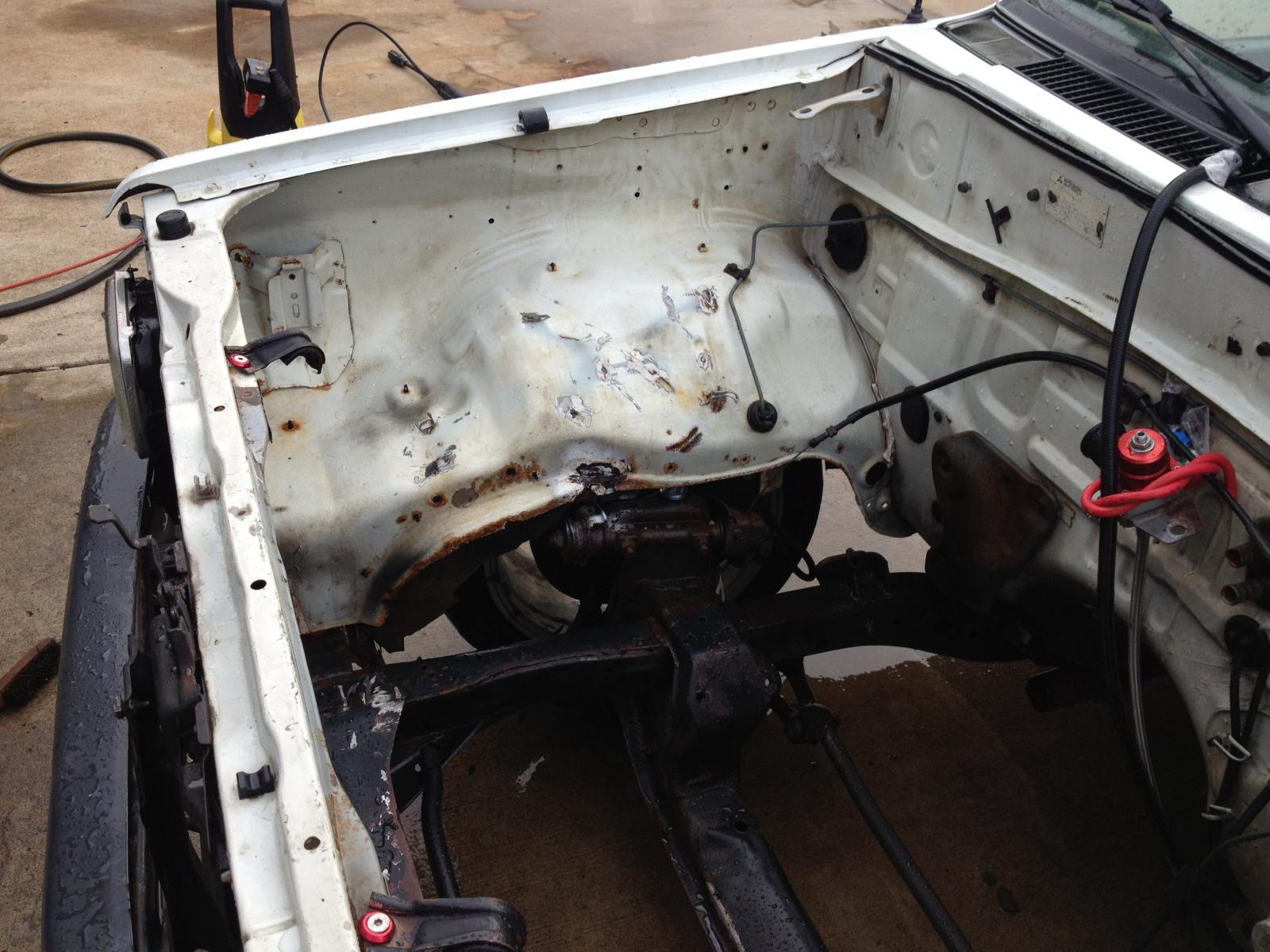

    For the engine bay I cut out all the brackets it was pretty bad under the battery mount. I cleaned it all up and repainted it
    IMG_0659.jpgIMG_0660.jpgIMG_0664.jpgIMG_0663.jpgill try to fix the last 2 later

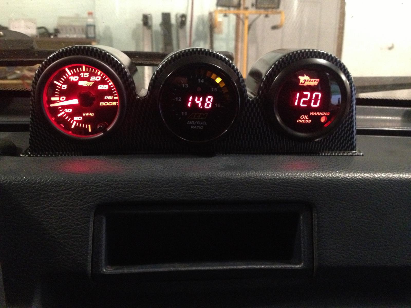

    I put in Equus 8k tack, AEM a/f gauge, Glow Shift boost gauge and Dragon oil presser gauge.
    It's shaping up nicely MT. Always like a bit of custom fab work. Lucky you didn't decide to just drive it as it was - that rear frame looked like it was ready to collapse! The Supra seats and centre console are a massive improvement. I'm looking at a floor hand brake set up as I really hate the chinese laundry thing under the dash but that'll mean no centre console for me unless I can find one that everything will line up on.

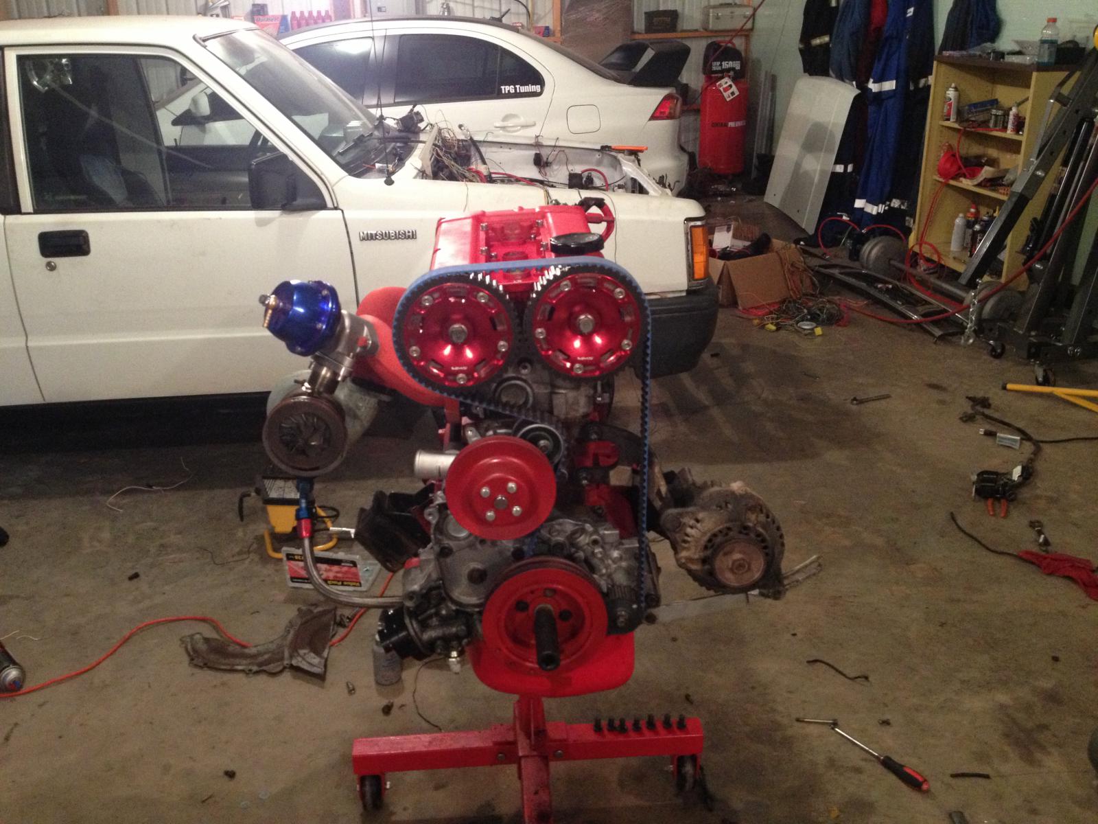

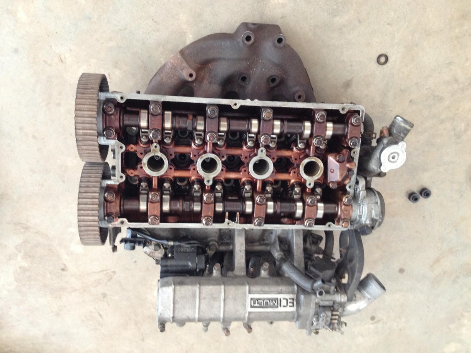

    For the engine I went with a 6 bolt dsm big port head, VMS adjustable cam gears, stock cams for now, Brian Crower valve springs and titanium retainers.
    1g intake manifold modified for front facing throttle body, 1g throttle body with iac delete, 2g throttle body elbow, t3 turbo manifold, 20g turbo.

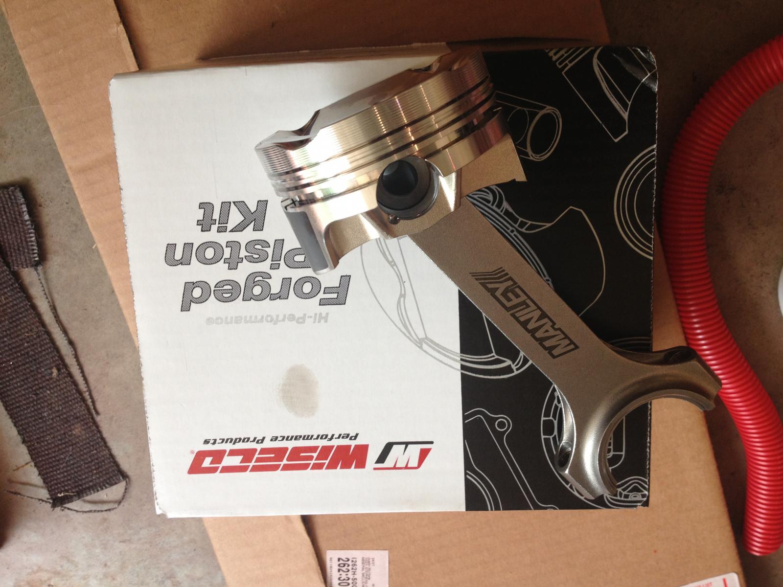

    Manley 156 mm long rods, Wiseco 86.5 mm positions, balance shaft delete.

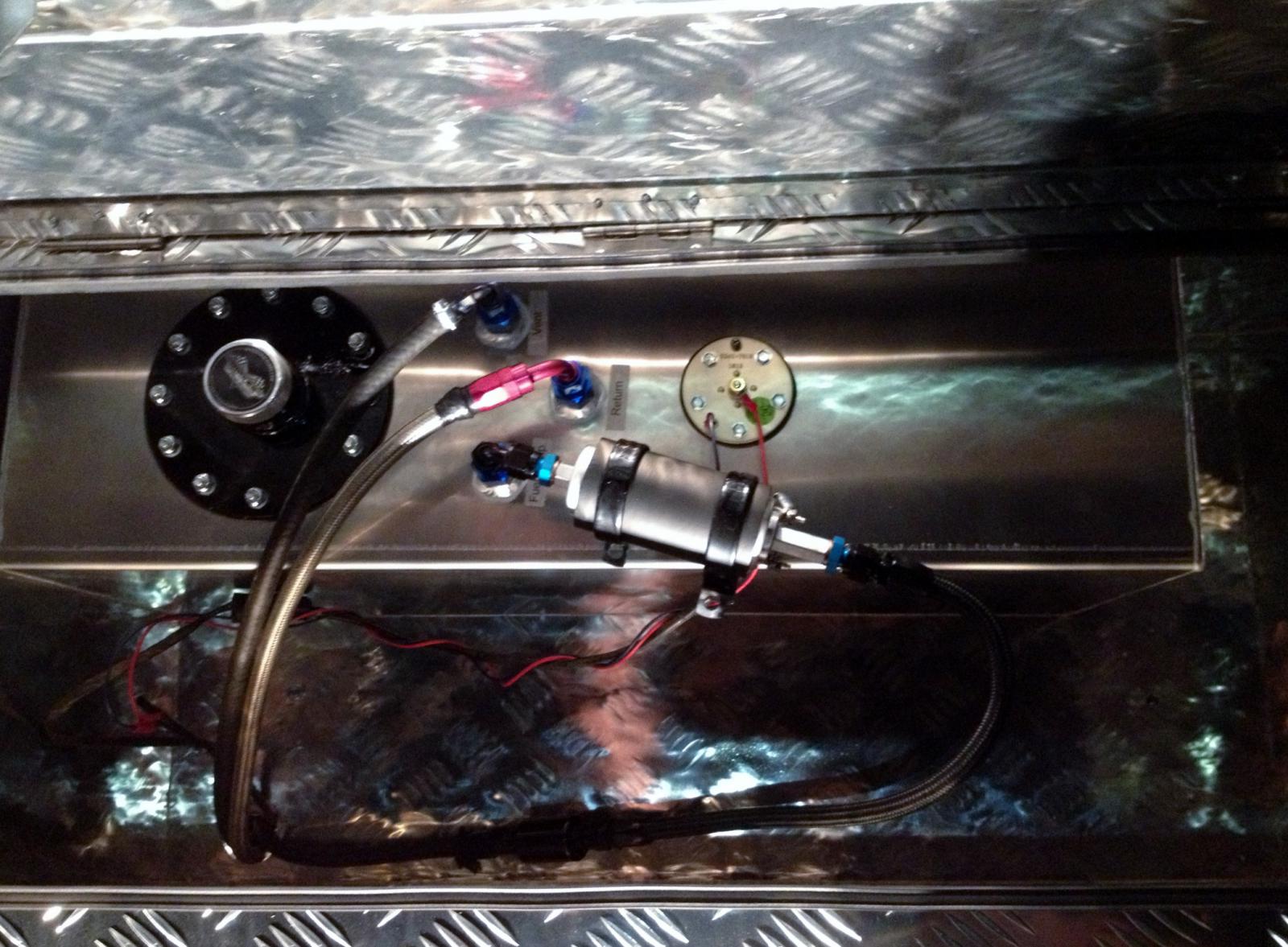

    15 gallon fuel cell, AN-6 lines, Wallbro 255 inline fuel pump, Aeromotive AFPR, 1000cc injectors.
    28x9x2.75 FMIC, oil cooler/ relocation kit, Mishimoto radiator with electric fans.
    ECM link V3 running speed density, running 20psi.

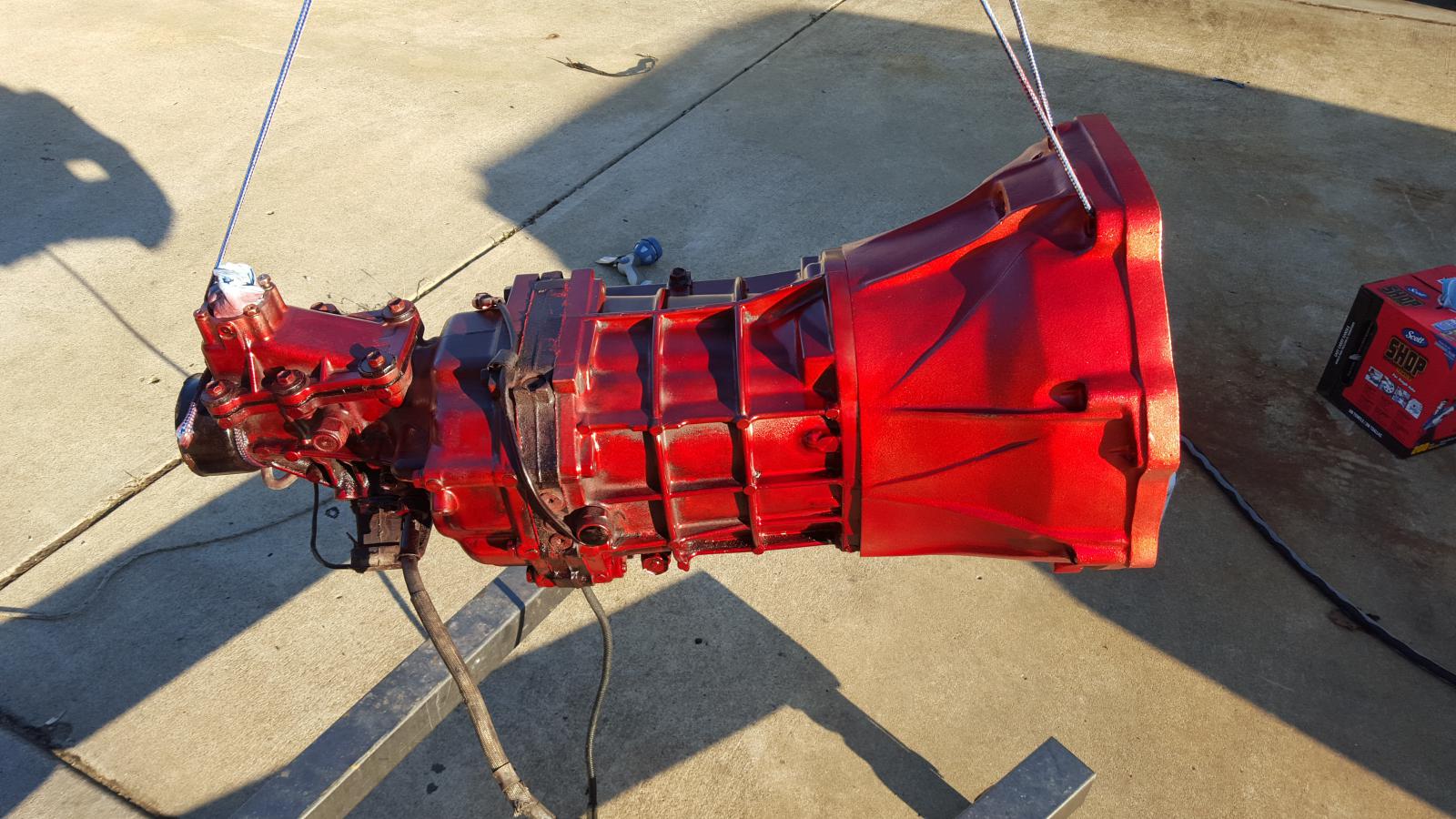

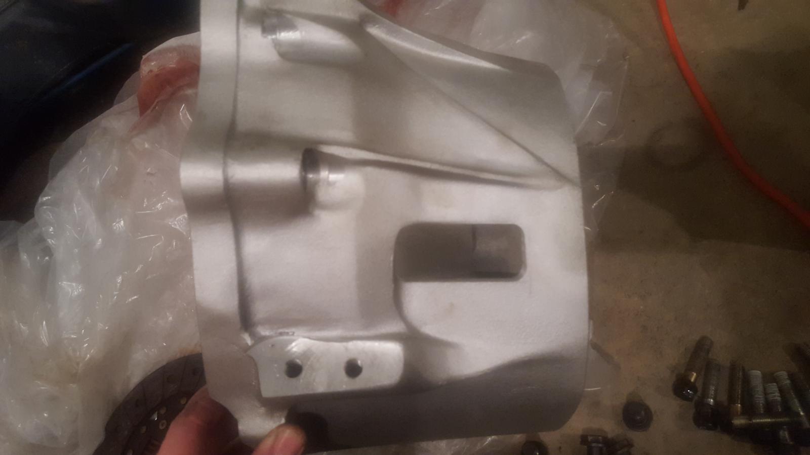

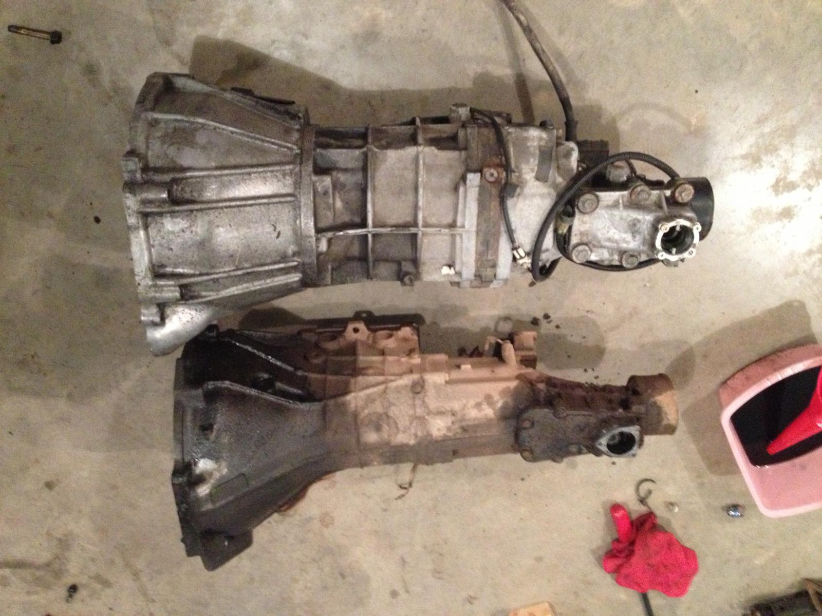

    Wide block to R154 Bell housing adapter,Mk3 turbo Supra R-154 transmission with a 4Runner ACT sprung 6 puck clutch, stock mighty max flywheel and presser plate, custom driveshaft.
    Thanks. Ya my friend did a really good job on the frame and suspension I love how it turned out. Ill probable put in a different e-brake sometime that "Chinese laundry thing" keeps giving me problems.

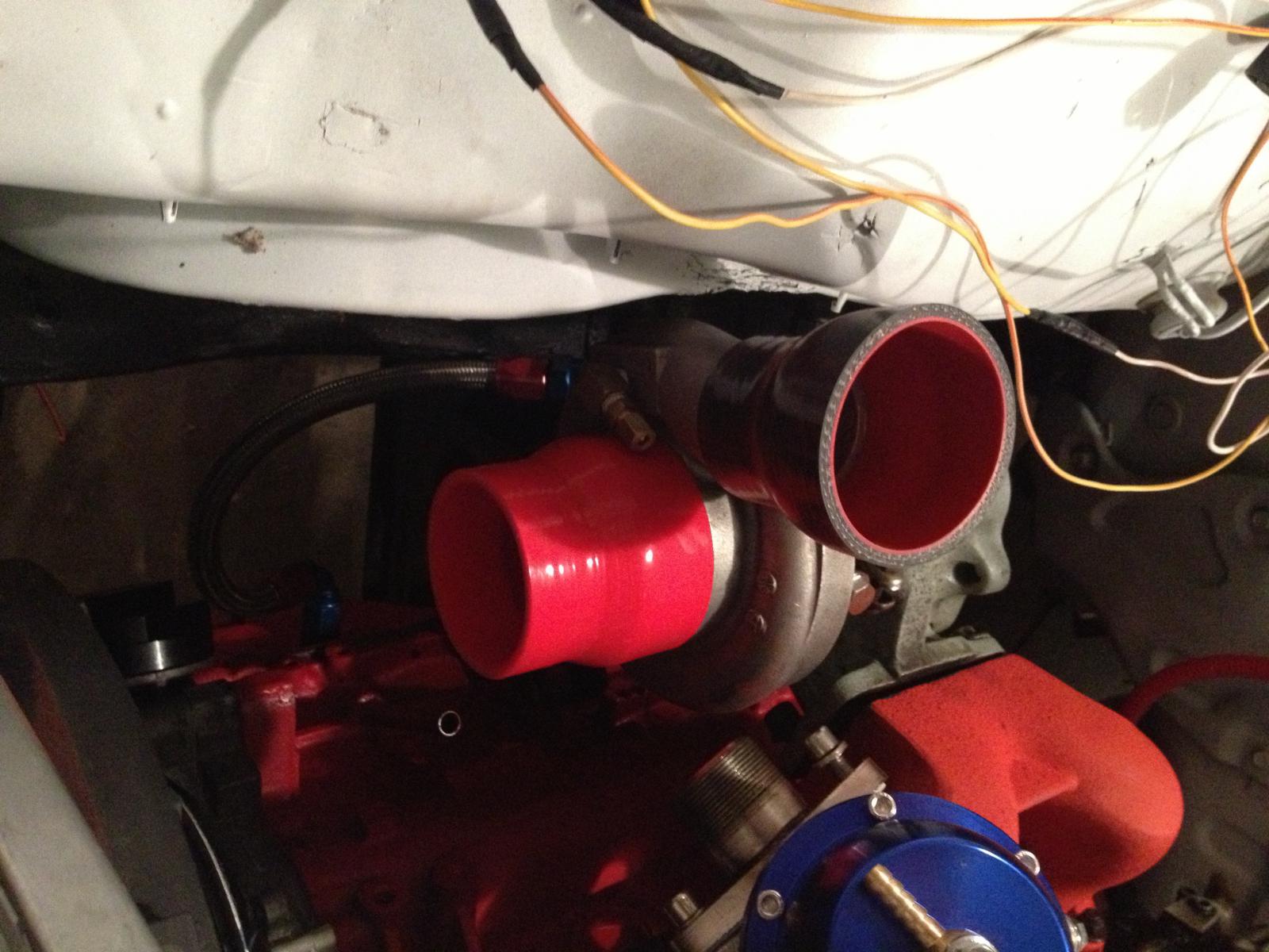

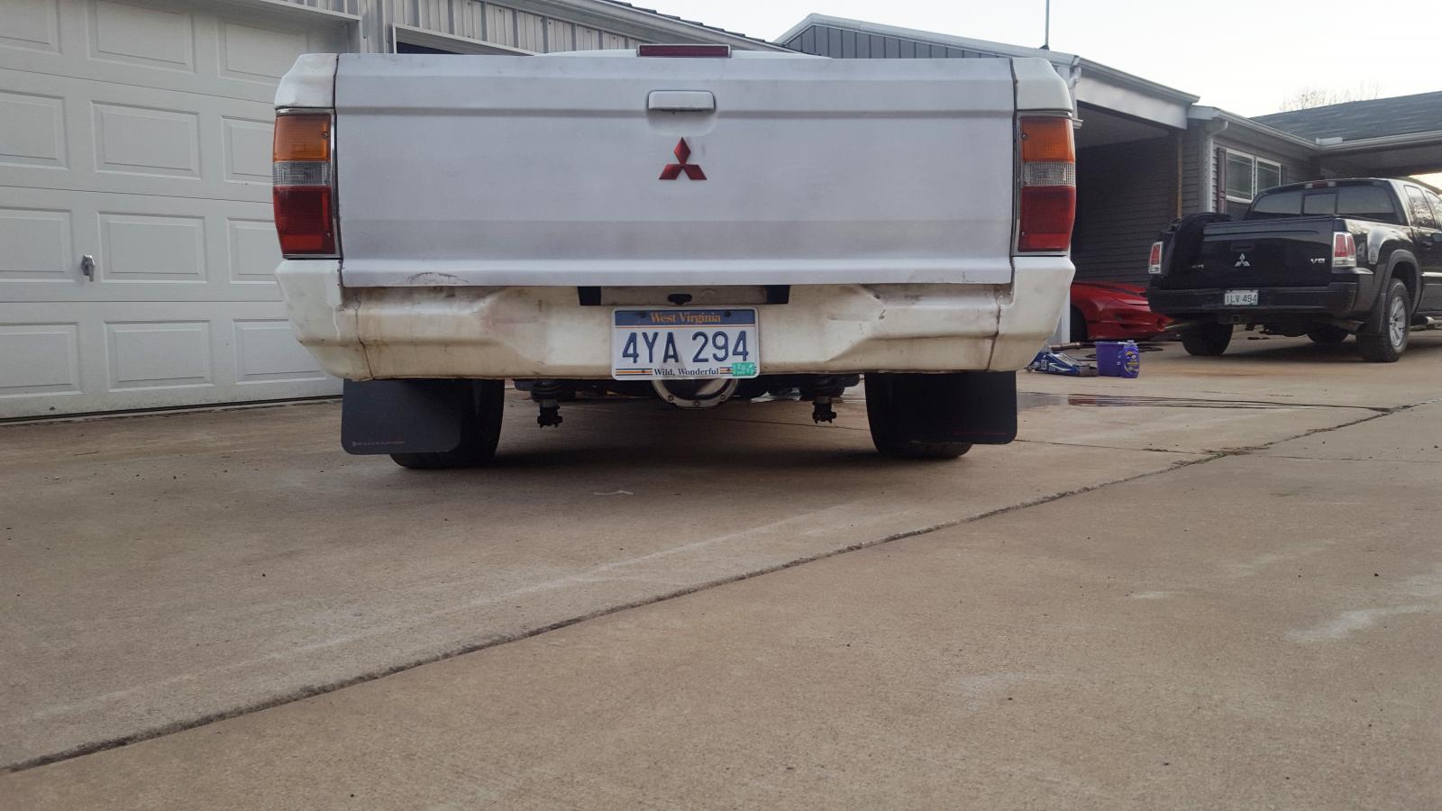

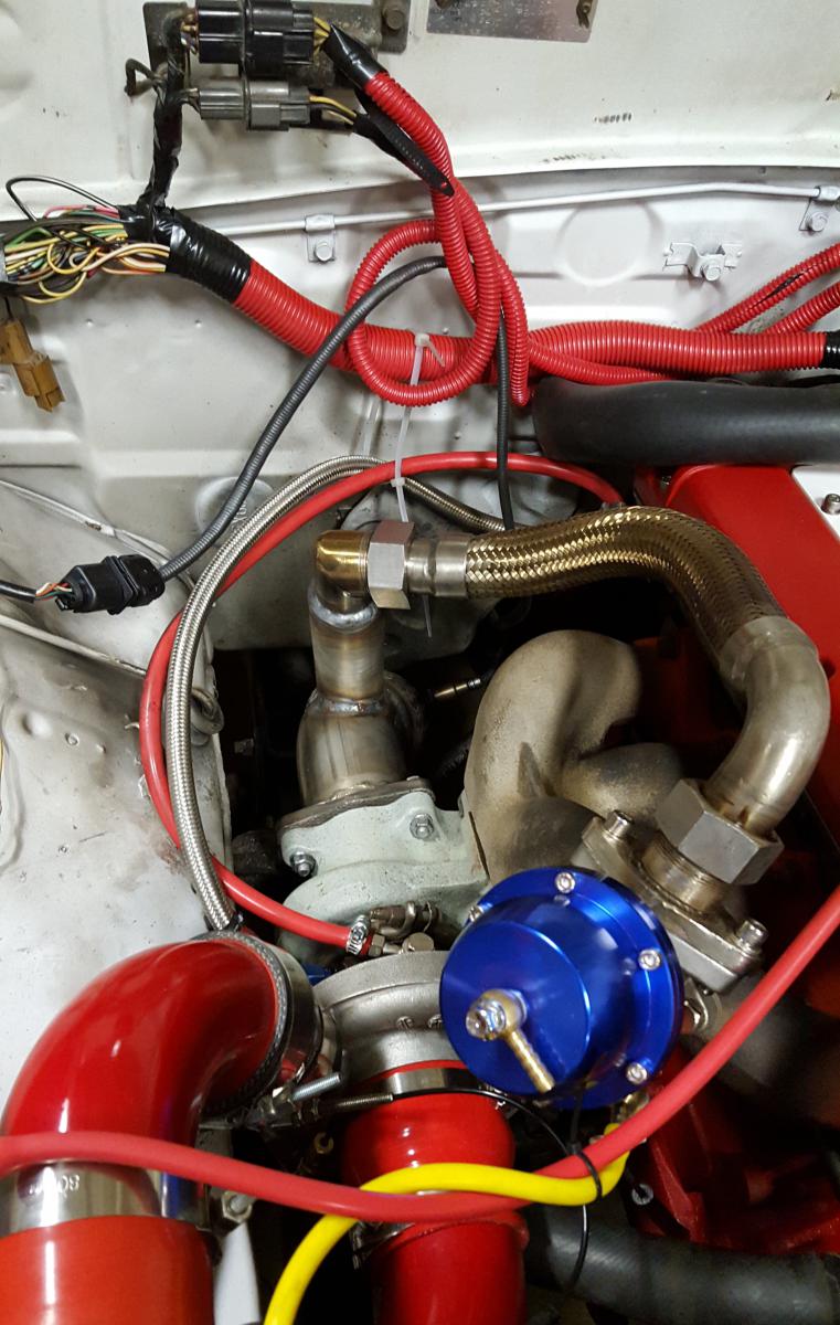

    Got the 3" SS exhaust welded up and installed
    Relocated the ecu to the engine bay and got some of the wiring tuck done

    Nice you did a waste gate that dumped back into the exhaust not a screamer pipe. Overall nice looking project!
    When I compare the new engine bay layout vs factory, the transformation is brilliant. It looks sooo much neater (I know you haven't got the wiring 100% under control yet). Any reason why you decided to relocate the ECU to the engine bay?

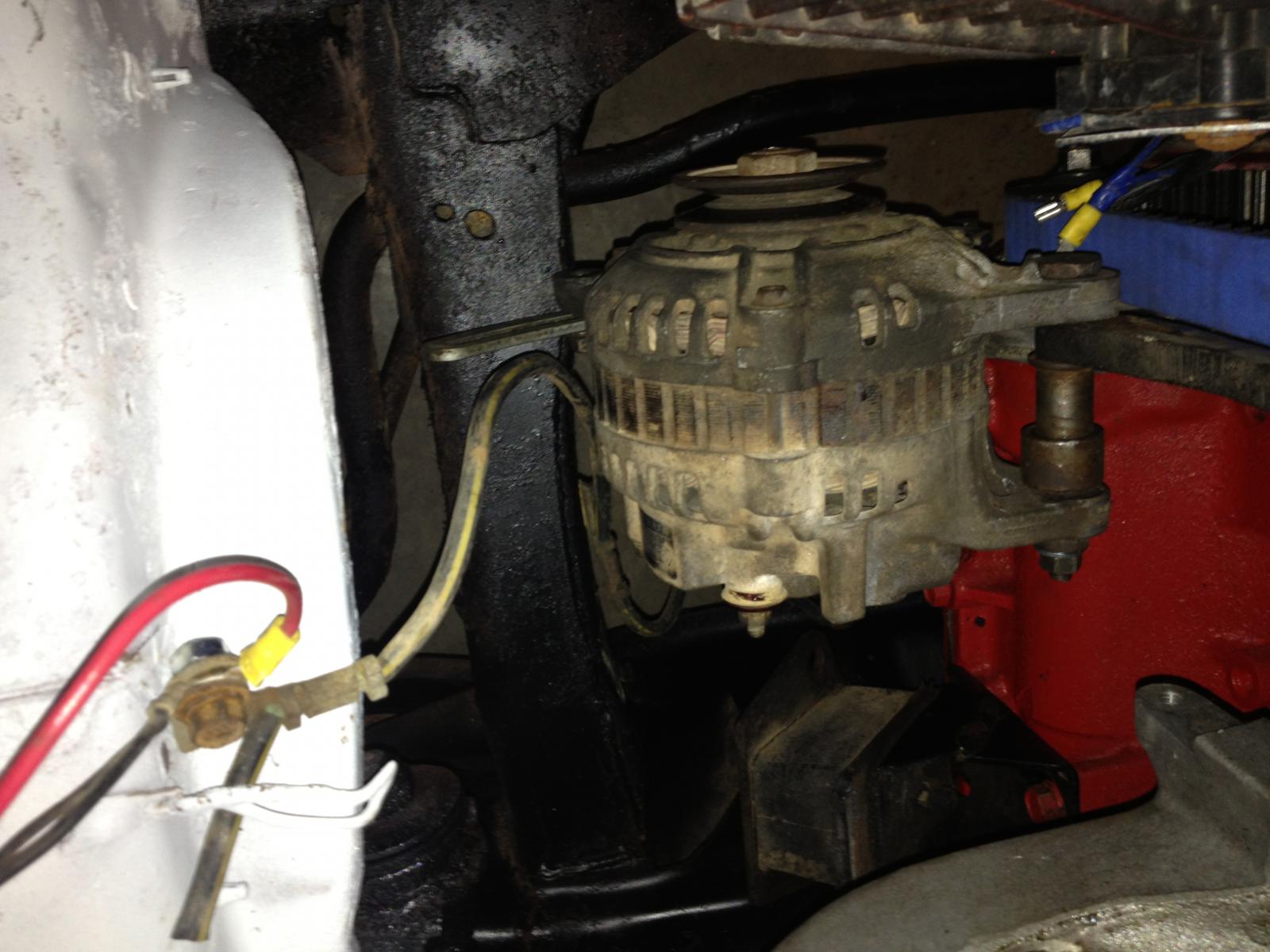

    I decided to move the ecu to the engine bay to get rid of some of the wiring with the alternator relocated to the driver side the o2 sensor is the only wiring on the passenger side so I was able to get rid of a lot of the wiring and clean it up a lot.

    The bellhousings only came with the throw out bearing and bolts. I used the stock mighty max flywheel, pressure plate, and starter, a conquest slave cylinder and a 4runner clutch

    I got the new front lip and rally armor mud flaps on today.
    Have to get new rocker panels and front fenders then get the rest of the body work done.
