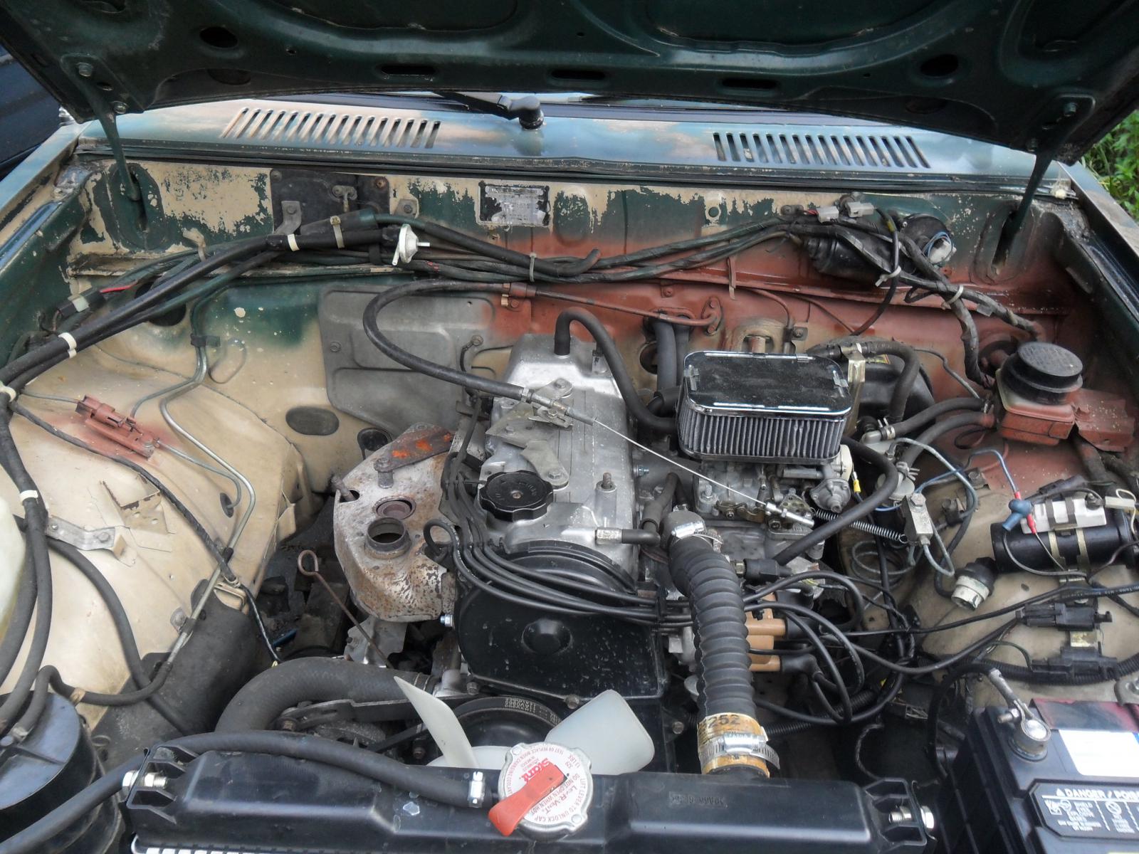

    So I was just changing my wires cap rotor and both battery cables adding a ground from frame to block. I noticed that there is a heavy gas smell on the right front side around the canister. It probably needs a new filter even though the AC and smog stuff was removed. Is it possible my return line has been crossed and I have the pump sending gas meant to return to tank to the canister? It looks like the line goes across the firewall then drops to the driver side of the brake master cylinder I assume it runs back to the tank from there.
    The new wires and cables seem to make it run smoother, blinkers are working and no electric bugs anymore (yea). Still not right though. Rock Auto cap with the brass contacts is cracked! And the NGK wires are just barely long enough to fit, no slack at all. At least they have the numbers on them.
    Your canister may be clogged, or the vacuum line to activate the draw to the carb may be split or not opening the valve for vapor draw on startup. Are you sure the wires they gave you are for the 2.0? they may have given you the ones for either the 2.6 or the car 2.0 - both are different.

    I got the wires from Rock Auto using the 2.0 section. Where would I look for this vacuum line? I think there is only one line from the carb to the distributor.

    Funny story, I went to the store today and it was acting weird. The blinkers weren't working. I stopped at a auto parts store to borrow a tool thinking the timing was off, found out the number 2 wire had popped off the distributor! I had driven all the way across town with 3 cylinders.
    It didn't want to go on either. Its like the boot is squeezing the pillar and pulling itself off by sliding up the cone of the pillar. I had put electrical lube on the tip for better contact. Put it back on and the blinkers work.

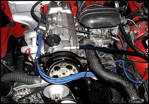

    ...say what How does that even work? The plug leads being a little short is probably causing #2 lead to vibrate off from tension. You might have to re-route the leads over the rocker cover to get some slack (yes it's not ideal but having the leads pulled tight isn't much better)
    the g63bs I have seen are routed over the valve cover.
    That's interesting. Both the 4G63's from the Gen 1 trucks I have are routed across the front of the cam sprocket cover and around the rocker cover. Might be the difference in USDM trucks.
    Round the front on mine

    SAM_0702.jpg Here is an old picture, the onl;y diff is the wires are blue now, I have the OE air cleaner mounted on the Weber and I have a metal fan shroud. There are mounts for the wires that run along the top of the valve cover and then on the corner of the timing belt cover just behind the distributor.
