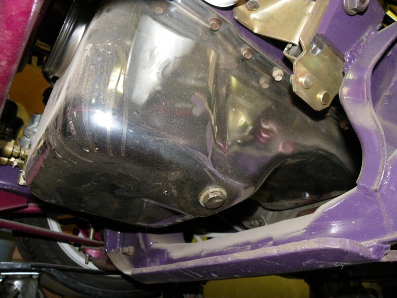

    Nice truck ive got a few questions for you. What motor mounts are you using. Why didnt you use a dual hump pan? Last one with a ranger rear end, which drive shaft are you useing and did you have to mod it any. Thanks

    the engine mounts are stock replacement 79-83 Fox body, the frame mounts are made from 3"x1/2" flat bar welder to the factory engine mount location.
    The oil pan is a 60's- late 70's front sump so it clears everything with no mod's needed
    The drive shaft is a 1 piece 2.5" diameter thick wall tube with Mustang U-joints and flanges

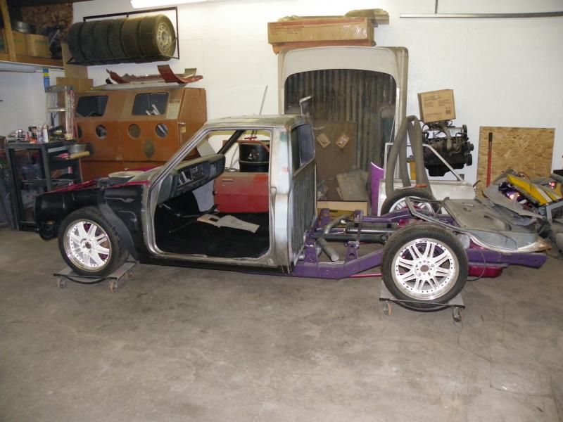

    Couple of pic's of the cab back on the frame after 5 years WOOOOOOTTTTTTTTTT!!!!!!!!!! as of 10 minutes ago
    A few more pic's of the cab mounted
