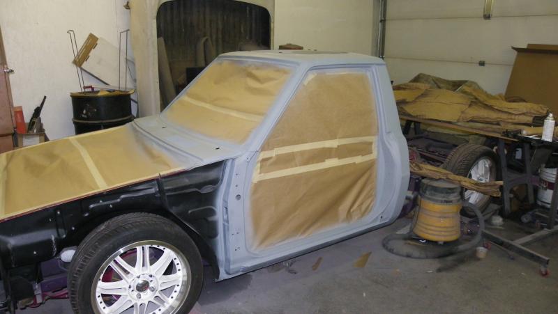

    Spent the day masking the truck and putting the first coat of primer on.I will be doing another coat then sanding it all. After that it gets shot in E-coat and then painting the door jams and window openings in body color.Maybe by next week I will have the sheet metal all back on and bolted down.
    Cab in first coat of primer
