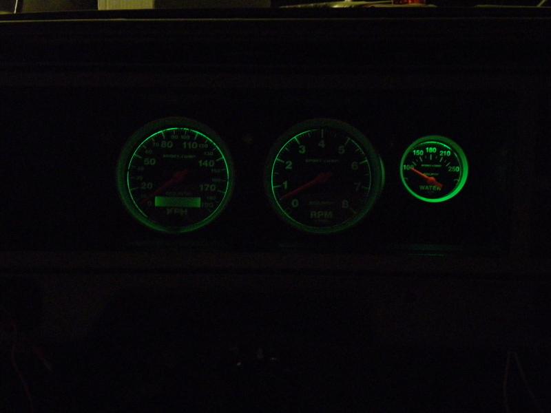

    Took a truck load of scrap in today got a little bit of cash and went and bought my gauges and speedo sensor. Damn programmable Fuel level gauge is on back order so I'll get that next week.
    Gauges in
    Pretty green

    Autometer Sport Comp. I ordered 194 LED bulbs in green from http://www.superbrightleds.com/cgi-b...sp=%2F1157.htm as the original 194's used a bulb condom. Autometer wanted $12 a bulb and I got them for $4 each from Superbrite
