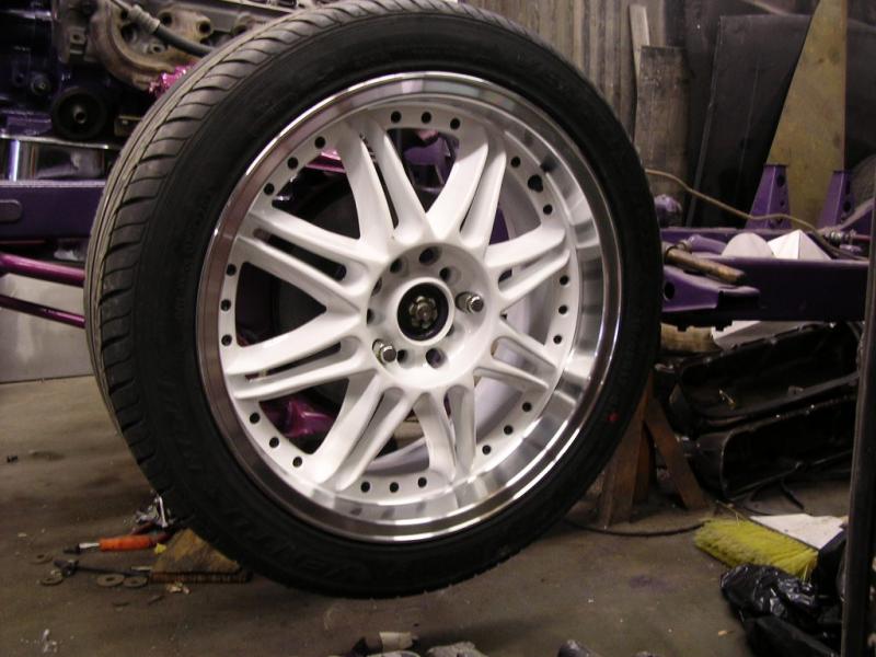

    Here something I found out by accident. Friend was doing the brakes on his 92 toyota truck and I jokingly grabbed his hub and put it on my dropped spindles. well guess what they fit.not only that it uses the same inner and outer bearings. next day I went out to the wreckers and grabbed a set.also found a sec gen D50 and took the caliper mounts and calipers. went home and with a little trimming on the mounts and spindle I was able to center it over the rotor. Woot 5 lug 4.5"x5, which is the same as the 7.5" ranger axle I have in back.
    Yea it has been posted on this site before, I have also gone 5-lug the very same way. Like the rims, pretty sweet.
