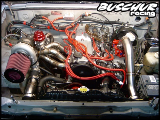

    found one, doesnt look cheap. Look at the name on it.

    That is a 4G64, and no it wasn't cheap, and it wasn't a bolt on...

    Sorry didnt really investigate the pic to see. Be awesome if a kit was offered, especially if designed to work with a weber.
