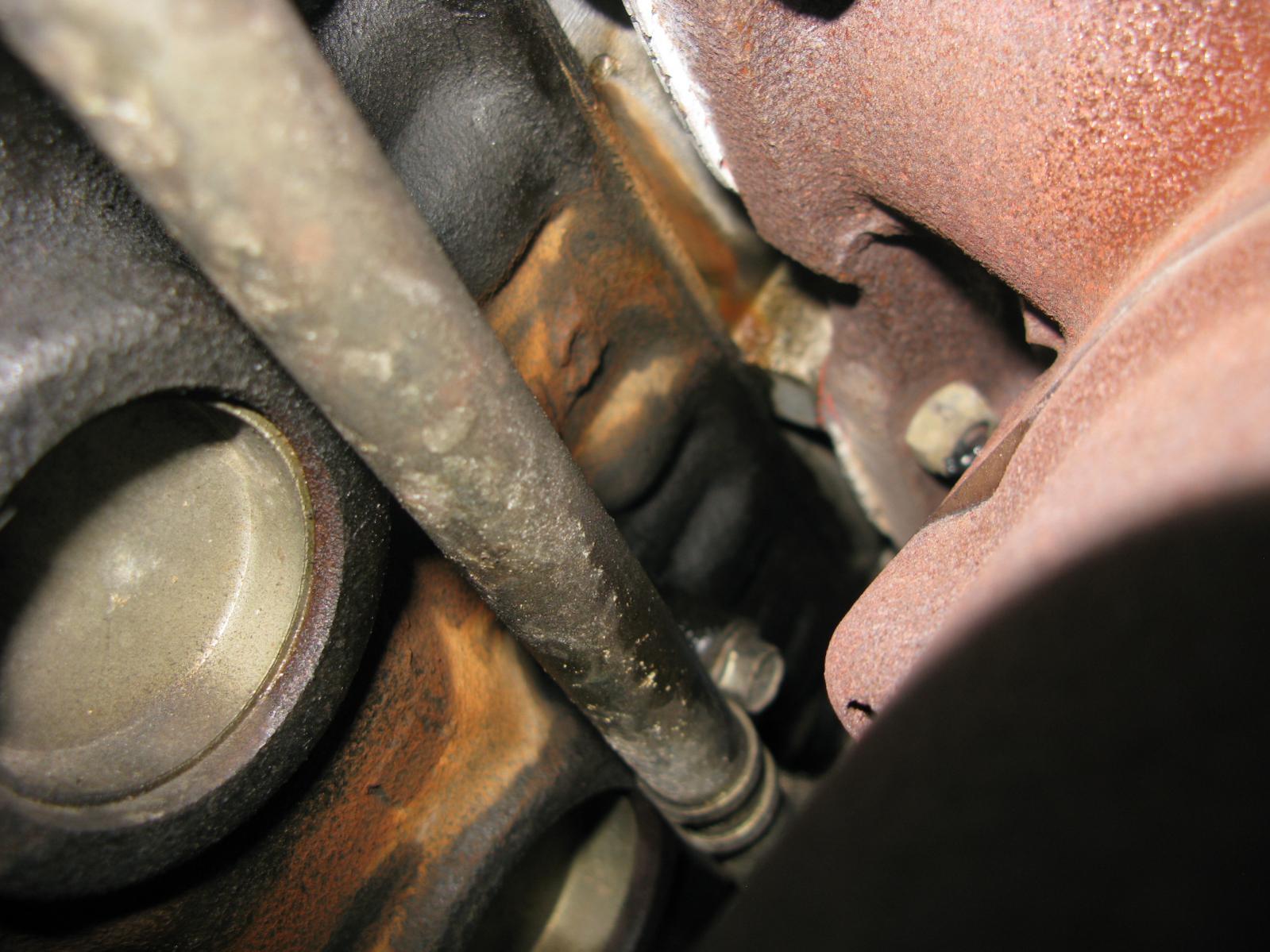

    1st, picture:
    been just about 10k miles and exactly 1 year since the 1st headgasket job, been leaking coolant slowly, about 1/2 of the reservoir full every day or so for a while now, couldn't find leak, found it yesterday (see pic) after parking for 5-10 minutes noticed a puddle under the dang truck, got dirty, took pics... grrrr.
    oil is not cloudy, coolant is not oily though does seem a tad cloudy if that makes sense, like it's not see-through any more, no loss of power & not smoking just the normal-for-this-truck cold start steam in the cold mornings (34 degrees outside again this AM) and runs nice once it's warmed up.
    NO OVERHEATING what so ever. ever over the entire last year. I check the water & oil every day before driving it, the temp gauge absolutely never ever goes over half way up on the dash.
    looking for advice, have limited days to work on it...
    thinking pull the valve cover & check the torque on all the head bolts, see if the ones on that exhaust manifold side middle are less foot pounds than the rest & WONDERING:
    #1. can I just re-torque (in the correct order of course) all the head bolts that need it IF one or some on that side lost their torque OR
    #2. has the coolant leaking past the headgasket to the outside of the block ruined the gasket and I have to do a whole nother headgasket replacement
    what would you do?

    Yes Sir I most positively certainly DID retorque them after installing it new. I remember because I had to take off the valve cover AGAIN and was so upset about it since I did such a grand job sealing it up... only to HAVE To take it off for the retorque-ing.
    I'm going to check the torque on them by this afternoon, starting from the low end & working my way up all around the pattern in the book to see if I can find if any head bolts that maybe happened to UN-torqued themselves.
    Should maybe mention that it's leaking from opposite the center of the exhaust manifold going from front of the engine to back - wondering if when the exhaust manifold bolts had worked themselves loose if that caused too much heat to go towards the head instead of away from it behind that giant exhaust gasket and somehow weakened the outside edge of the head gasket.
    If need be I got a guy lined up to check the surface level of the head already just in case.
    For reference here's what the head gasket looked like last year, looking in that same area I'll take new pics if necessary... and have him triple check the area of the head on that exhaust side area. Last time the hg blew, and I tore it apart, the same area it's leaking coolant to the outside NOW looked to be the worst area I had to clean up then.
    I'll update with what the bolts are all currently torqued at (cold of course) asap.
    Have you ever known someone to retorque after leaking coolant and had it not leak and STAY not leaking afterwards?

    Checked the bolts with the torque wrench starting at 50 ft lbs since I'm a girl maybe, lol.
    The book says cold torque should be 69 ft lbs.
    I only took the torque wrench up to 66 ft lbs - because #1 I don't want to break a bolt, & is 3 ft pounds really going to stop a gasket from leaking coolant?
    The results were:
    1. >66
    2. >66
    3. >66
    4. 64
    5. >66
    6. >66
    7. 58
    8. 64
    9. >66
    10. 66 exactly
    So, where it's leaking coolant it's at least 66 ft pounds already (cold).
    If this is the second HG you've done and they've both leaked, I would begin to think there's an underlying problem with the head or the deck of the block. I can see the voids on the exhaust side of the cylinders where the block looks cleaner, mostly #1 and #2. Also another thing to take into consideration - the head bolts. Lotta guys reuse them and not have issues but sometimes they go past their threshold and stretch.

    Well I bought the truck on the verge of needing a headgasket job, so I did it. that was the 1st time for me. This will be the 2nd time for me 12 months & 10k miles is all my 1st head gasket job lasted. I have no idea if anyone else replaced the headgasket before I bought the truck. Hmm.
    I agree, and will have the head checked for flatness, and see if I can get the block checked out, too. It would shock me if it leaked because i didn't do a good enough job cleaning the surfaces the last time, it was medical level sterile clean I swear I cleaned it for days to be sure. But it was my first time, so who knows how lucky or not I got, too. The last time it leaked at the back of the engine where it looked like the gasket was ripped when someone put it in and they put it in anyway
    I did use NEW headbolts last March, and will do the same this time, too. I was scared to re-use head bolts & still am.
    I'll take tons of pics from all different angles this time, too. Will be very interesting to me to see exactly what the hell happened!!!
    Those voids you see are from what it looked like when I opened it up for the first time. Will share what it all looks like this time, too.
    Very happy the engine didn't overheat or explode or have some such catastrophic event at the side of a road. Could be much much worse.
    Thank you very much for going through this with me. It's so tough being alone and trying to figure out everything while waiting for help to be available at home. Big appreciation for your time!!!
    Don't be scared of bustin' a new head bolt torquing it to specification. You'd have to be really unlucky or really stupid. Glad you were wise and bought new bolts. Looks like you've done everything right except maybe going a little low on tightening the bolts to spec. Hopefully the head is still straight and only needs a light clean up.

    You using NGK spark plugs I hope. There also is stuff called anti-seize that can go on the threads if you like. But, sounds like to me you may have some stuff on the threads of the plug hole in the head that made it stick. Things usually expand when hot and heat many times will help release stuck bolts.
    Also, you should be able to reuse stock head bolts if they are the stock ones. I been using the same head bolts on my truck for 30 years and never had a problem. Though you need to put the head bolts back into the same hole it was removed from when rebuilding.
    I hope you don't have a hairline fracture in block or head. We have such cold winters here and it can treat an engine bad if anti-freeze isn't properly used. A block warmer is helpful for winter time.
    Having it leak in the same spot as before is suspicious of not having head resurfaced or bad gasket material, or a tiny fracture, even using too high a pressure radiator cap.
    Torquing head and using less torque, even small amounts can cause a problem too. That stuff is determined at the factory for the amount of compression it will have compared to the pressure used to hold that head down against the pressure. Personally, and this is only my way of torquing the head. I give it a few pounds more, never less. They usually give specs for ft lbs in manuals try to aim towards the higher spec. And as Geezer mentioned, re-torque about 500 miles.
    Sorry to hear your having problems with the fluid leaking also. It is frustrating after performing so much work for it to reoccur again.
