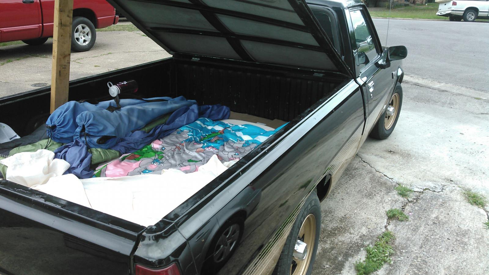

    Haven't updated in a while. Truck is doing great in Texas. Haven't driven it a whole lot since the rebuild since I ride my bike to work everyday. A parking permit here costs like $500 for the year and I can ride my bike for free! Once I get through my first tank of diesel since the rebuild I'll change the oil and have something to update then.
    On a lighter note, I took my man cub camping this past weekend and we slept in the back of Wallace. He thought it was pretty darn cool. It was nice to be somewhere with a slower pace, but holy crap... camping in Texas is so crappy because it's so hot and humid. I grew up in the Rocky Mountains where it cools down at night and a fire is to keep you warm. A fire here is only useful to stand next to to get really hot and then that way it actually feels sort of cool when you step away. All in all my boy had fun throwing rocks, playing in the dirt, collecting sticks, looking for alligators, and riding and sleeping in Wallace. That was the point.

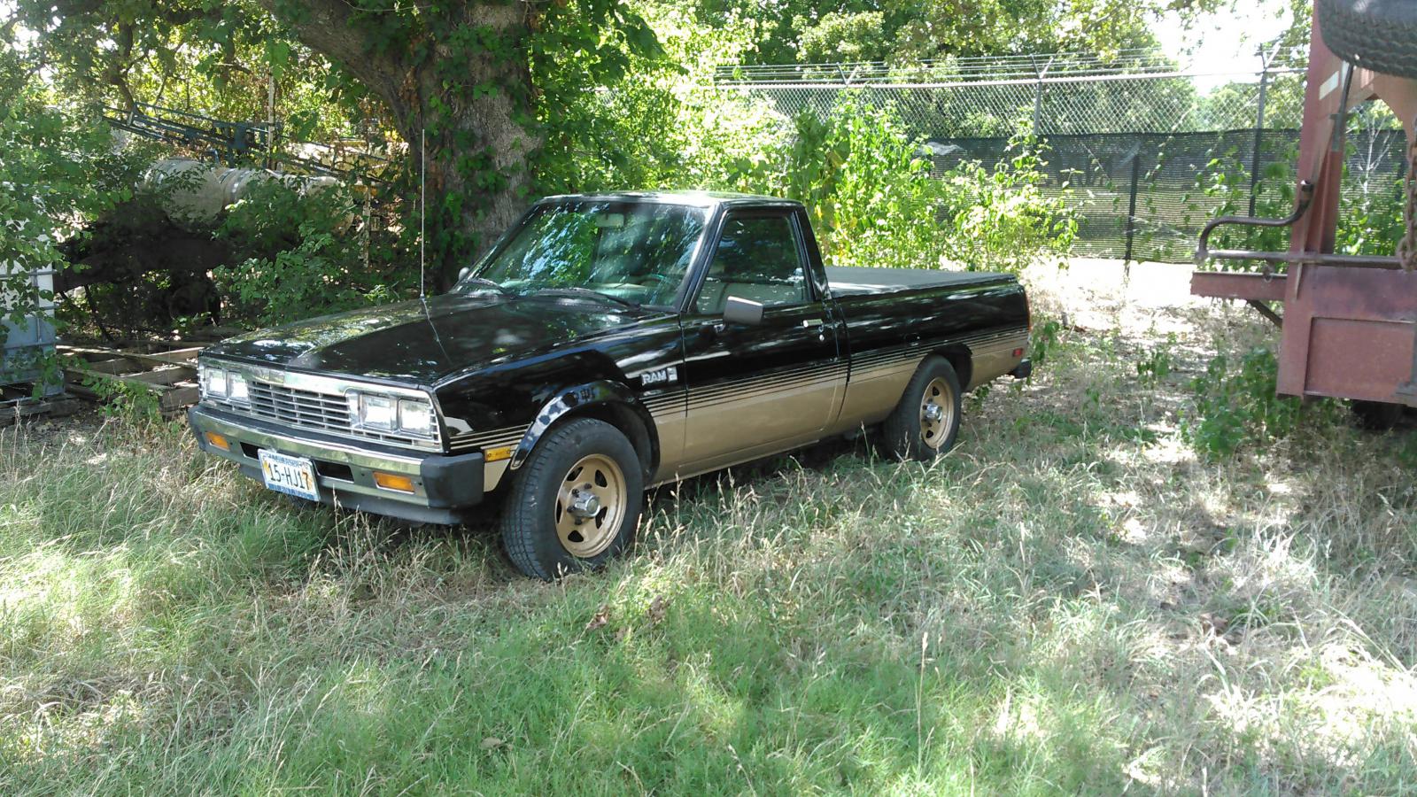

    I just thought the truck looked good in the shade and thought I'd share.
    In the past 80 miles or so the valve cover gasket has started to leak towards the front on the manifold side. I had an extra gasket so I cleaned it all up and put it on and it was even worse, so I will park it until I have the chance to mess with that debacle. Otherwise the truck is doing great!
