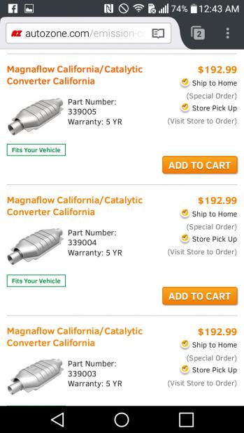

    ey guys so i have some questions here..im in the market for a new catylitic converter and i wanted to get one NEW as cheap as possible. I dont really care about the brand as long as its gonna work well and i dont mind buying online...let me know what you think. Also heres an attached pic of the cats at autozone..theres 3 of them and they are all for my vehicle but they have different part numbers and im not sure whyClick image for larger version.

    Interesting, just researched the Walker & Magnaflow units ,both are C.A.R.B. approved for Ca.
    Almost an $ 90 difference between the price !!! (Walker -about $110, pt # 80904, )
    Both units have a 5 yr warranty ???so the diff is ???
    Tylermm95---On the Magnaflow pt #'s
    339003 is a 1.75" inlet & outlet,
    339004 is a 2.00" ---,
    339005 is a 2.250" ---,
    And be careful, some exhaust shops (Ca.) will not install a convertor not purchased from them !!!
    Pretty sure Your '91 is a 2" inlet & outlet.

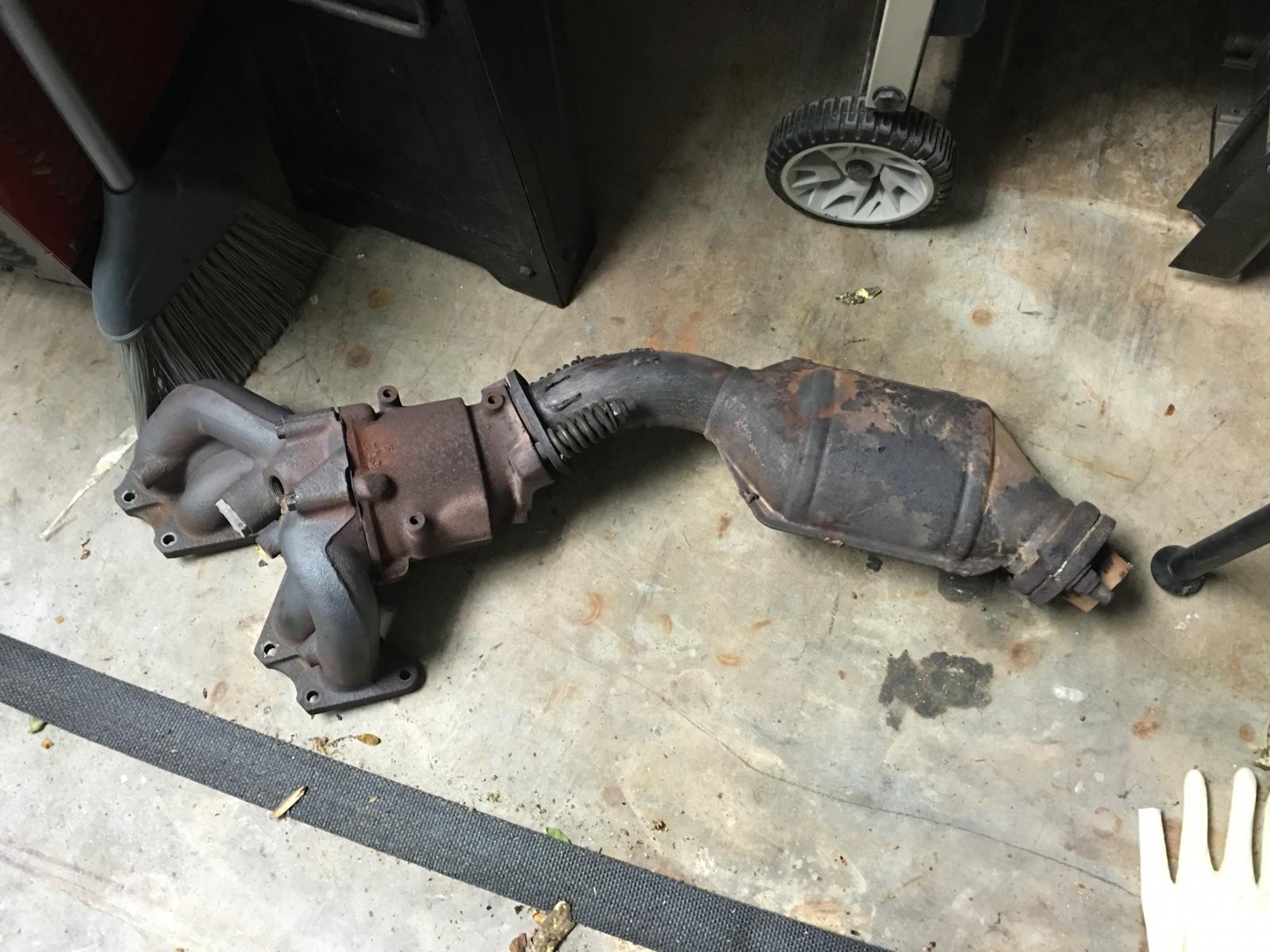

    I just pull one off my 86 2.0, if it will work for you send a shipping label this way. Click image for larger version.

    86 is different from 87-96.
    Since he is in CALI he needs a CARB compliant cat which is why they are so much more expensive than some of you may remember getting them for. So yeah you need to either buy a carb compliant cat or get one thats not CARB compliant shipped to someone not in Cali and then to you(It's illegal don't do it(disclaimer)), but then you CANNOT get it smogged without a CARB compliant cat, they look for the CARB numbers on the cat and run them to make sure it is legal in Cali and if you don't have it then you are SOL and fail.
    Any CARB compliant cat will be fine, find the cheapest one that has the same size exhaust tubing and made for our trucks and you will be fine.
