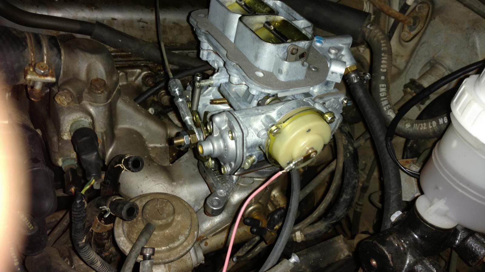

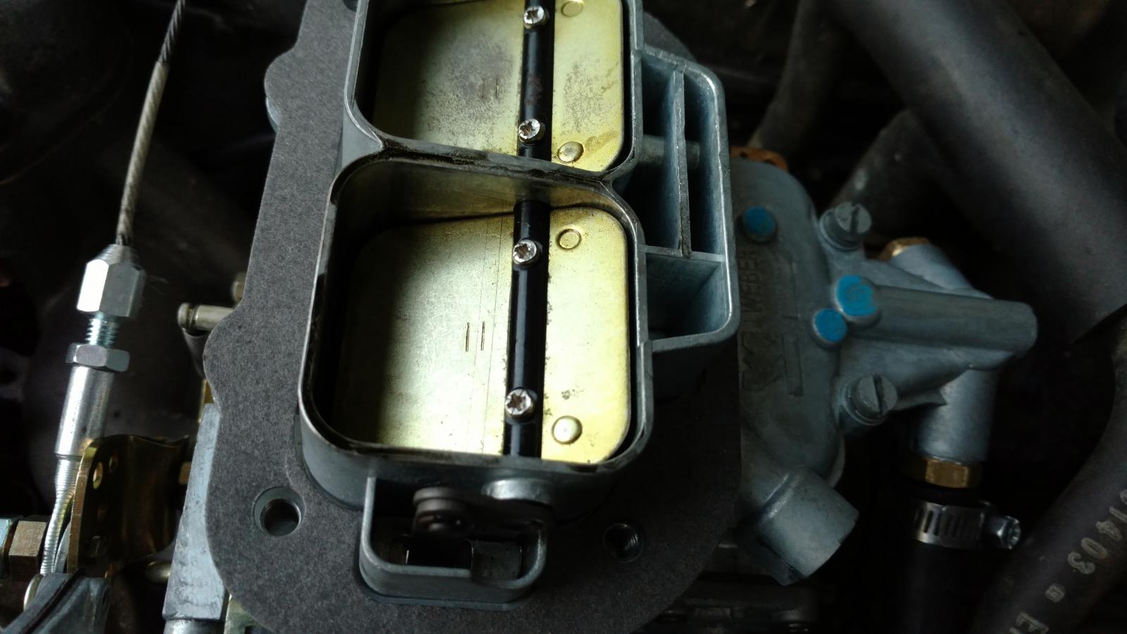

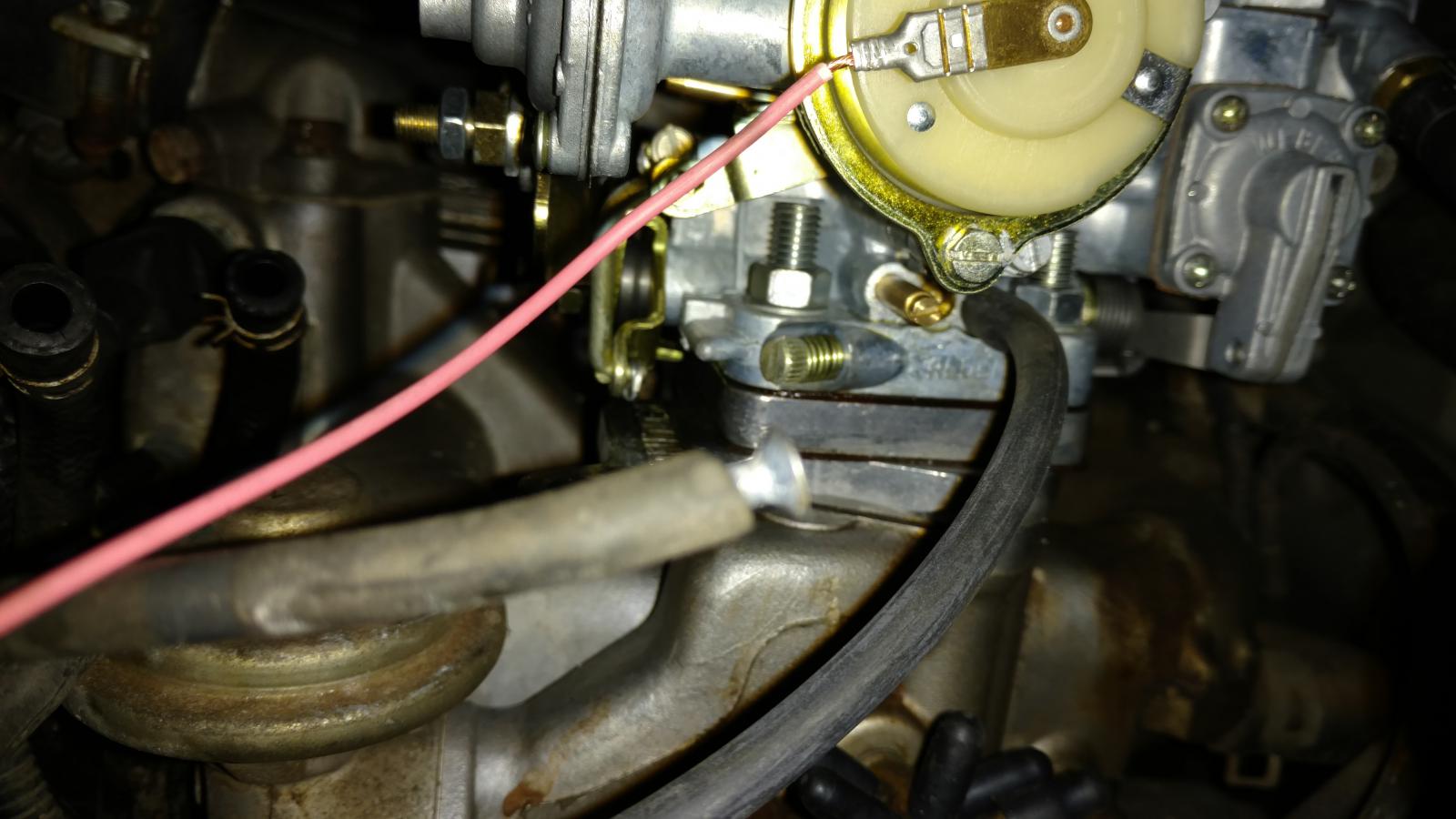

    I got a redline weber carb kit from pierce manifolds. I got it about 3 mos ago and just now had time to work on it, however, browsing through this MB and all that I can find I don't understand why the truck won't start now that its all installed. I have included some pics that I took. The one of the closed choke at the throat is to show the half-burnt gas residue accumulated after trying to start the truck
    Carb is definitely getting fuel, I installed an elec. Fuel pump and everything is good there
    When I go to start it (so I can set the carb.) It acts like it wants to catch, backfires, then wont even try to catch until I wait a few and cycle it again. Any input?

    So I finally got to mess with the truck and started looking over the eng and thought about it being advanced too much as suggested, being that it can be very likely the previous owner did that so it would run with being flooded and choked. Anyways I look at the dizzy and immediately noticed that it is cranked as far as it will go to the right
    Think this could be it? Lol. Hopefully

    sounds like a massive air leak - pull the carb, take off the adaptor plates, and then reassemble them using gasket sealer, then the carb.

    Hey, do y'all think that if I had overtightened the adapter plate bolts before installing the carb I would have this issue? Just a thought because I got to thinking about that and flipping through the install manual and remembered their bolt offset. Seems toe that if I had overtightened those bolts even just a lil bit, one if not both plates could be a little warped.
    What do y'all think?
    4,115
    that is a possibility, as well as stripping the holes on the manifold. It only needs to be tight - no need to torque it like a wheel.
