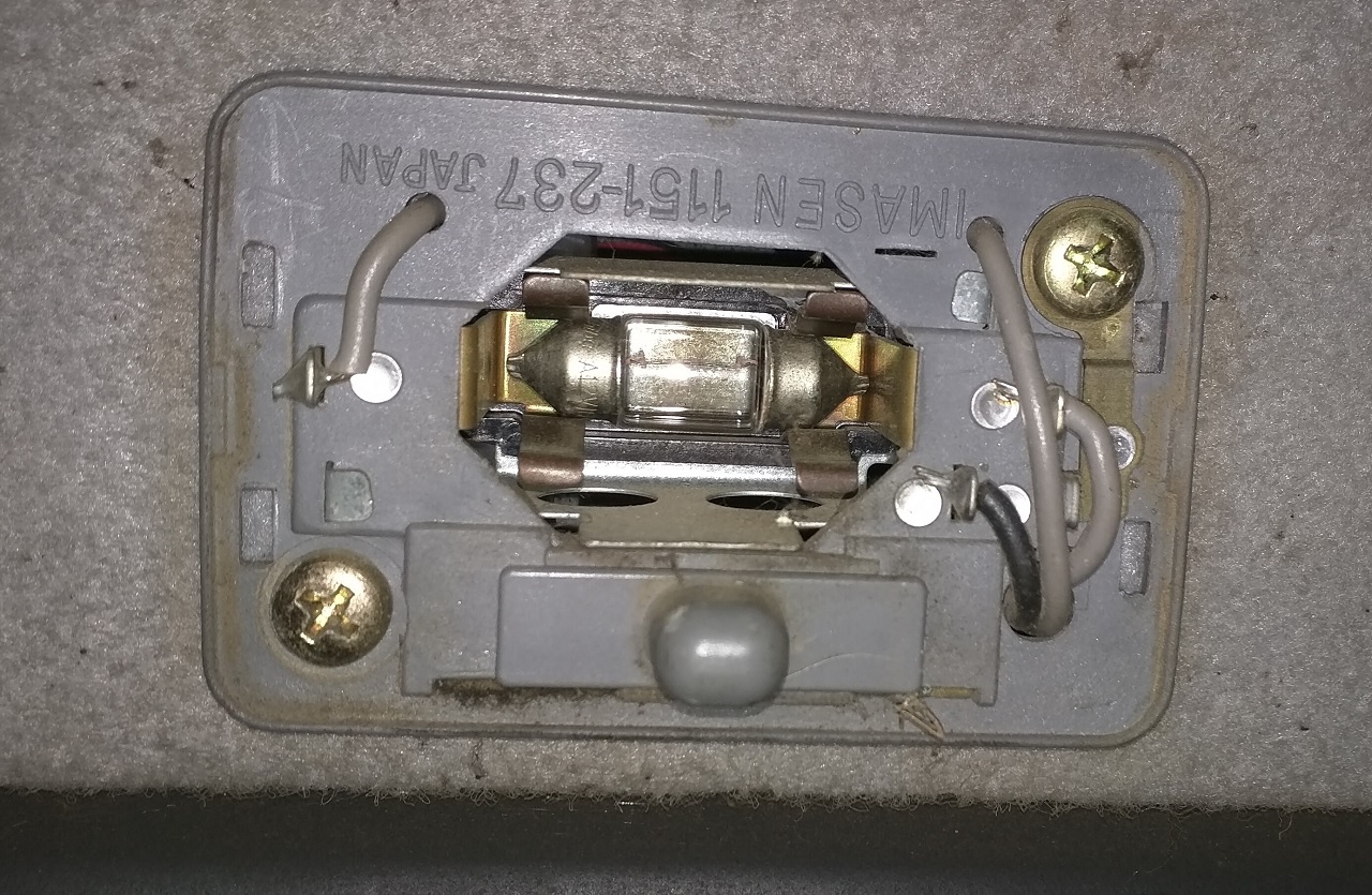

    Side note: I've been given mini bulbs that have tapered ends and never the bulbs with the flat ends
    as far as I know they all used the festoon type bulbs with the pointed/angle/sharp ends on then, at least every truck I've seen.
    like this: http://www.ebay.com/itm/Blue-6-SMD-L...JTFoSX&vxp=mtr

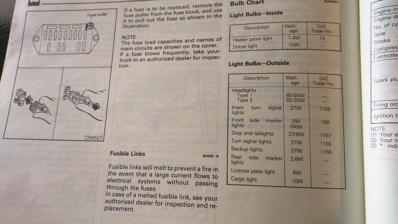

    Does this help? It's from my '92 short cab 4x4.
