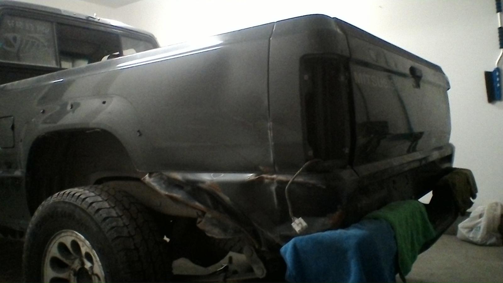

    I have been trying to find out if there is someone who makes a replacement panel i could weld in for the lower body panel on the rear of the bed. this piece here:

    Is this that piece??

    I hate to say it - but, nope. You would be looking for a corner bed panel (lower?) That site doesn't have anything in the way of body panels for the Mighty Max.

    You need part #8 in this diagram.
    http://www.oemautopartsandaccessorie...2e7c95ac4eb18/
    MB506425, $158.
    I'd try to salvage one off of a junked truck before I'd pay that much though.

    Still cheaper than buying another bed as far as i have found. But thank you for the link at least i know i can get it from somewhere. Can i get the trim for that side too from that site? Do the 2wd 2nd gen MM share the same bed?

    Hopefully the part is still available. As best I can tell, the 2WD bed is the same. You'd just need to drill holes for the fender flares. I may just replace my whole bed rather than trying to fix all the damage to it. It'd be easier than trying to hammer everything out and weld in the unfixable parts. We'll see when I get that far along in my project.
