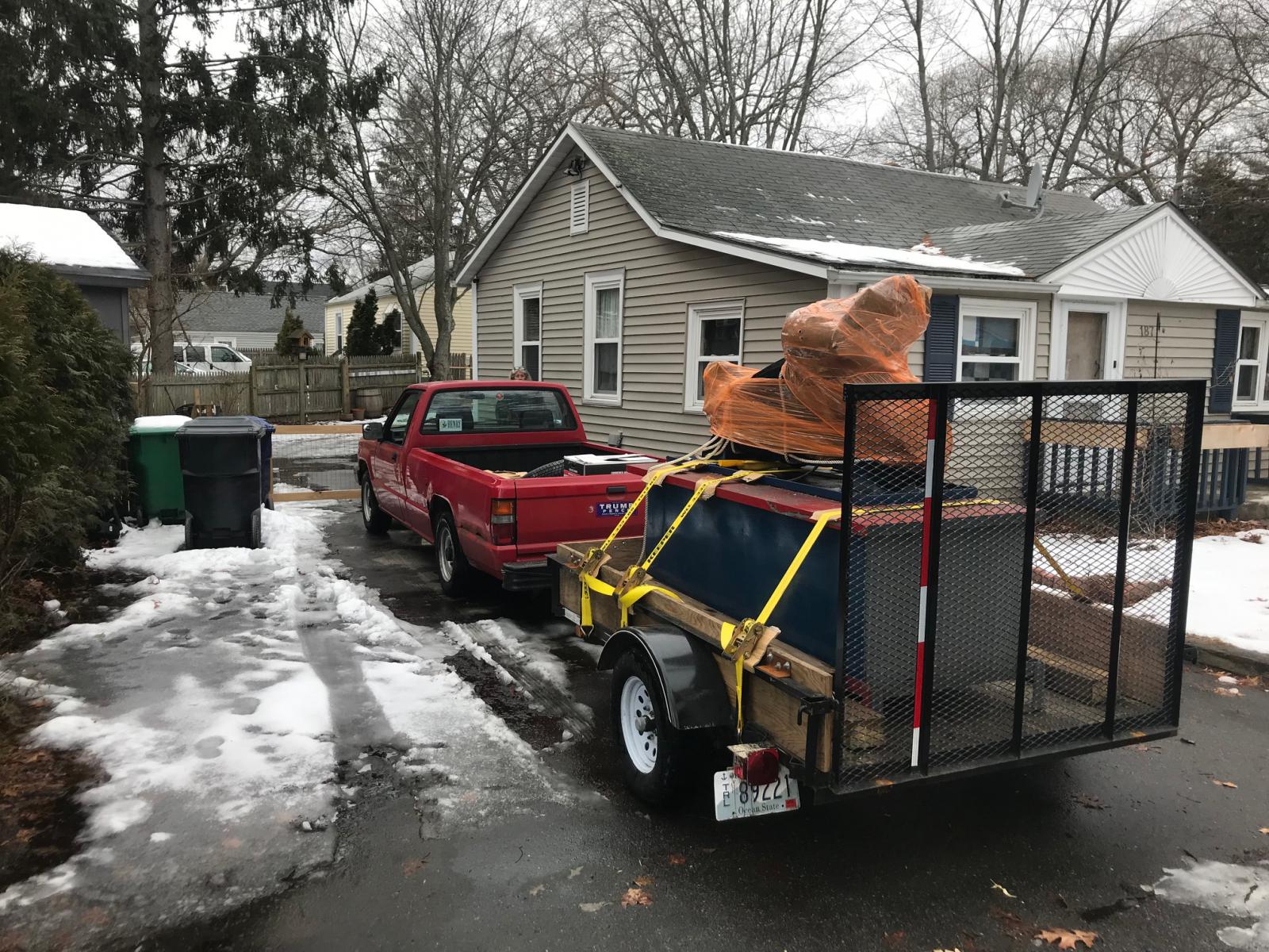

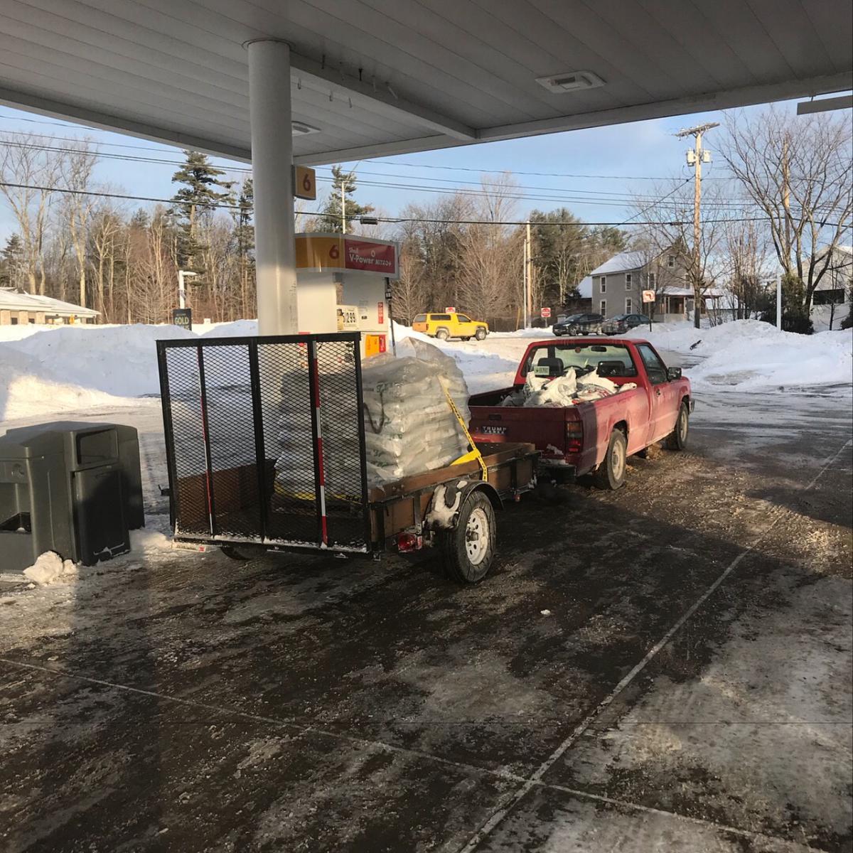

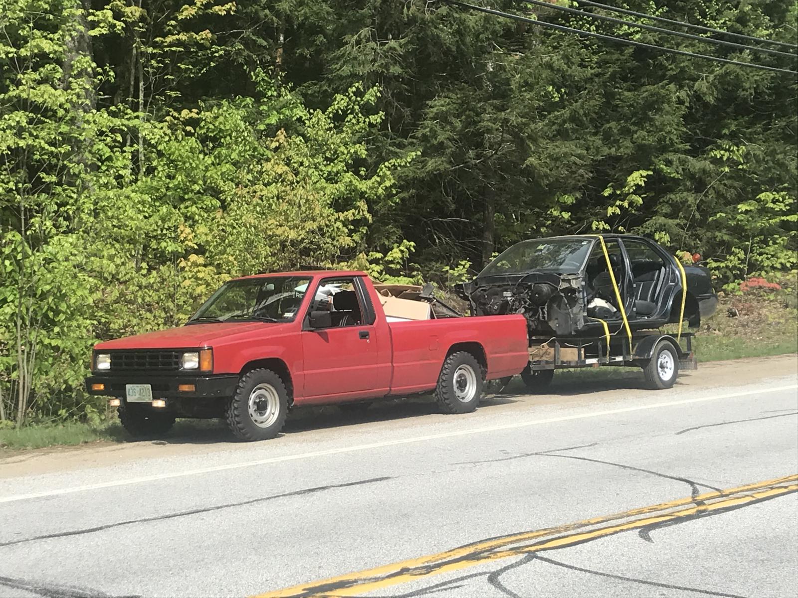

    I would ship one and drive the other. Thats a big load over a long distance. I've certainly abused the tow rating on my 2.6 auto. 3000lbs with no brakes on hilly terrain, but it was only 30 miles. I've towed 2000 to 2500 a couple hundred miles on the interstate. Truck liked 60 better than 55, put me up at 3200rpm where i had much more power and needed less throttle.
    the torque peak on a 2.6 is 3400 rpm, so that is why it pulls better there.
