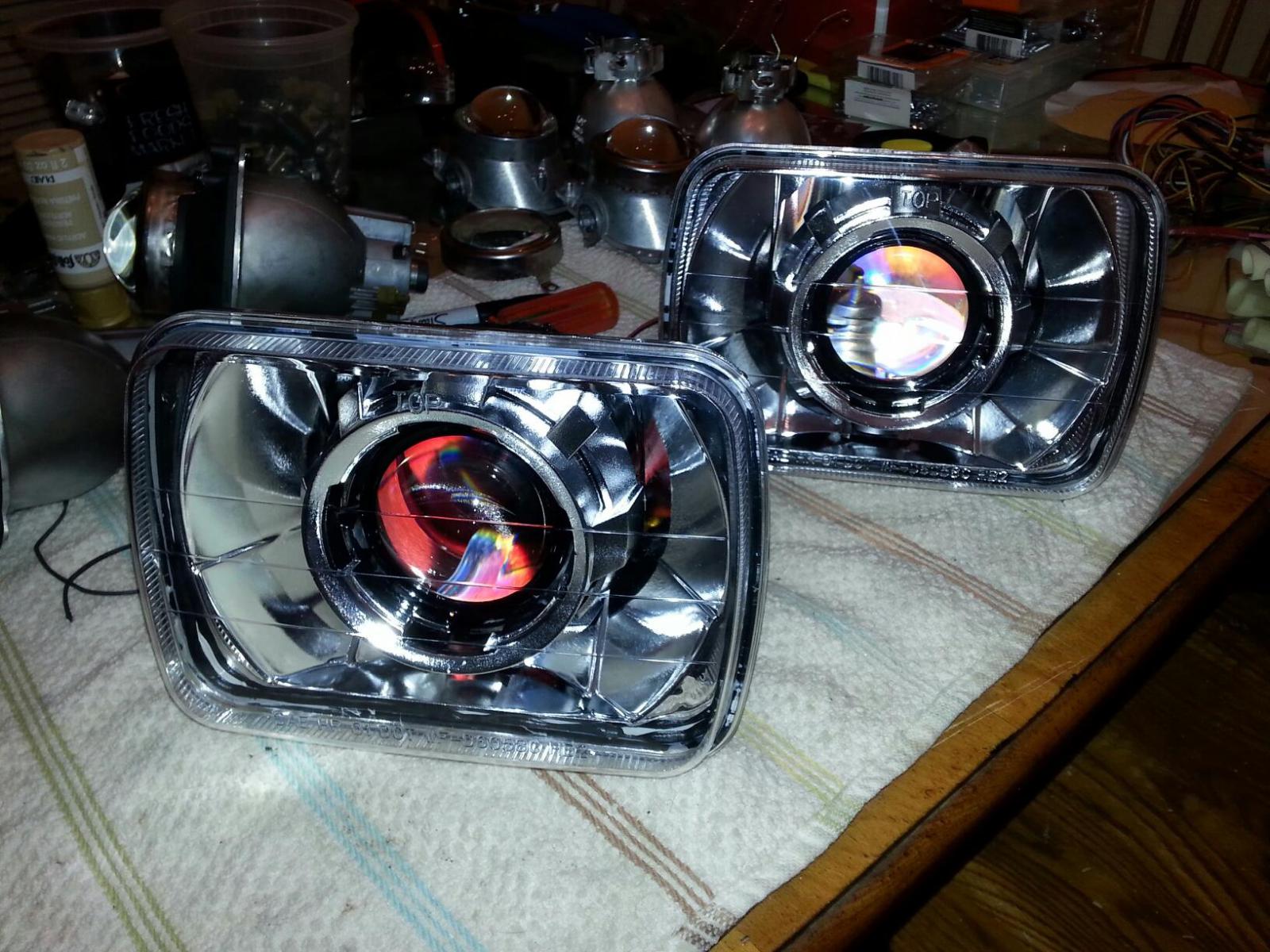

    Here are mine. Rx330 retrofit in some pilot housings. Projectors are modified with clear lenses and bi-xenon shields. With oem phillips ballasts and 4300k bulbs, the low beam output is some of the best I've ever seen.
