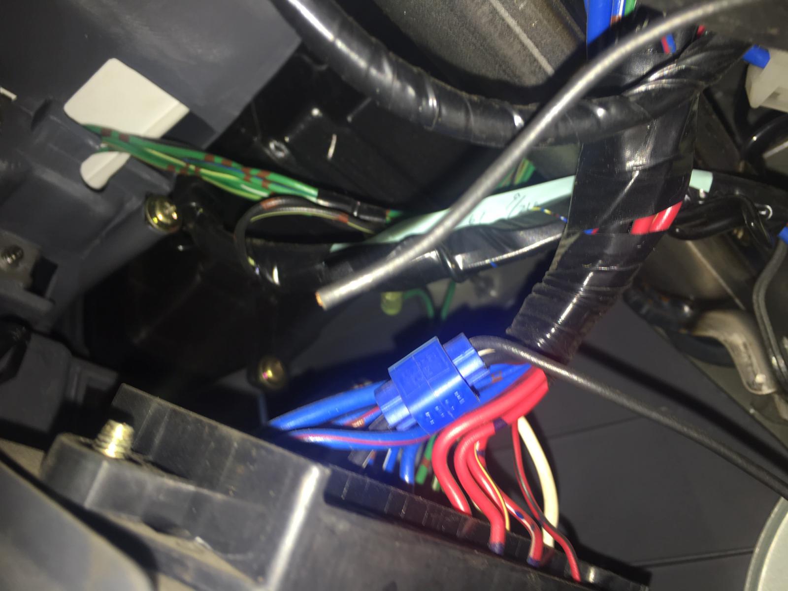

    And also, I found this black wire that seems to have been cut. It's coming out of that little blue plastic plug or connector or whatever that is, right behind the fuse box. You can see the cut tip of the black wire in the front of the picture, and the little blue plug where it comes out of, in the back.
    As far as I an tell all electrical things are working, so not sure what this might be. Any ideas?

    My truck does not have that black box that is in your photo, right above the buzzer, what is that? And also, I found this black wire that seems to have been cut. It's coming out of that little blue plastic plug or connector or whatever that is, right behind the fuse box. You can see the cut tip of the black wire in the front of the picture, and the little blue plug where it comes out of, in the back.
    Ignore the black box. It's an aftermarket relay I added for driving lights. I'd be very surprise if you had one in that location.
    The blue plastic thing is a splicing connector, the type to use to connect the green/white wire to the wire to the buzzer. Looks like a PO started and gave up or removed a modification they made by splicing into a wire from the fuse box. What color is the wire that passes through the splice connector? If it's black with a white stripe, that's hot with the key in the ON position. Tape the end of the black wire and secure it so it doesn't inadvertently ground out.
