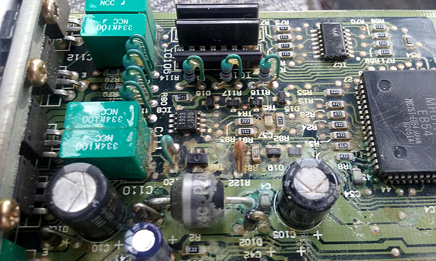

    03-08-2016
    22
    McMinnville TN
    1993 Mitsubishi Mighty Max
    4G63
    Board
    (click image to enlarge)
    We have a manual on these ECU and how to repair them.
    http://www.mightyram50.net/vbulletin...ECMs-and-ECU-s
    I'm looking at that ECU board and it is a mess. Like it's been exposed to salt water...
