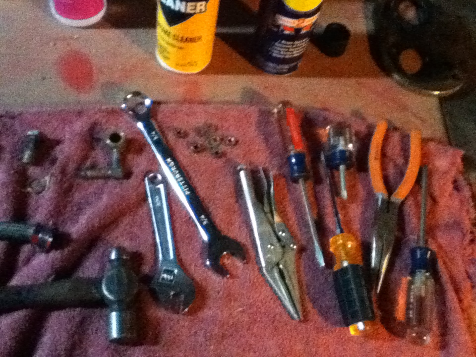

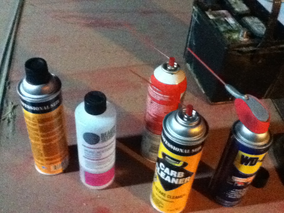

    The tools of torture:

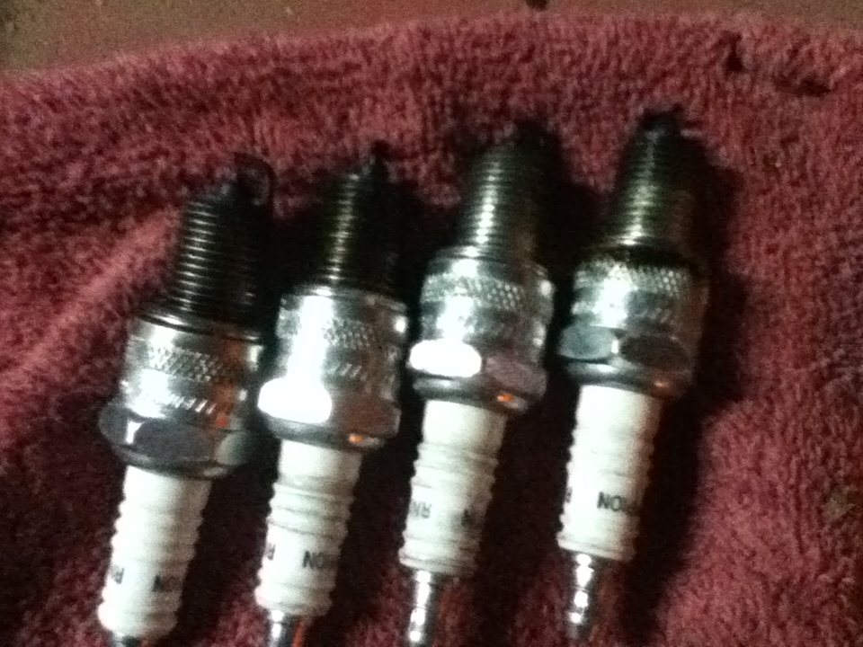

    The old spark plugs (changed yesterday)

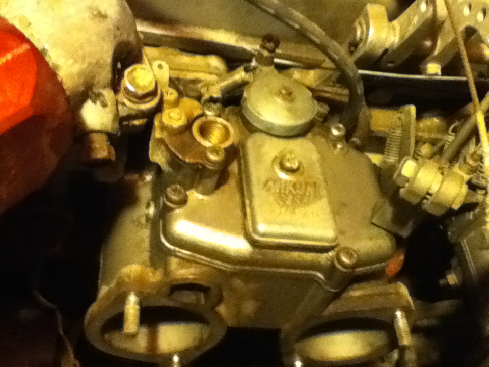

    Simple enough plan: take out six screws that hold the float cover down, check the insides.

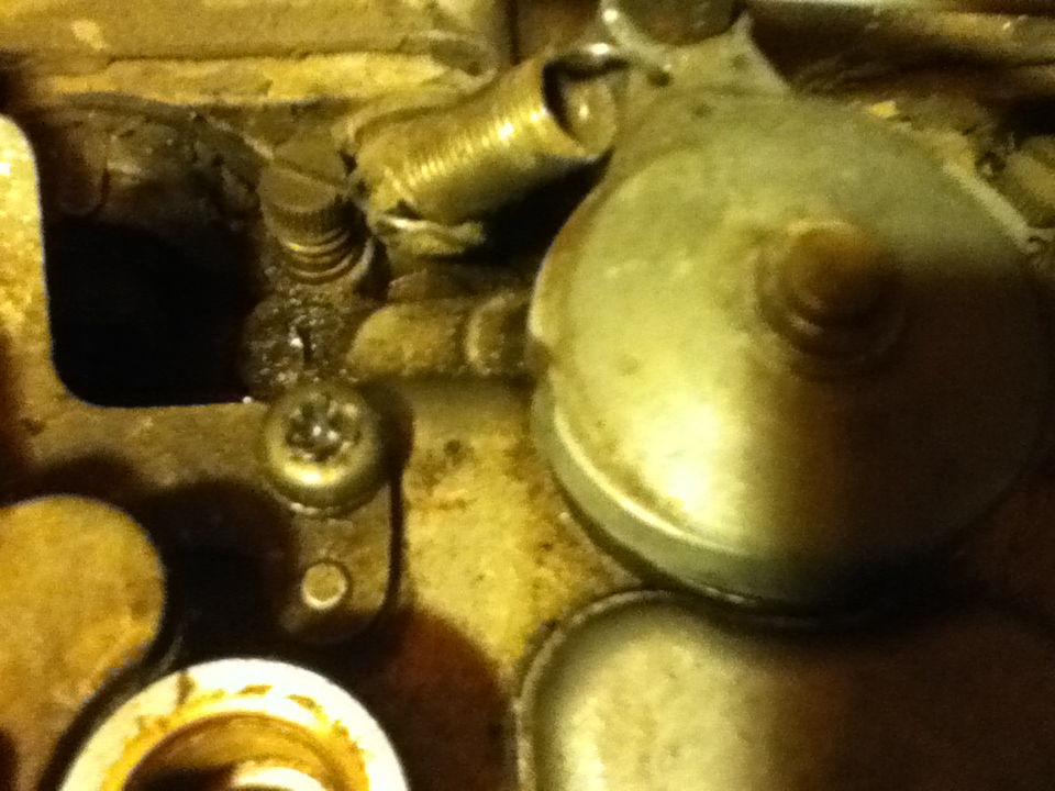

    Wrong! Ended up stripping out two screws and having to fight them out. (I'm going to kill whoever thought to use brass screws)

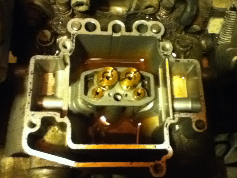

    End result is this open float chamber here, looks like it may be time for a rebuild and thorough cleaning.

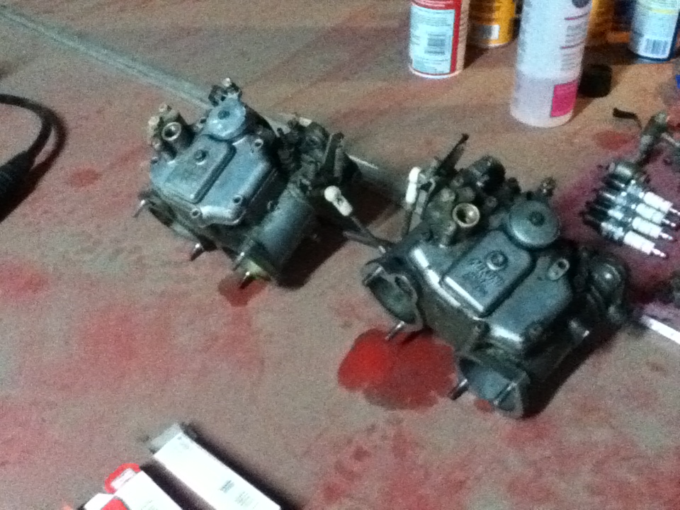

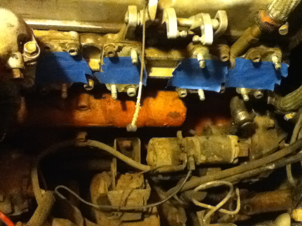

    Well both carbs are off and I cleaned up the intake manifold. The engine looks pretty naked without the carbs.

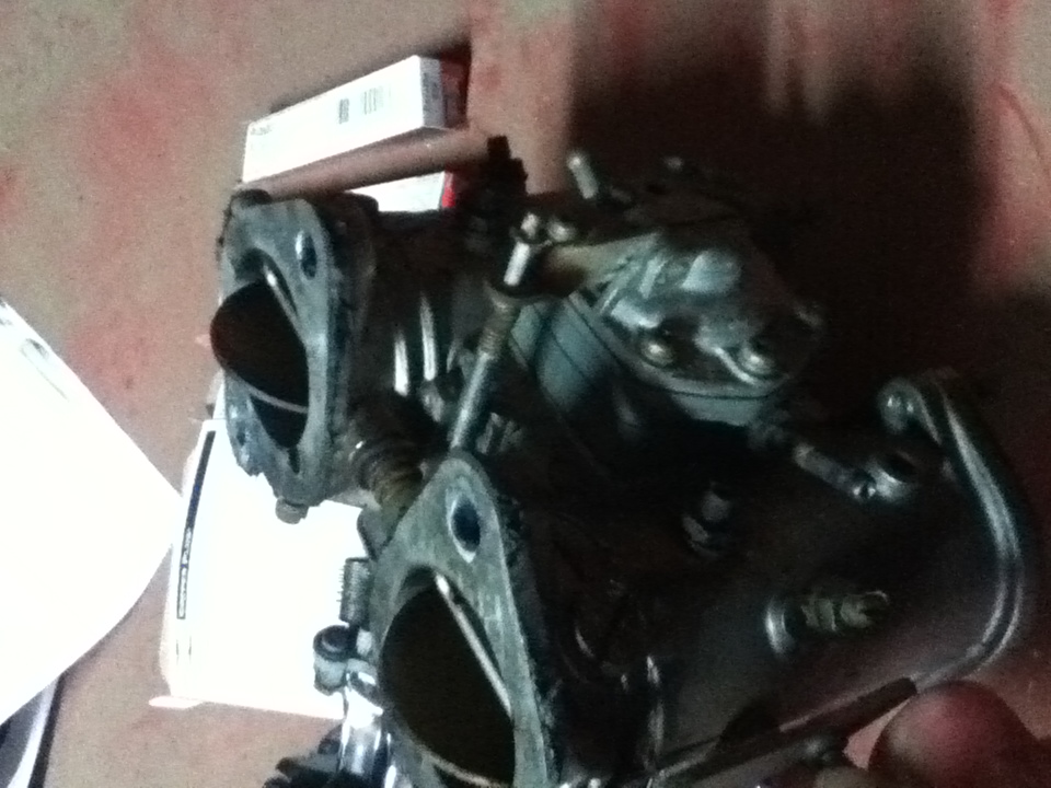

    The Legendary Mikuni PHH carbs, now leaking gas all over my '64:
    In this picture you can see how the accelerator pump doesn't budge even at full throttle:
    There is no real room in our garage for me to work on the truck, so I often find myself standing on the bull bars to work on the passenger side of the engine bay:

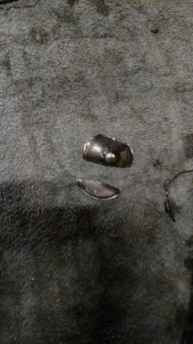

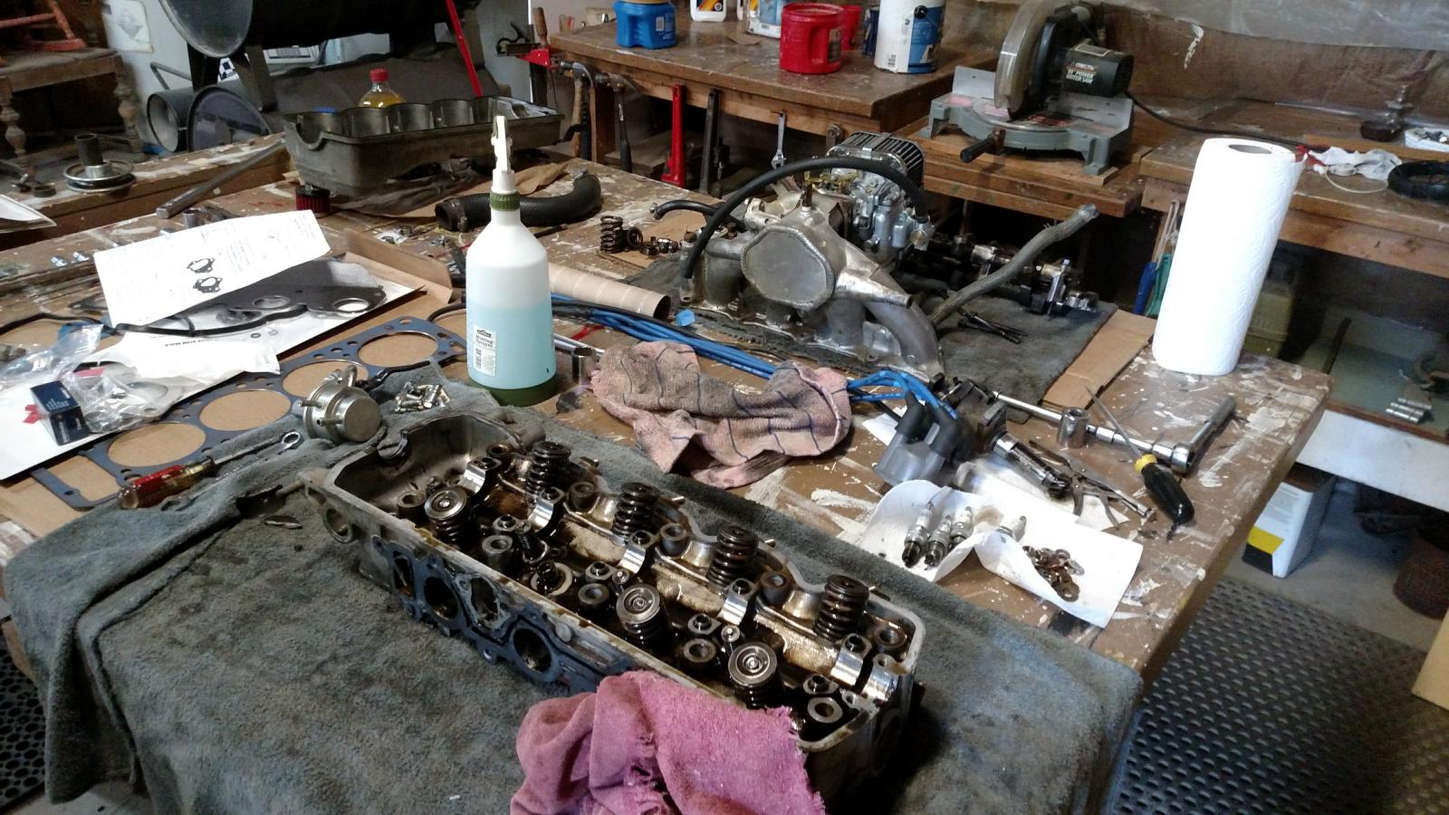

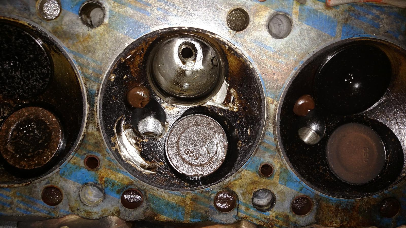

    Well, I suppose instead of slacking off I should upload some photos for you guys. I got my damaged engine apart to see how bad things really were, short answer, bad.
    IMG_20170803_192305723.jpgHere's the valve.

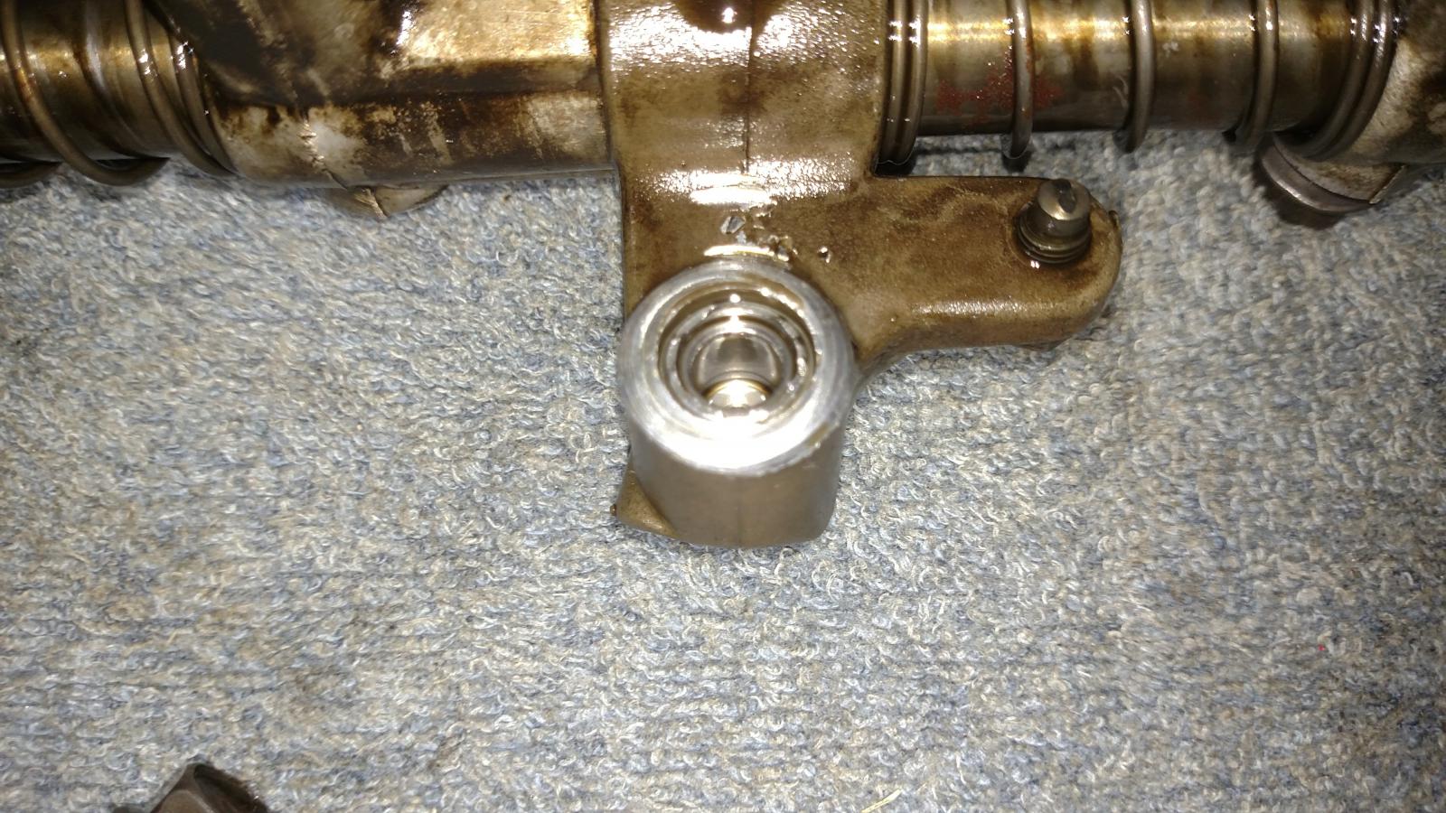

    IMG_20170803_192244276.jpgThe lifter that caused all of this.
    IMG_20170803_192218135.jpgIt looks like the valve struck twice before shattering.
    IMG_20170803_192200378.jpgEverything layed out on my work bench.

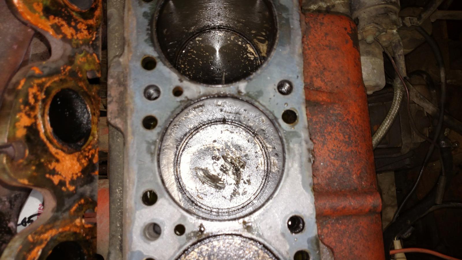

    IMG_20170803_192135681.jpgThe piston damage.

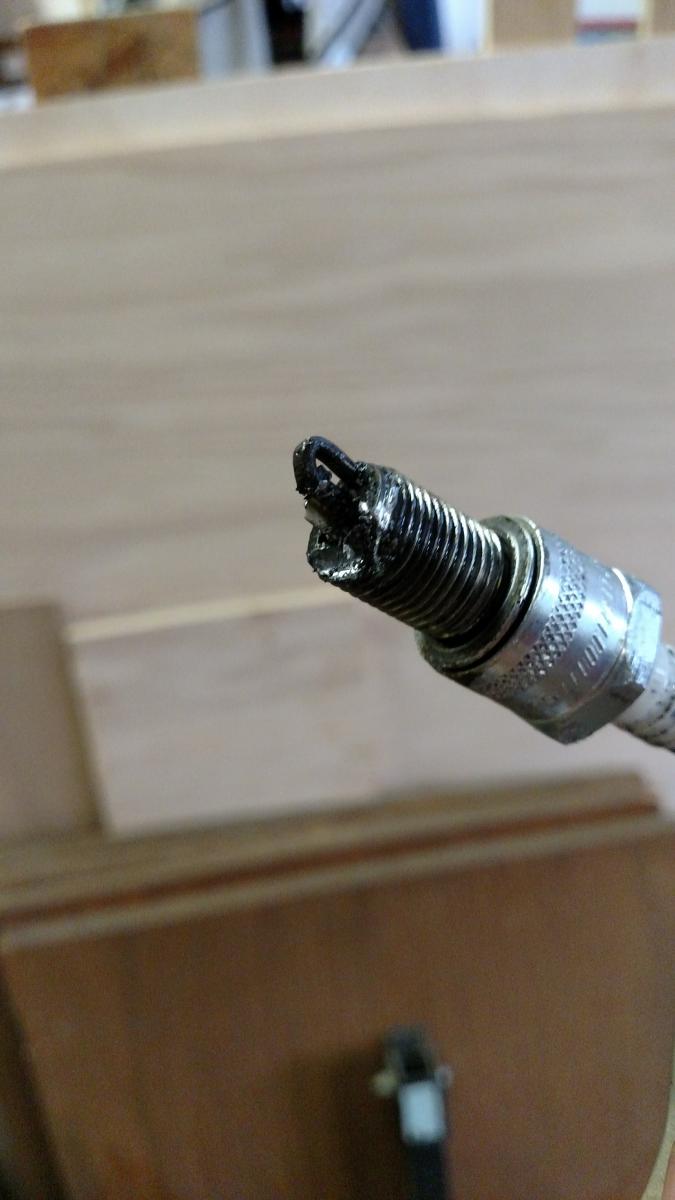

    IMG_20170802_185352758.jpgMy mangled spark-plug.
    IMG_20170803_192130661.jpgMy engine bay looks so empty.
    I'll have more pictures when I get the engine out. If anyone wants the damaged head let me know, if not, I'll scrap it.
    Yup, that head is toast. Didn't do the piston any favors either. It would need welding, a new valve seat and a new guide pressed in. Would be cheaper to get another head in the long run.

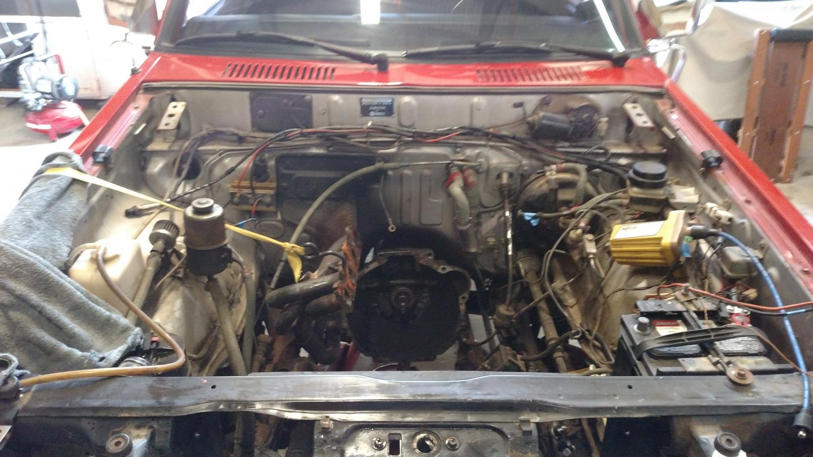

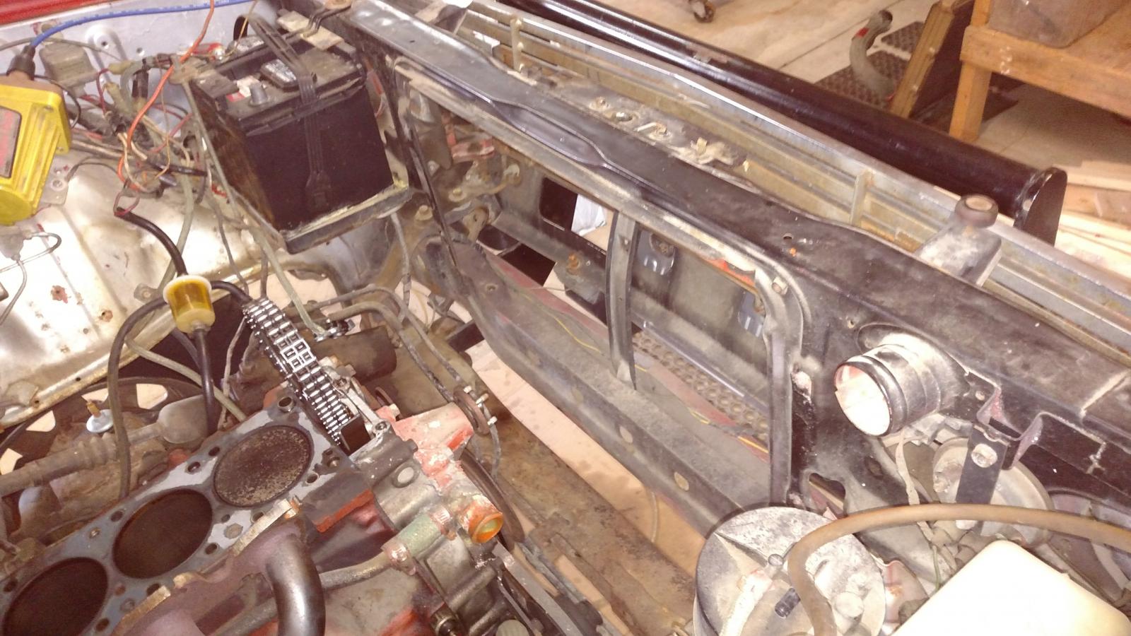

    1985 Dodge Power Ram 50

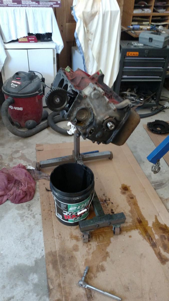

    The engine is out fellas, took a day of work, a lot of hammering and wrenching, but its on the stand ready for a rebuild.
    Radiator Came out first.
    Engine on a stand, draining fluids.
    Empty Engine bay, needs washed good,

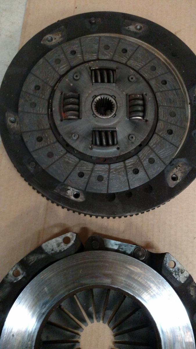

    Think I'll replace the clutch while its out.
