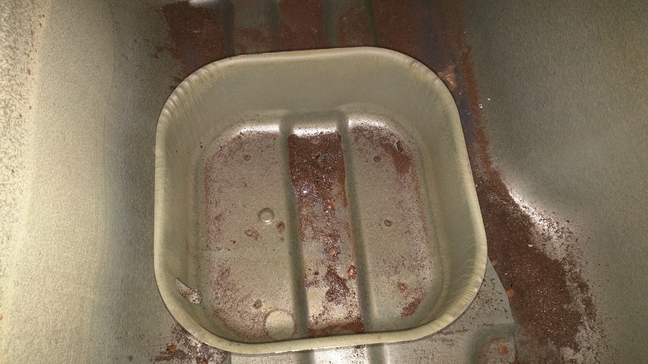

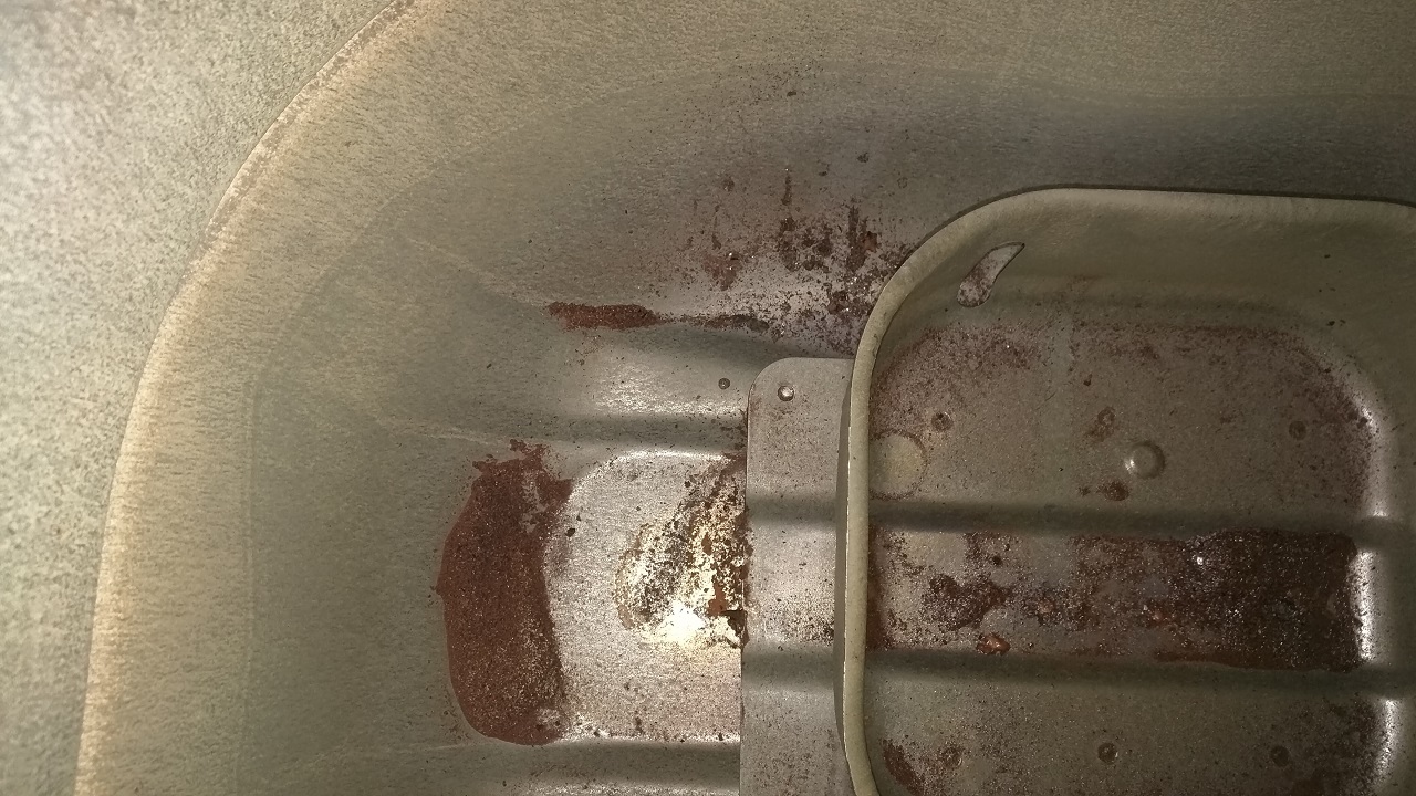

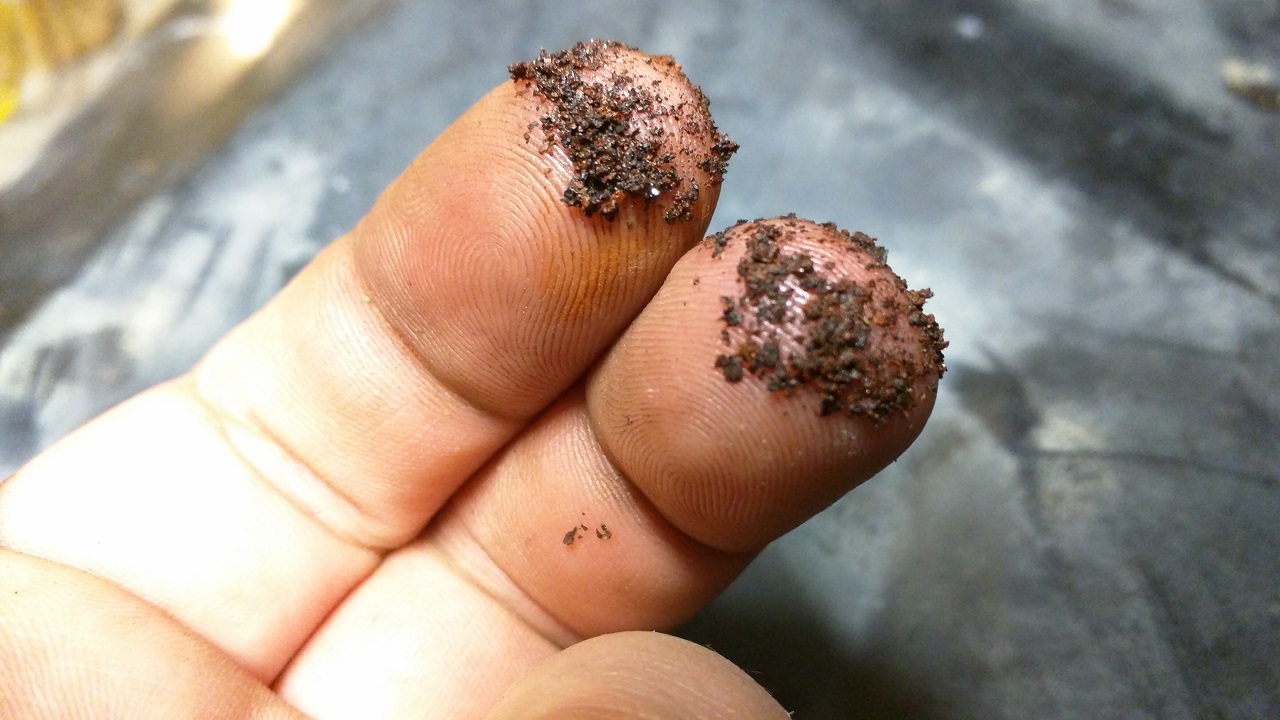

    I'm posting these in the hopes they'll help someone in the future, and also to serve as 'before' pics while I'm waiting for my POR 15 kit. The little silver stud in the first pic is the drain bolt closer to the rear of the truck.
    The little piles of rust are just that...loose crud. I dragged my fingers through them and the stuff came loose with no effort at all. Some moderately high pressure water would knock most of it out. It looks like the rust holes in my tank are underneath the square tray where the fuel pump sits. I'll have to make sure to blow the crud out from there, and spend some extra time circulating sealant in that area.

    Interesting how clean your tank looks. Even better than mine. I can't see how the lower submerged area could rust out being that there is no way for it to oxidize. I determined that virtually all my rust came from the upper 1/3 of my tank where air was present.

    Looks like you been making Folgers coffee in that tank. Where you get your gas at? If you can find a busy gas station, that may help with garbage in tank. You said rust also, got anywhere selling non-ethanol fuel? Ethanol will accumulate water moisture if left in tank for over a month or two.

    I haven't even put 2 miles on the truck since I bought it. That was the residue in the tank when it got to me. My original plan was to do the bare minimum in maintenance to get it past a MO safety inspection and then gradually work on the rest. But then I found out the fuel tank was leaking like a sieve once I scrubbed off the paint and poor patch work. So a lot of my maintenance stuff got moved up.

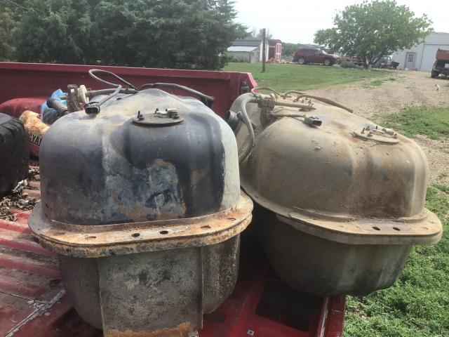

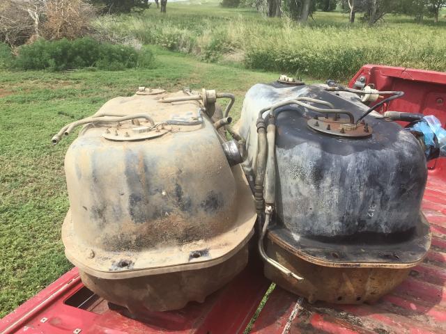

    FYI a 92 D50 2WD tank will fit a 90 4WD sport but you will lose some capacity. The dusty tank is sitting on a 2X6 but the hookup is identical.
