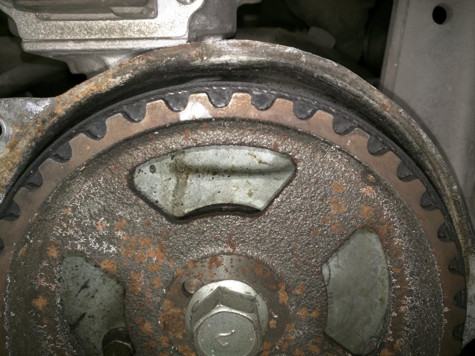

    Ok, so changed the spark plugs and that didn't make any difference, climbed under the truck and noticed the fuel filter was in the wrong direction.... stupid people man... so i took it out and did my best to clean it out with some brake cleaner and blew some air threw it and it doesn't seem clogged. Put it back in in the correct orientation and with high hopes tried to start it and.... nope same issue. so far here is what i have checked:
    Timing
    Fuel
    Fuel Pump
    Fuel Filter
    Spark Plugs
    Camshaft Position Sensor
    Replaced Capacitors on ECU
    Cap and Rotor
    Ignition Coil
    Distributor is in the correct direction at TDC
    What happens when i try to start it:
    Press Clutch
    Turn key
    Immediately hear a relay click on the passenger side
    Turn key to the Start position
    Immediately hear the relay click again
    Truck turns over several times
    Stumbles
    Stumbles
    Dies
    Only things i can think of that i have not checked:
    Compression
    Swapping ECU for a good one
    Any other advice/ideas???

    I was thinking, when your looking at the distributor while the engine is at TDC. should the rotor be on its way past #1 or like it just started the spark? I made a picture showing what I'm saying, Red is where its currently touching the cap at TDC:
  22. #47
    10-22-2015
    532
    Nevada
    Which way is the distributors direction? It's either advanced or full retard. Pun intended.
  23. #48
    02-22-2016
    221
    Phoenix, AZ
    1986 Dodge D-50
    Well if your referring to the direction of the adjustment bolt for the distributor, i have it set smack dab in the middle right now.
