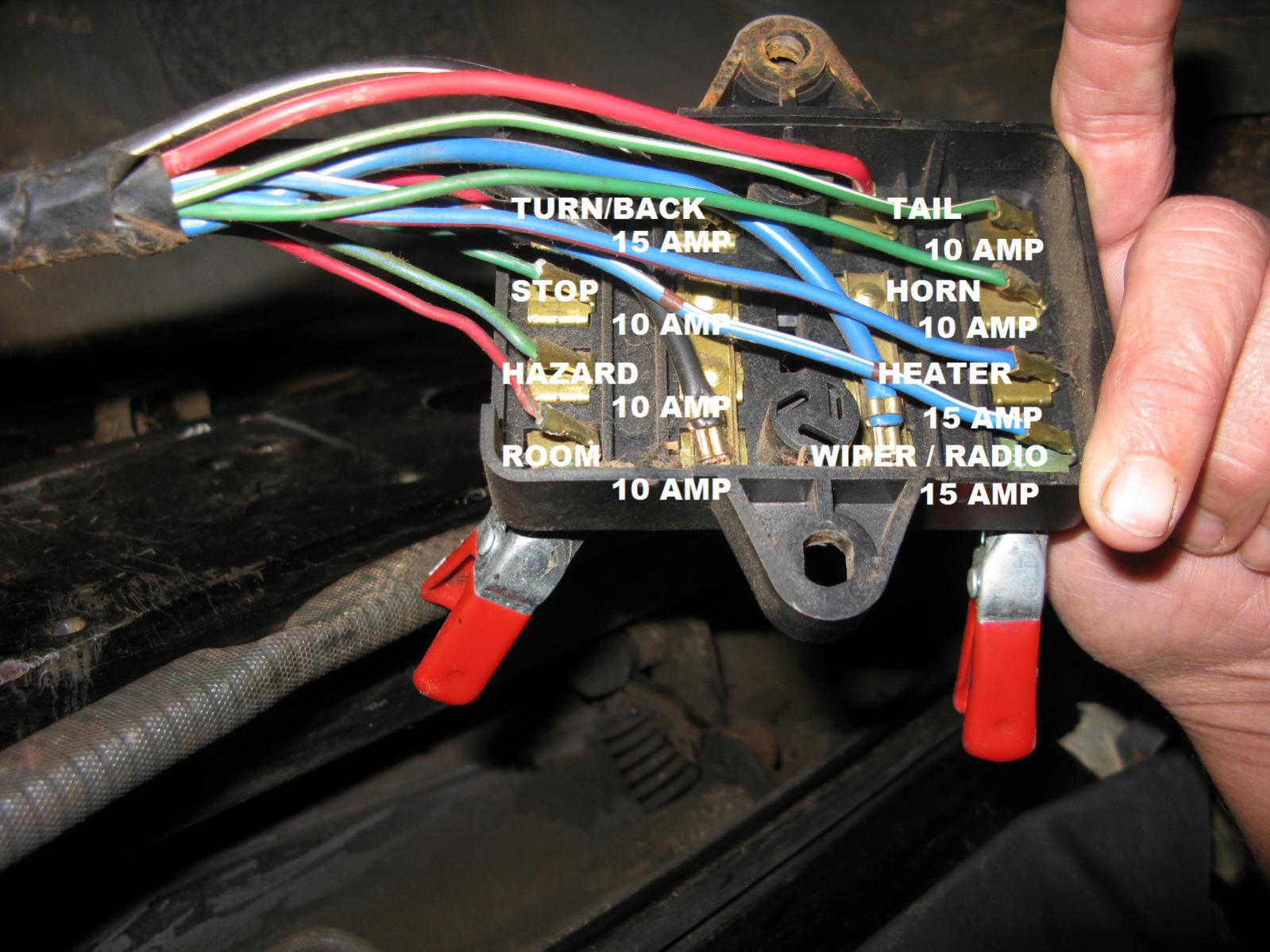

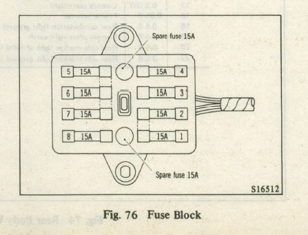

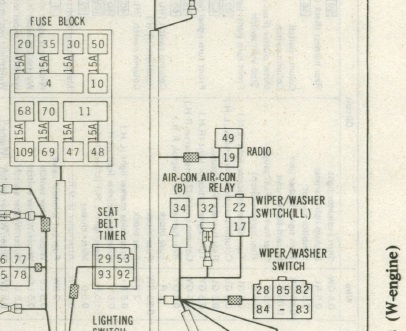

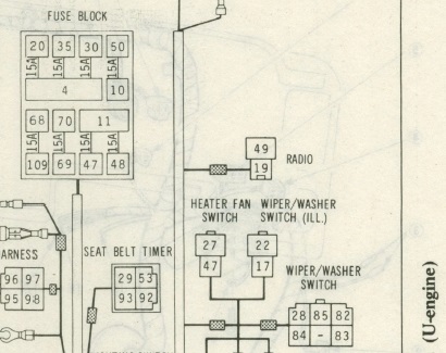

    Also struggling to find out exactly what the fuses are for in the truck fuse box, the cover that ragtime has says one thing:
    the factory manual says another thing:
    and the actual fuses in the box in the truck right now say something else (different amps), so I'm going through an trying to figure out the labels for what the fuses are actually for, not sure if I'm right or not yet, lol. When it stops raining for a few minutes I'll have to go out and pull them one by one and see what shuts off or won't turn on. I'm GUESSING that the buss bars connect things that are either constant on, acc only on, ignition only on, unsure - still learning but this is my current guess for today:
    The fuse box diagram in the factory manual doesn't match what's in my truck either, neither the W or U engines:
    The buss bars going across the fuses in the back don't even match the buss bars in my fuse box,
    and the factory manual says ALL 15AMP!
    At this point I'm so freakin confused I don't know if it's the U or W engine in the darn truck, omg. And all the pics I have of the engine are from before when it was covered in oil where the stamp is (or where I remember it is).
    I'm thinking if my battery is low & truck won't start then I'd like the voltmeter to give a reading even without the engine running so that's why the key in the acc and/or on position is needed.
    The wire rating suggested for the voltmeter (18-20 awg) and the 7.5amp fuse requirement for it (suggested requirement guideline, not sure). Problem is, there's only 10 amp and 15 amp fuses in the fusebox I have now... and pretty sure there was also a 20amp -ugh!- So I'm thinking to look up what amp requirements are for other gauges and add in empty spots for future gauges at 7.5 amps each.
    The factory manual suggests using the cigarette lighter circuit as an option, and seems to be the place with the highest capacity for add-ons:
    I pulled off the dash & found the blue wire connecting to the back of the lighter --- but presuming that's only 'hot', where the hell is the ground for it? Dumb question I'm still trying to figure out. The notes in the book say 'interlocked with ACC' so I'm hoping that means whatever is hooked up through that cigarette lighter wiring will work both with the key in the Accessory position and the ON/running position, too. I don't have a lighter in the truck so will have to buy one to test out how it works or if it does.
    If it IS fuse #4 in the fuse block, for wiper/radio/cigarette lighter, and it's only got a 15amp fuse in there... would I need to put in a higher rated fuse into that #4 spot - even though the book says up to 120W... notice how in that last pic the book shows max amps for the radio and air conditioner terminals but shows max Watts for the cigarette lighter?!?! Now I've got to figure out what the math is for amps and watts. Ugh. Still learning a lot wow have 9 more days to figure it out or until a good sunshiney day, don't want to get electrocuted in the rain of course.

    oooooh I could just run up and hug you !!! Thanks so much for the clues !!! 1600 people w/out power and I'm waiting my turn, lol, let it storm on I guess I'll just keep doing factory manual homework & watching vids.
    If there's anyone ever reading this in the future I'd like to point to this video guy to get started really getting how simple relays can be to understand http://www.youtube.com/watch?v=UAeKTlieYhw and then this guy who fidgets a bit more but gets the point across about switches & relays, too: http://www.youtube.com/watch?v=7vOVSst-SoY
    I think I'm ready to replicate the original fuse box itself and add on to it or make an extra one or 2, since I went back and read some of pennymans words about the busses? basically the linked fuses, and am slowly 'getting' it, it's just finishing up figuring what wires/to what/how many amps for that . Seriously appreciate the wire colors thank you so much I'll go see if the manuals specify colors for the other wires, too, now that you mention it I think they did! Happy to know for sure!
    Started working on drawing out where wires, fuses, and grounds should be/can go tonight - so much fun to get closer to opening all sorts of possibilities! Got the voltmeter gauge as priority #1, tachometer would be awesome * really miss seeing that a lot * even though it's an automatic , an actual water temp gauge and actual oil pressure gauge would be incredible to have also. But I still don't know where to add 1 gauge in the cab roflmao, nevermind 3 or 4 or 5, so making myself learn how it should/could work first. (I'll be stalking everyones dash pics for days haha!!!)
    Blue, I like blue lights best. I'll have to see about ordering blue for everything eventually I am sick of 16 years of amber lights, lol. My dad convinced me to keep my other car 100% stock so I'm going to have tons of fun customizing the heck out of this truck once it gets mechanically perfect.
    I'll update my little old shameful fusebox pic as soon as I finish changing the labels to what they actually are in case it helps someone clueless like me in the future

    I ordered a bunch of T10 blue and T10 white LED's for my dash + a blue illuminated lighter socket for my truck today. Whole lot set me back just over $5 US and NO POSTAGE FEES!!?! My mechless head unit has a blue display so it should tie in nicely. The dull green is boring, the warning/display lights are due for a freshen up now I've given everything an updated finish with carbon fibre film and if it looks kinda cheap and crappy its only cost me a few bucks so no big loss. I hope they LED's are dimmable but if not, I'll live with it.
    Amazing !!! I sure hope you post pics up after install! The only thing I've seen about switching over to the LEDs is that there's some special little extra unit required for them because they draw so little amps compared to the regular bulbs... it was long & little & bright yellow and wasn't supposed to be screwed on to where there's paint and something else on the warning sticker. Not trying to be cryptic, I think I saw it in a post on this forum.
    I finally found what my fuse box wires go to, from Brad's wiki here: http://www.mightyram50.net/vbulletin...ctrical+System it's on the page that looks like this:
    so happy finally found one that matches the buss bar and colors and everything Sort of upset they didn't explain it like that in the factory manual but going back to that book anyway to find the right amps for those fuses. Should be super easy after that's sorted.
