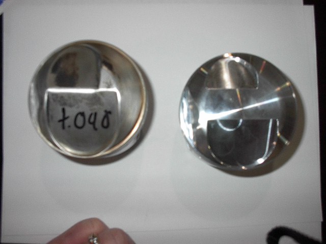

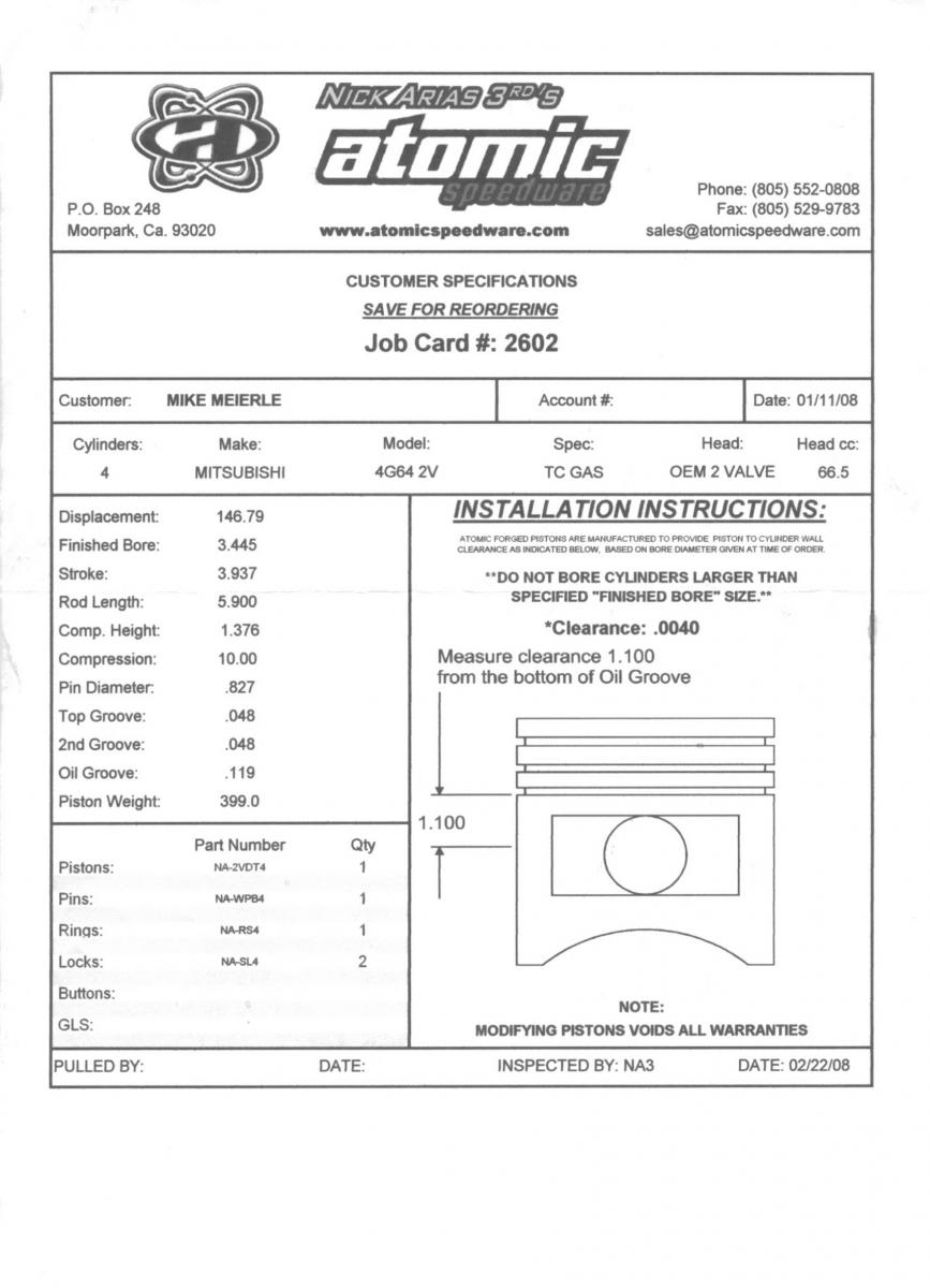

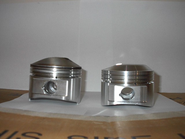

    here are the specs of my turbo pistons.
    They are from Nick Arias III, Yes, that Arias.
    The one on the left is a 14:1 Normally aspirated, the one on the right is the 10:1 Turbo piston from the job card
    Top with valve reliefs
