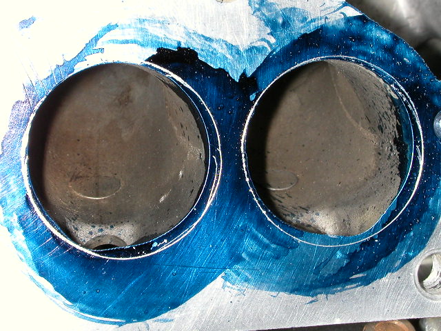

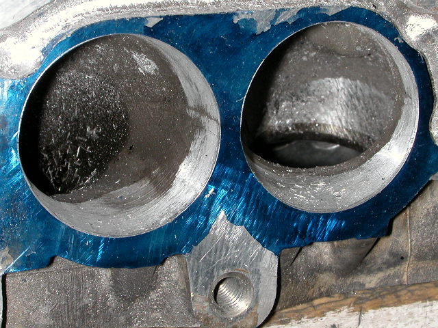

    Great advice guys thanks I'm looking in to the port n polish I'm trying to get it figured out 14561773660071485122524.jpg
    Quote Originally Posted by Deamonxr1 View Post
    Rules are simple for porting and polishing. No sharp edges in the ports or the combustion chambers, no rough gallery walls, make each gallery and port look the same inside, don't oversize the ports when matching the inlet side, don't increase the exhaust port sizes at all. There are some specific rules depending on what kind of engine you're building and basic principles apply to every engine. Every guy has a different approach to porting. If you're taking the head in for reconditioning now is the time to tackle your ports. If you do it after its been through a shop there's always a risk you could damage a valve seat or a freshly machined face. These heads aren't bad when it comes to port sizes and alignment but the inside castings of the ports can be plain nasty...
