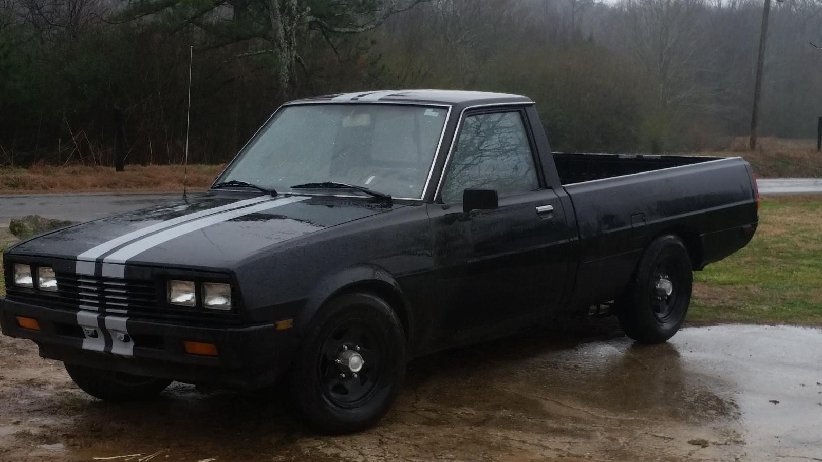

    I've got sunk in and bought a project. It's time for engine questions.1986 ram 50 Little 2.0l gen1 g63 power options without engine swap advice help all appreciated. Head swap options headers carb what works well I get lost in the forums looking at some of the beast builds thought just asking was easier not looking for super powers just a bit more pep once budget allows going to go all out but that's long time away. Got biltech lowering kit coming

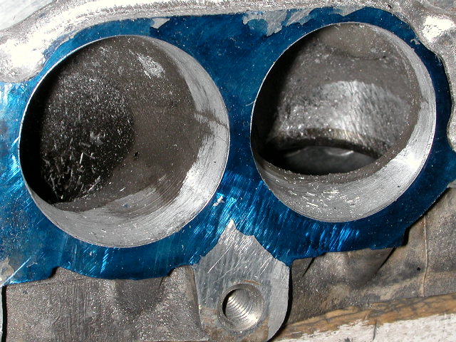

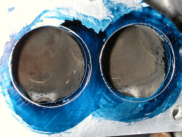

    Ditto on above....

    Rules are simple for porting and polishing. No sharp edges in the ports or the combustion chambers, no rough gallery walls, make each gallery and port look the same inside, don't oversize the ports when matching the inlet side, don't increase the exhaust port sizes at all. There are some specific rules depending on what kind of engine you're building and basic principles apply to every engine. Every guy has a different approach to porting. If you're taking the head in for reconditioning now is the time to tackle your ports. If you do it after its been through a shop there's always a risk you could damage a valve seat or a freshly machined face. These heads aren't bad when it comes to port sizes and alignment but the inside castings of the ports can be plain nasty...
