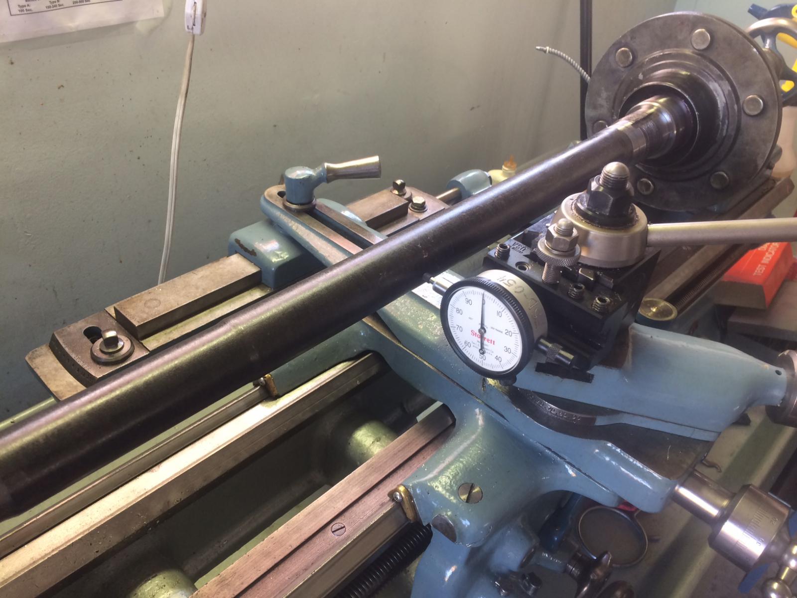

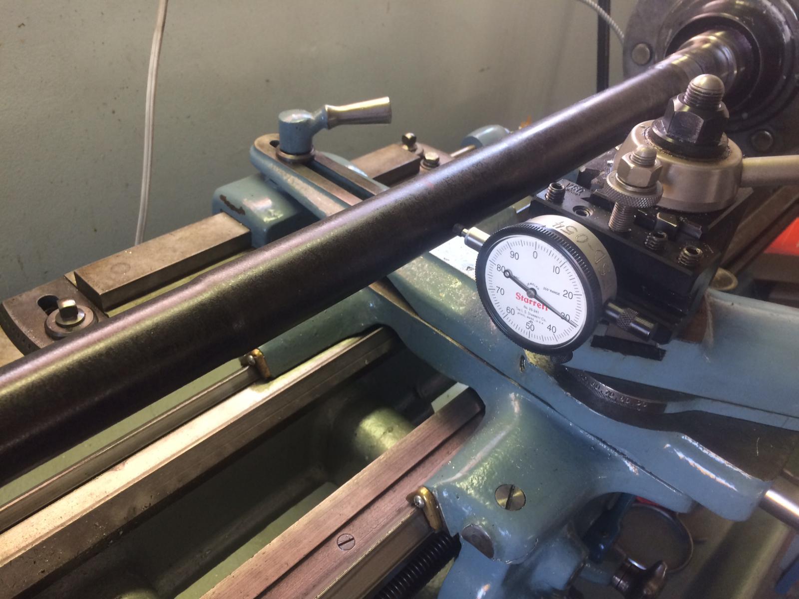

    Something is causing my drivers side rear brake to overheat and I
    can't figure it out. Everything is new but still troubleshooting.
    Book calls for .039 max. run out. I'm running at .030. Flange squareness .0024. I'm running at .002.
    I was suspecting the axle but I can eliminate as it is within tolerance.
    Any suggestions what is causing my rear L brake to run hot. The passenger side is fine.
    I tried completely backing off the adjuster. No go.
    The brake cylinder is new. It stops the drum when the brakes are applied and releases it when released. So that's a no go.
    I am stumped?

    I want to thank you for the post. I will investigate some of the possibilities.
    The long one is on the rear.
    There is no noise for the second.
    I did not use a safe tool.
    All the others I will investigate.
