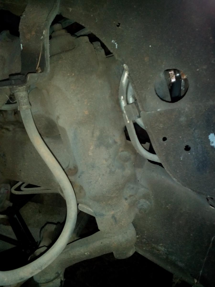

    ok, so these pics suck but if you look closely enough you can see they will not work because the mounting pattern is flipped. they both mount to the outside of the frame, everything else is identical except the mounting.
    this is the 95 2wd box
    this is the 87 4wd box
    it could easily be fabbed but probably not what you were looking to do.
    3,620
    OK so there both outboard. But one is front steer and the other is rear steer.
    Front steer = tie rods in front of the spindle center line.
    Rear steer = tie rods behind the spindle center line.

    12-13-2014
    122
    redding ca
    the 95 box is behind the wheel and the 87 is in front of the wheel. the mounting pattern is different also. the 4wd wont mount to the 2wd frame.
    2,798
    Ah, o.k. The pic doesn't make that entirely obvious on first glance. The 2WD steering set up must foul the 4WD transfer somehow...
    3,620
    The 4WD is in front because there is a drive line in the way. He needs to find the box from a 2WD or what ever he has now. Unless the pitman arms can be swapped. Then there is a chance the output shaft will be lower when put on the other truck.
