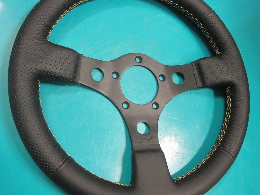

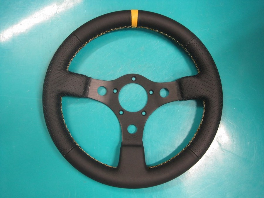

    New Steering Wheel

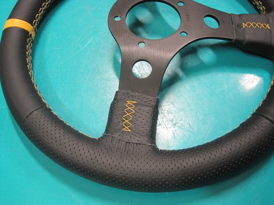

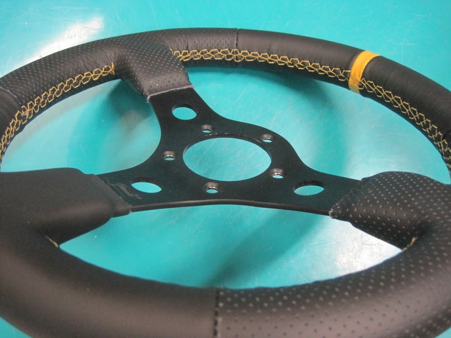

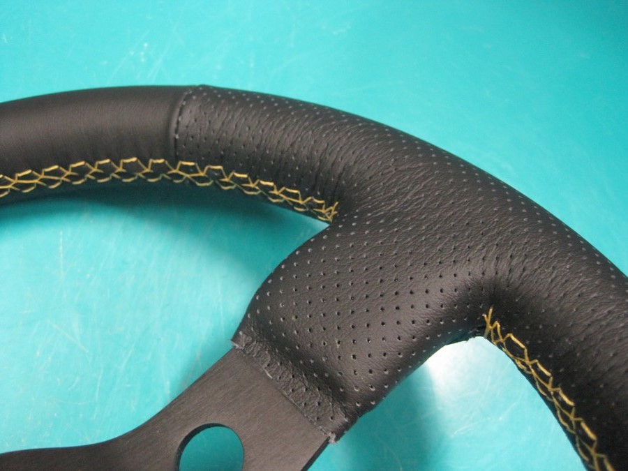

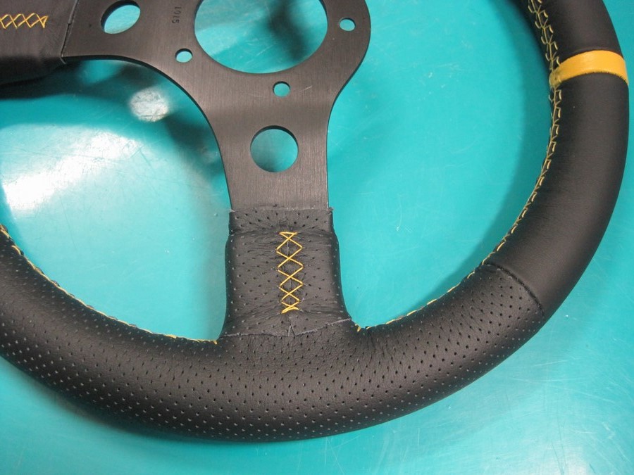

    The imitation suede one just had no grip.
    So, I had this Grant and sent it to get it recovered.
    Nice work. Is it leather or vinyl and how much did they charge you? I used to restitch wheels before by hand. It was getting hard finding anyone to supply leather scraps, haven't done one in years...

    $400 or so. It is all leather and I also wanted it a little thicker.

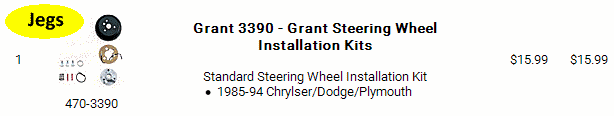

    Which adapter did you use? Getting ready to put a Grant on my truck. I have a 1st gen, another thread said kit #3390.

    3390 is the adaptor, you also need a hub that spaces the wheel away from the column for clearance for the turn signal stalk / wiper stalk on later trucks. I have that model wheel with the hub on Geronimo, and he is an 1980 - been on him since 1983. Wore out 2 copper horn rings on the adaptor - made new ones using a hole saw and a blank copper circuit board. Use spark plug boot silicone grease on the copper horn ring to prevent the copper from wearing from the contact rubbing when driving.
    Hey hutch nice wheel, but a little pricey?. I ordered the red suede leather one from Jegs that looked very similar to that and there was a long wait since Grant was behind schedule on them. So, I cancelled and made a re-order on another wheel.
    $97
    The above adapter comes with 2 black column housings for a large and small diameter column. It also comes with an extra horn button adapter plate for those old huge chrome horn buttons. The adapter was a bit tight when put onto splines of the steering shaft, so I imagine I will need a puller to remove it if I ever have to.

    Yes, but I had the Grant suede before. Great looking wheel, look at some other of my previous pictures.
    It had absolutely no grip. My hands would just slide on the wheel.
    I know it's pricey but it's custom ordered to my specs and uses real genuine leather. Everything these days are vinyl.
    If we bought one made with real leather we will pay a good amount of money.
    I kinda look at is a bargain.

    Ya, Grant did use a lot more leather in the day. I agree with you on the vinyl issue also. They are definitely making more with that stuff. The one thing I am not happy with on a vinyl wheel is that you can feel the seems where the mold was pieced together and poured. I will probably wrap the wheel with a soft leather cover when I locate one I like.
    Your wheel really looks well done though, I must say they did an excellent job. I hope it last for you.

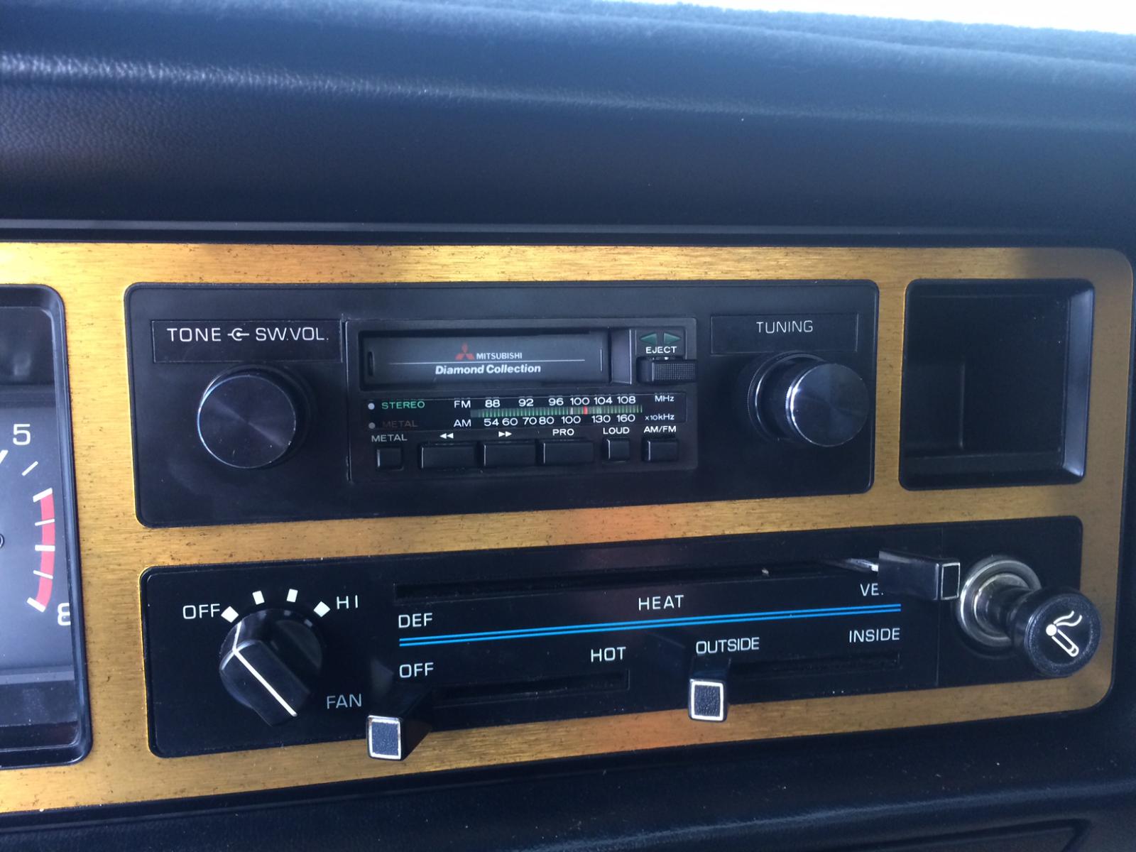

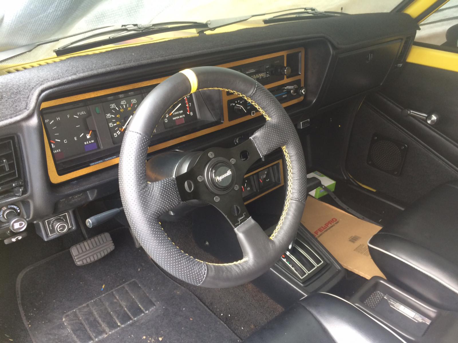

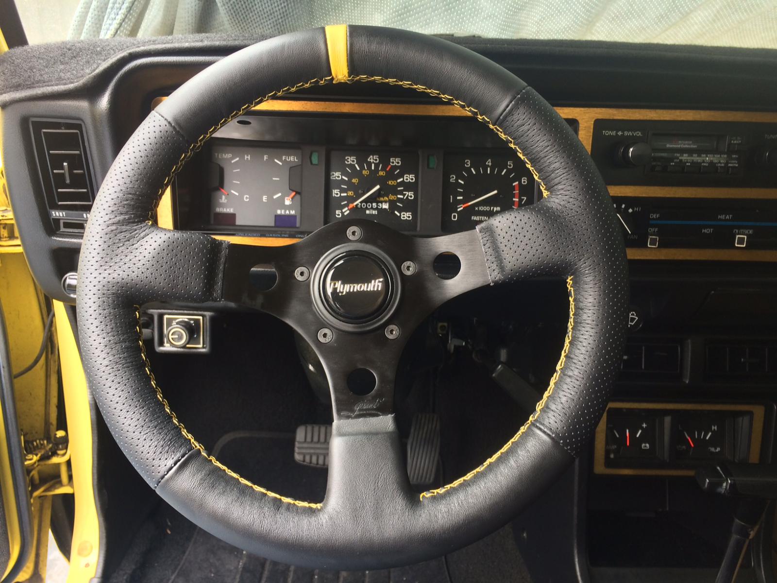

    New steering wheel in the car. I also installed a new stereo tape deck. The stock speakers have really come alive.
    A Hutch, you old school? Cassette deck just brought that to mind. New wheel looks wheely wheely nice too!

    lol. Thanks. As far as old school....Yeah, kinda. I found the cassette deck on line, brand new. I new it would fit with almost no modification.
    I don't even like cell phones.

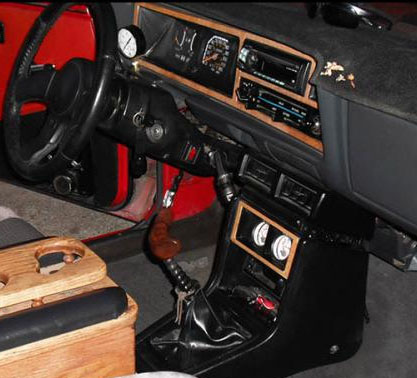

    Your dash looks very similar to mine also. I inlaid some wood veneer, but will be changing it to carbon fiber this week.
