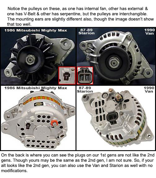

    1st gens were able to switch out to a 100amp off the 1990 Mitsubishi Van and 87-89 Starion, both 100amp. Depending on if your switching from another vehicle's alt and going to upgrade yours for higher amps will decide on your amp plug, pulley, and mounting ears.
    Just for example which I am not sure this is what your searching for.
    The 1st gen upgrade to 100amp has some changes to do before it fits. One being the plug in the back. Though I think yours has the right plug fitting for a straight swap. The next thing to watch for is the mounting ears. These should be in the same position so you don't end up having to buy a shorter or longer belt if the upgrade is different. Last thing would be the pulleys. Serpentine or V belt design and they also come with internal pulley fans and the external pulley fans blades. Other then these things, the swap isn't hard at all.
    Here is an image of the 1st gen alt and the upgrade to 100amp.

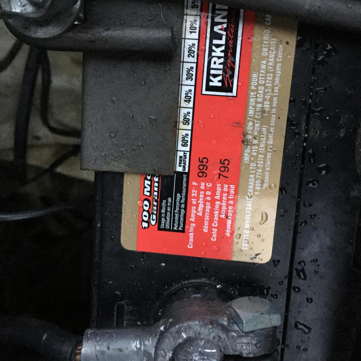

    thanks appreciated, im still looking for the montero alternator part number, if anyone knows it or knows someone that knows it itd be appreciated, and how do i go about a higher cca battery, anywhere that sells batteries will have these or whats the deal?
    05-27-2013
    31
    abbotsford,B.C.
    what cca do you recommend , if you know by any chance?
    Go big - like 500+ CCA's. It will keep a heap of power on reserve when you need it and the starter motor will throw the engine over with extra muscle. I went a bit silly with a Galant wagon (think 70's Dodge Colt) I built from bits of everything and used a 13 plate light commercial truck battery. It could jump start the universe lol

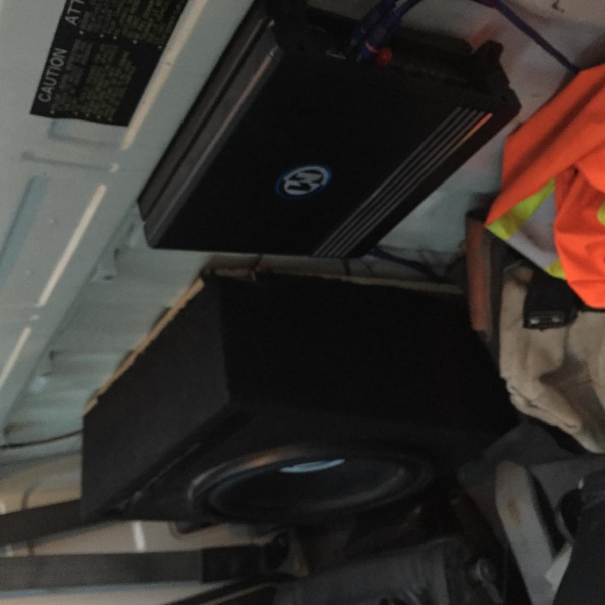

    It is not powered when the key is off, and I have led headlights , aftermarket tachometer , aftermarket deck amp and sub.when I get home from work today I'll check the one live wire to the amp. It's live when on,correct?
    05-27-2013
    31
    abbotsford,B.C.
    I'll post pics tonight

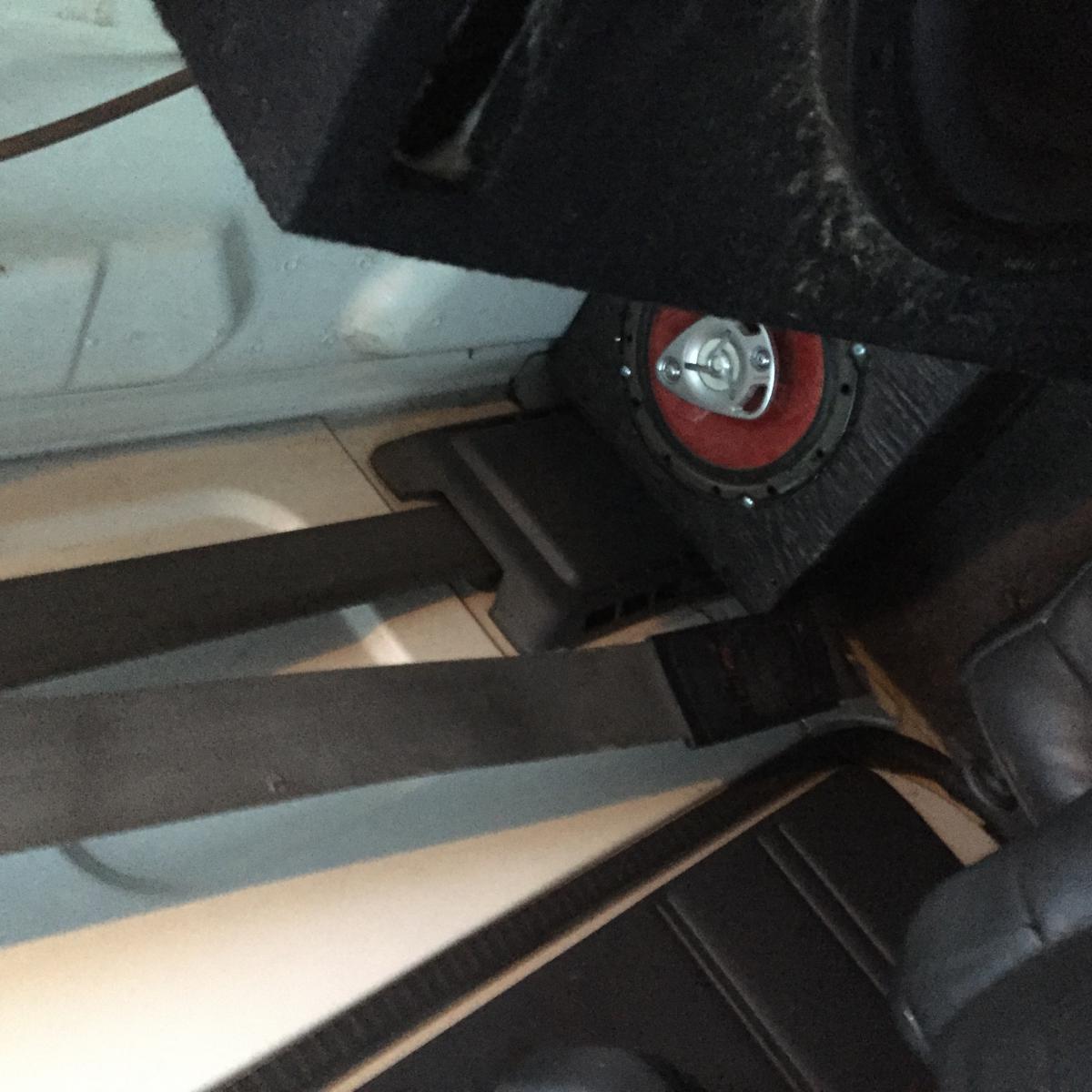

    so on my amp theres two connections that have .03 volts and one 12 volts. forgot to mention i got 2 6 inch speakers hooked up. is there anything on the back of my deck i should check out? certain voltages on certain wires?
    my cousin did some wiring to a switch so i can turn off my headlights and its 16 gauge , way too thin compared to the other wire already in there, which my dad says that could create a draw.
    i have learned to not trust another 18 year old when they say theyre basically an electrician.
