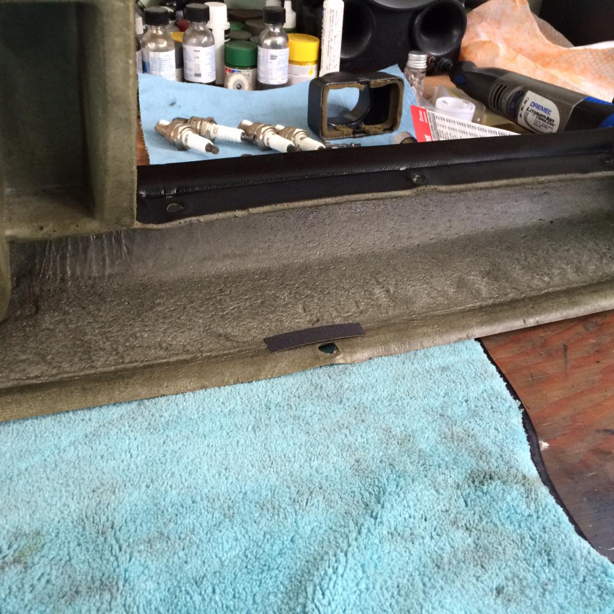

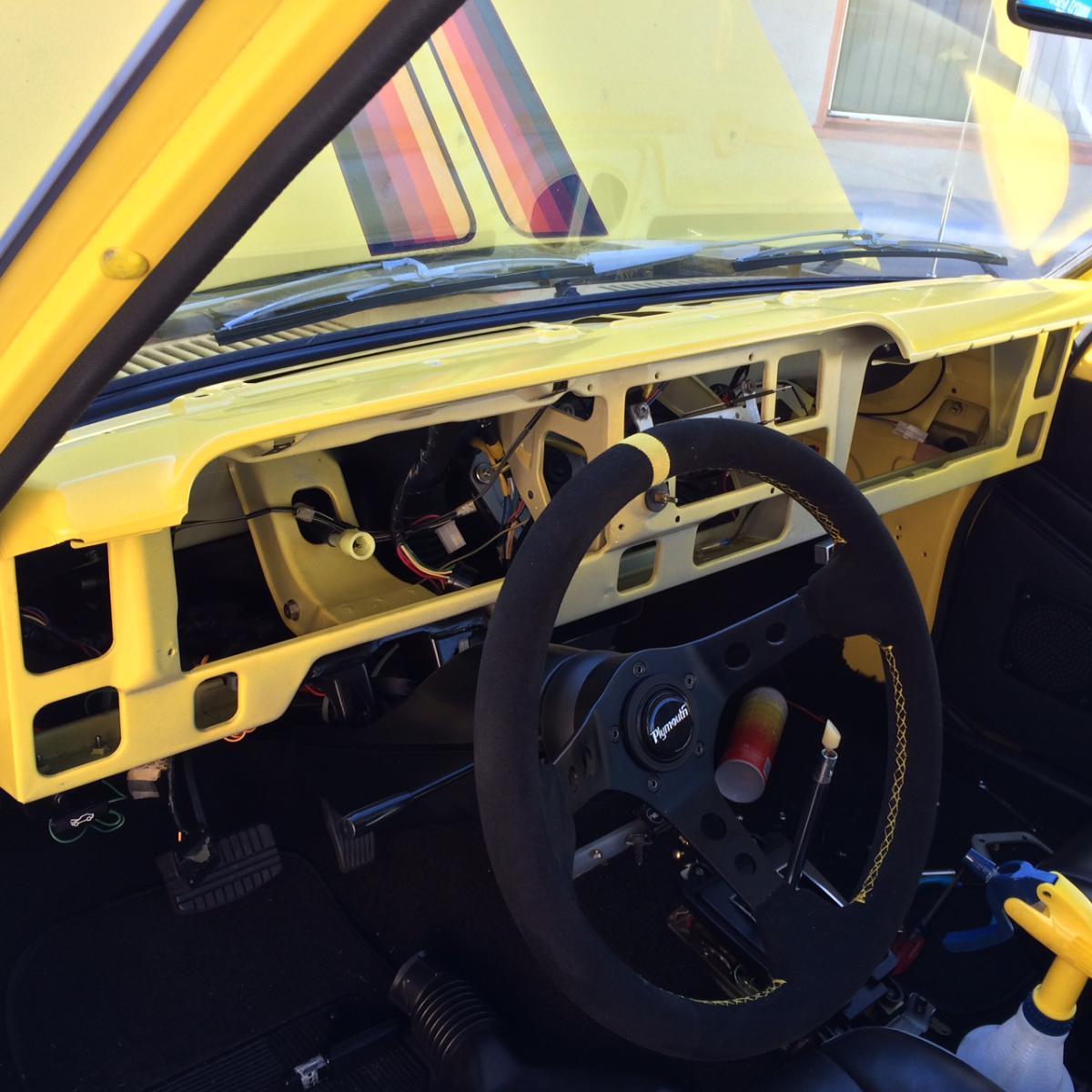

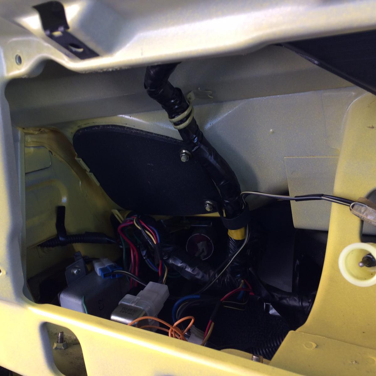

    Also installing A/C. The entire dash didn't have to come out but wanted to modify the dash where they always start cracking. Luckily mine has no cracks yet and want to keep it that way. Took some sandpaper strips and epoxied 'em.Click image for larger version.

    What's going on in the last pic, the one with the random bottles & spark plugs? Can't really tell what the important bit of that pic is since I don't recognize it, thanks much for your reply - I need to pull the dash sooner than later here.

    I'm epoxying strips underneath the dash. Where the cracks usually start from. I'm just trying to prolong or completely eliminate the possibilities. Make it a little stronger in those areas.
    2,801

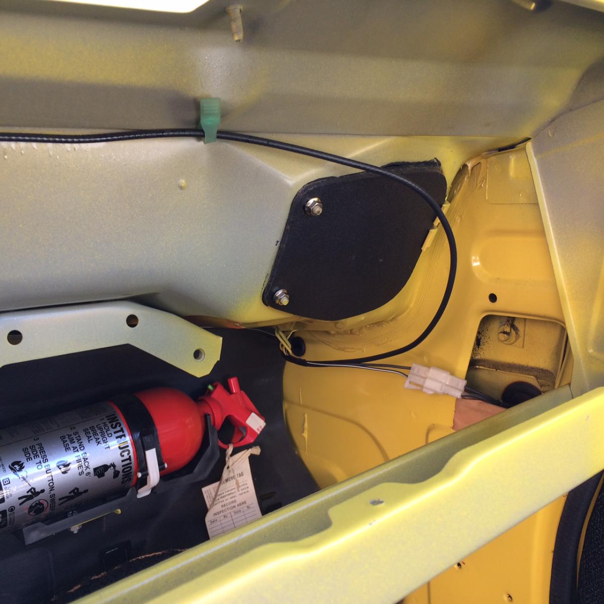

    I see block off panels for the side air ducts - you didn't have vents in the dash? I got annoyed with how the vents were set up in my truck as they weren't fan forced and it has A/C installed so I'm working on a way to direct air from the blower case outlet. The dash padding doesn't normally split from inside (well in my experience anyway). I've used cheap ass tire shine spray to keep the shell of dashboards pliable. A light squirt and rub it in evenly by hand all over. It doesn't mist up and evaporate onto the windshield like armorall crap.

    It had them. Installing the A/C. It comes in the kit. There is ducting now to the side vents.
    2,801
    What? They actually made a provision to A/C the side vents? What do the new ducts look like? I'm having fun with musical ducts and have been lucky enough to find some that pass through the steering column support frame but the tricky part is ducting the centre outlet to the side vents. I'll have to butcher the centre vent casing to make it work but if I do a neat enough job I'll forgive myself...

    Geezer, the ones, ducts that came in the kit are round on the ends and flat in the middle to go through the center of the steering column. On the glove box end it said to route over but it was easier under. It's still hidden from eyesight and out of the way. It also had a flat section.
