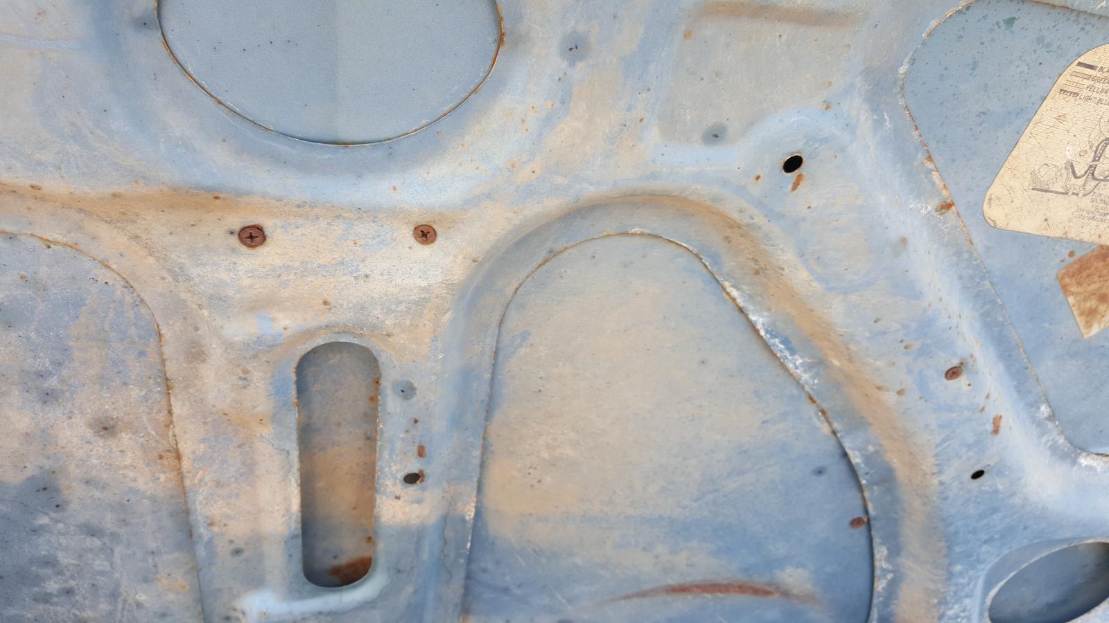

    the hood scoop is awesome (would like to see some pics how it was attached) & interior pics!

    RT you had said you want to see the scoop ad how its attached, it looks like its basically screwed in from the bottom. Ghetto status!
