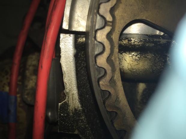

    I didn't see this blurb since I was referring to my Haynes during removal. My camshaft *totally* lifted as I removed the rockers. Then I saw this after I put it all back together with the new stem seals:
    One tooth off at the cam with the crank at TDC. I'm almost positive that I didn't turn the camshaft when I removed the rockers. I had the belt marked in two places.
    Could this somehow be preventing me from starting? Do I really need to reinstall camshaft and timing belt?

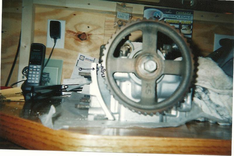

    It's certainly possible you screwed the timing up. And it looks like TWO teeth instead of one.
    Hey, forgive yourself and if need be, re-set the belt. Make sure the distributor is in the proper position. REMEMBER the timing mark is below the top of the head.

    Best place to start is get everything to TDC and see if, in fact, the timing is off. Once at TDC, check your distributor position.
    As it stands, you might be able to get it to run by loosening and twisting the distributor to one extreme or the other. If you can, (at the extreme) then it's likely you are off with the belt. If not at all, I would say the timing sucks.
