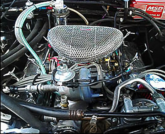

    Hey all,
    I'm having a rough time with my Weber. I installed it in August, and It's been running okay but not great since. Been fussing with it, and I've noticed that it won't open the choke completely. Can't quite figure out why, thought maybe one of you experts might have some advice. This is as open as it gets:
    Thanks!
    2,801
    Hi Wote. Are the choke butterflies closed up tight when the carb is cold? If they are then you have scope for adjustment - loosen the 3 retaining screws holding the electric choke housing down and rotate the centre section so you can physically see the butterflies actuate. I would take a guess that the best time to do it is when the carb is at normal operating temp, then adjust it to the point where the butterflies are just at fully open. If it's overkill and the butterflies are open at cold and it's struggling, you'll have to back off your adjustment a little until they are almost closed (carb cold)
    4,307
    You don't have enough choke pretension on the choke. With the truck cold, loosen the 3 screws and turn the choke cover until it closes all the way. Then get in the truck, push the pedal to the floor once, and start the truck. Once it starts, tap the pedal lightly - it should open slightly as it steps to the fast idle position on the cam. As it warms up, it will step along the cam until it is fully open. Also be sure there is no binding of the choke linkage.

    Oh hey thanks folks!
    I'll poke around at it today and see if I can't get that sorted out.

    That helped immensely. Thanks everyone.
