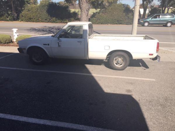

    I have a 86 ram 50 2.0 3spd auto, been in the family ever since 86. Started as my aunts where most miles have been put on, then passed to my father in 95 where he used it for 2 years and then had a son in 97, it sat and was lucky to run 2 times a year for almost 17 years, now its mine. 2014 after seeing it for 18 years, growing up with it, it was not in the best condition, white paint orange with rust, and oil burning because #3 valve seals, and a transmission that wouldn't shift right. and headlights that worked 1/2 the time. 1 year has gone by 98% of the problems resolved. My friends told me I should have scrapped it, but I said no, I want that truck. Getting from the before to after was a hell of a journey, 3 transmission places 2 that F-ed it up, and 1 that got it to shift like should, 3 cracked bolts, 1 head that needed replacement, 4months it took for paint, and many other things. At the end of this month I hope to turn the key and hear how he runs for the first time in over a year, or like how he was 106k miles ago... that is if that rebuilt Mikuni carb works like it should lol... Here is what he looked like then to what he looks like now.
    Attachment 14905Attachment 14904 Yes it is the same truck lol
    Let me know what you all think, I'm going to be working on interior next, I plasti dipped my rims also, just don't have a picture yet of them. Only thing I think I'll need to worry about is smog lol. Any recommendations on what to do next? I don't want a weber, it had one for a mt, and ran worse it seemed, maybe it was a fake, or because the trans kick down lever I modified didn't work great cuz it didn't come with conversion for the auto. Plan to keep him stock performance wise, though maybe someday do a engine upgrade and call him my redline srt4 ram 50 lol.

    Welcome to MR50 Fenstermaker. Said it plenty of times - these trucks die due to lack of servicing. Heads on the early 4G63's were prone to cracking but that isn't a deal breaker. And we are all glad you didn't listen to your 'friends' and scrap it (what kind of friends would even suggest that!!?!). Soon enough you'll be looking through posts and build threads and getting ideas. There are a ton of options for upgrades and mods on the 4G63 and who knows, you might decide to do something different all together.

    Btw did the pictures show? Wondering if i did them right.
    Nice work - mission accomplished Fenster! (not in a George dubya way either) btw your D-50 looks pretty sharp in it's fresh paint. What have you got planned next?
    Thanks lol, Now I'm going to focus more on the interior. going to attempt to fix the cracks in the dash and do a vynel wrapping to go with the new paint. Then make some new door panels (with a cupholder In each door, lol) to also go with new paint. I have a power lock, and power windows that I have installed, and the 2 speakers in doors and a 4.1 sound system that sits behind the seats with 2 amps under the seats. Got to have that sound lol, but it's only used for parties. Also got some red underglow and bed lighting to instal. To acomidate all the power theres a 100amp alternator. I also did some paint work under the hood with the intake cover painted and exhause heat shield and timeing cover painted. Thats it right now. To drive him, ill need to get smogged image.jpgshould pass, doesn't burn oil anymore, or seem to run rich.

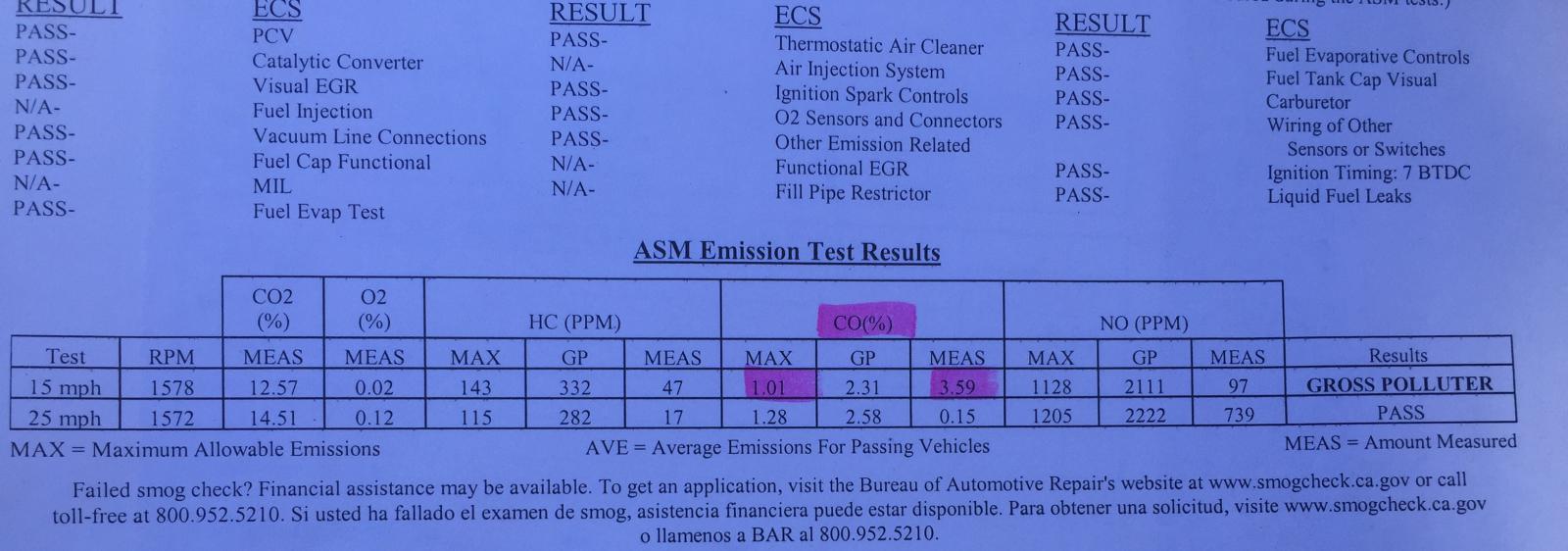

    FullSizeRender.jpgSo close to passing dang you Mikuni carb lol... Found someone on this forum that I'll take it to soon to get it adjusted right and pass hopefully. Then I'll put my weber back on lol... Can anyone link me to or tell me a site to get the auto trans kick down rod attachment for this carb? My fix "worked" but wasn't great when I had the weber on. Also how would you know if a weber is Genuine? Kind of not thinking mine is genuine for some reason, it had a Weber sticker that fell off (which makes me wonder if its not real) and a warranty sticker that's still on. Bought on amazon, and 5 reviews with 4.7 stars. Also before I swapped carbs, I noticed a puddle of gas setting in the manifold, like a 1-2 ounces... I can post a few pics of it if needed.

    There's a sticky on buying a Weber (you think I could find it?). A genuine Weber has the manufacturers' name cast onto the body of the carb. There are a lot of junk copies of the 32/36 floating around and enough members here will warn you to keep clear of them. They are literally untuneable and dump fuel like there's a hole in it somewhere. I think the resin bodied Mikunis' performance issue relates to the overlap between the primary and secondary throat. If the secondary could open earlier in the game it would fatten up midrange torque.

    Im thinking I have a junk weber, ill go to webercarbsdirect and see what they got, no wonder I didn't like the performance of it when I had that weber I had on to begin with, didn't seem right. Yeah secondary might be the problem on the Mikuni. If only the 30 year law that made cars require smog, I think they go rid of it in 2005 sadly, wouldn't have to worry too much on this stuff.
    If you're required to run the anti-pollution crap on the engine be aware of how it works and what it does. If the exhaust gas gallery is coked up then it will mess with your gas analysis. Make sure the gallery through the head from #4 exhaust port is clear, the gallery running from the port under #3 inlet runner around the inlet manifold to the EGR valve is also clear and the EGR piston has free movement. If it is badly coked up and blocked I have absolutely no idea how to clean out the EGR gallery on the manifold. This stuff is the worst designed pollution control system you could put on an engine next to the 'smog pump' which fudges the numbers by forcing clean air into the exhaust manifold and through the exhaust system (companies were doing it back then and VW is doing it now...)
