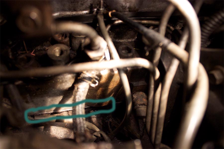

    Before I figure out how I'm gonna pull together a head gasket replacement, Can anyone tell me if this is a head gasket leak? It's dried up in this photo but deffinately coolant/or oil coming out at this spot.
    Thanks!

    although that is the headgasket, you have oil trailing from above, that can run down to it

    Yeah hey. It is most deffinately leaking where I've highlighted. Time to swap the gasket and hope the head is still good.

    An update...
    I flushed my coolant, and switched out thermostat with one rated for 82degees Celcius. Since that, I've been running a little cooler than usual, and have yet to have a temp spike, like it did before. Where it was leaking in this photo, it's not anymore since using some stealseal. What are peoples thoughts on driving with this situation? I know its a very temporary fix, but I'm in a spot where I need to drive, and dont have the $ for a full repair at the moment. Other than the visual leak, no other signs of bad headgasket failure. Just wondering so I can maybe be less nervous while driving, or maybe more for that matter, haha. Thanks again.
