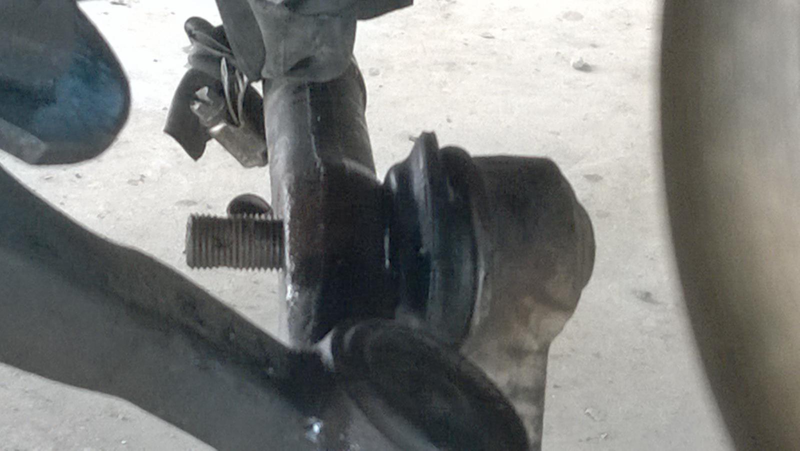

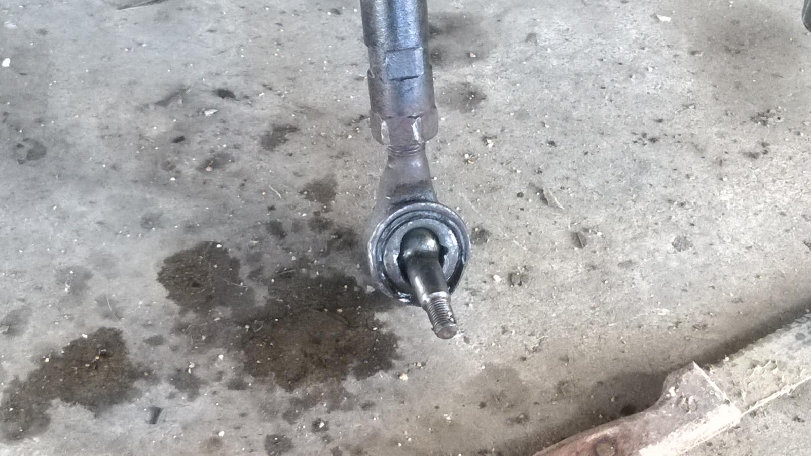

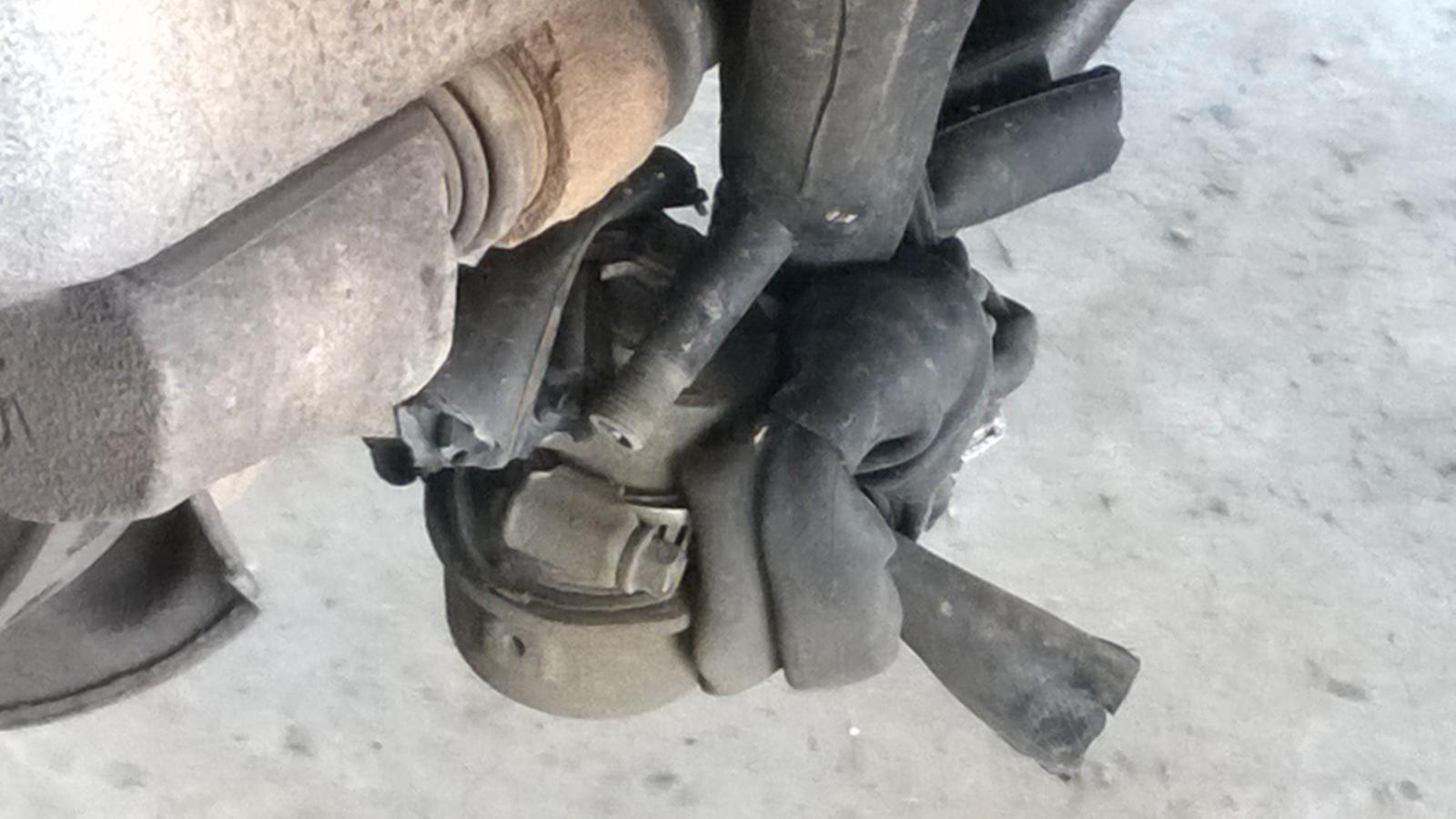

    Previous owners tie rod fix. Complete moron.
    He told me that they needed to be replaced, not that it was unsafe to drive.

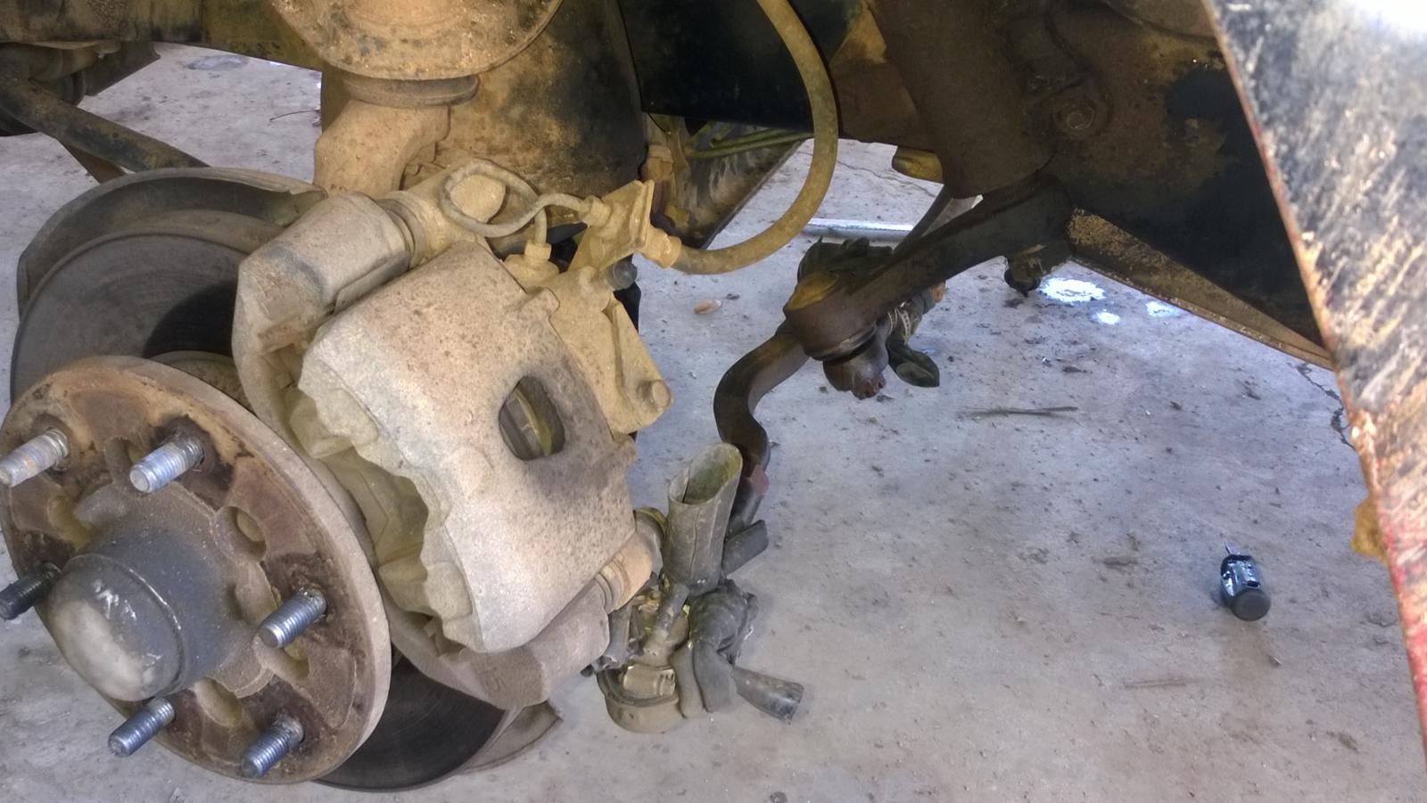

    Cant really see it but that top caliper bolt is the one that has the cap on it. Other side is the same. Dont worry about the tie rods. Those were the first things I replaced. I can get better pics of the cap tomorrow.
