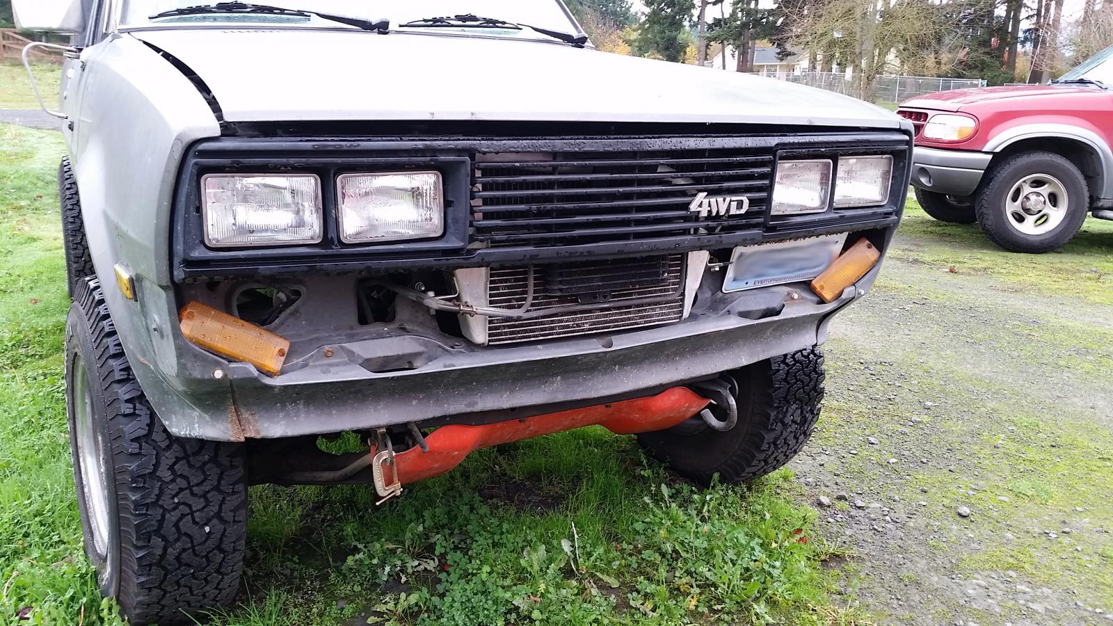

    Here's a quick shot of my intercooler, I still have to finish plumbing it up, but I'll hopefully have that done in the next couple weeks. A friend and I are planning on building a new front bumper with winch mount. That'll be happening in the next couple months.

    So you shoved the intercooler between the radiator and the oil cooler? What is the oil cooler mounted onto now?
    The oil cooler is still mounted by the upper support. I have made two additional supports for the sides that aren't added yet. At the moment it's sturdy enough just with the upper hanger, but once I add the other support it'll help with any vibration or shaking. Don't want to fatigue the hard lines.
