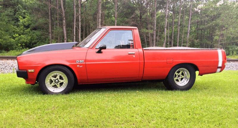

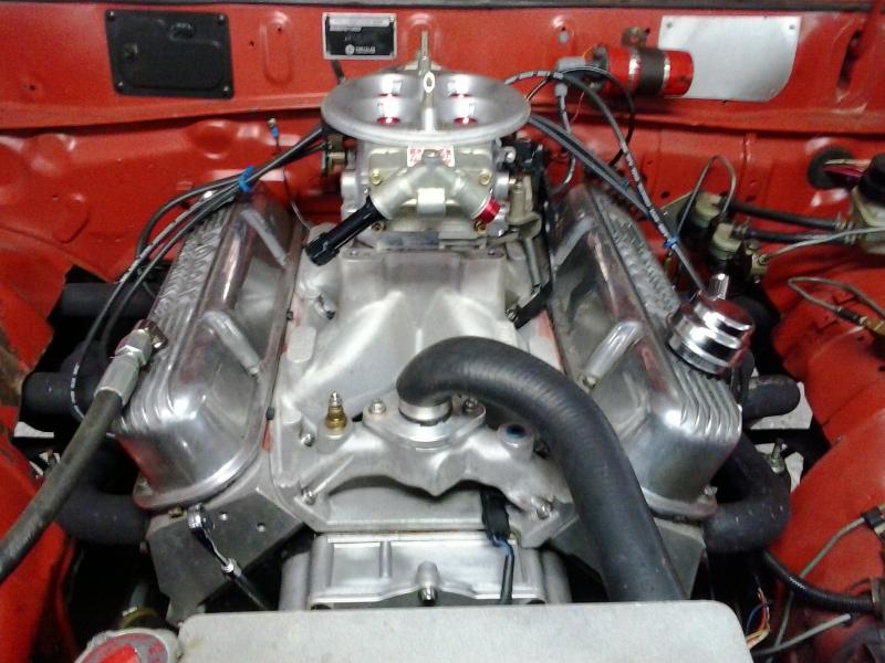

    07-02-2013
    35
    Alabama
    Dodge V8
    I started out with a 360/380 hp crate motor with block hugger headers in my 1980 D50. Then I built a 340 with a 3.79 stroke crank motor (394 ci) and put in it , I built 1 7/8 headers for it. You need some welding skills for the motor mounts and I had to cut the trans tunnel for the 727 trans. But I made a new one out of sheet metal that bolts back in place. Really you only need to make new motor mounts.
    There is also a guy in Glassport selling a Conquest and plenty of parts to build at least 2 more motors - look under Conquest - its the only one there.
