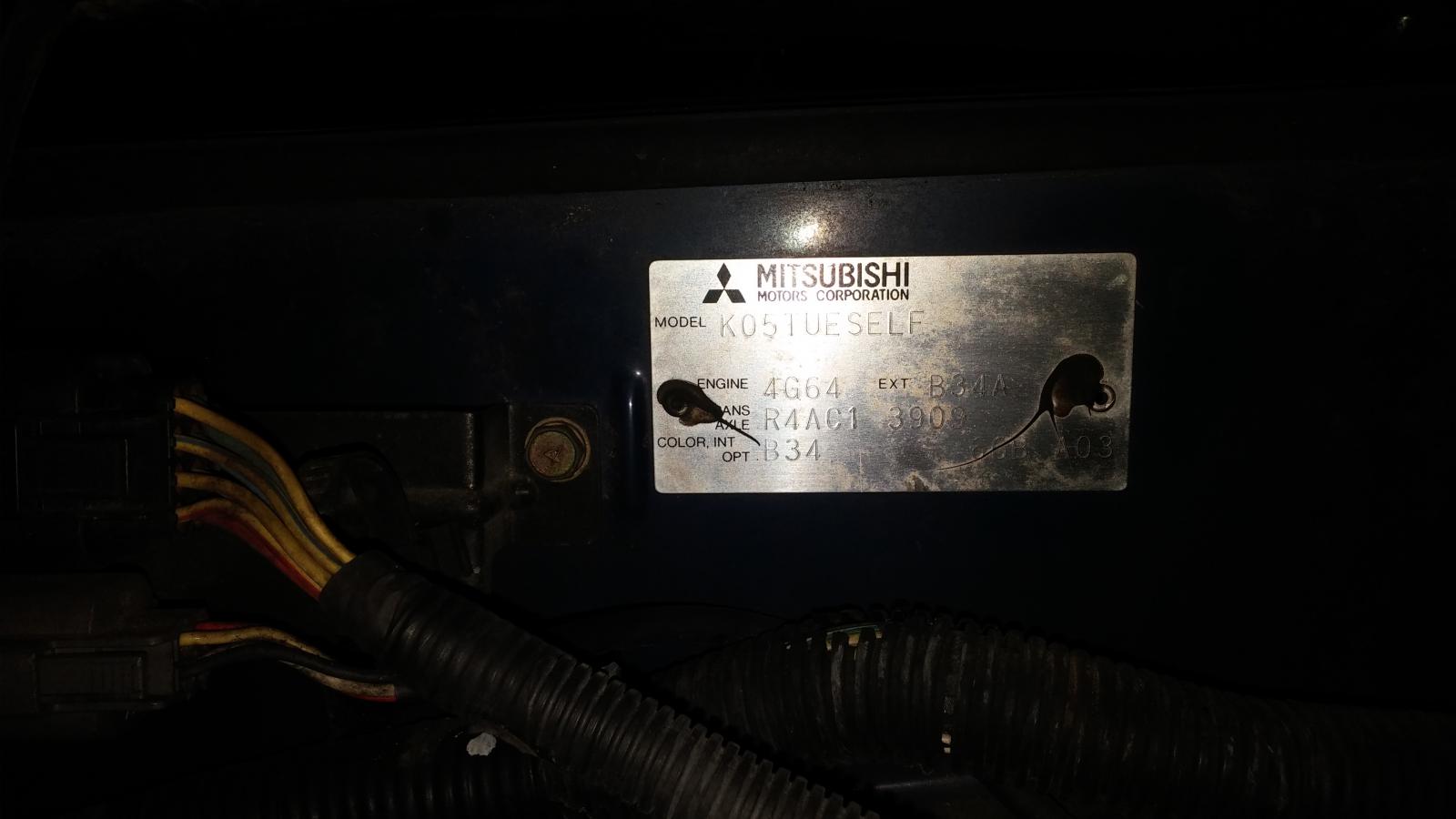

    You can find your engine type by looking at the tag on the left side of the firewall. Get us some photos of the engine, wouldja!?

    Heres your pics! (so demanding, LOL! Noobs get sensitive! Ha!) Also, power steering pump was leaking right onto the alternator and the belt, mu guess is the power steering fluid was leaking which accelerated the belts deterioration. The leak seems to be coming from the bolt and nut holding on the hose which is connect to the pump on the top. Any suggestions? Rebuild, buy a new one, try a junkyard....? Called Autozone, its going to be about 25.00 for all belts.
    Let me know what you think!

    Thanks! Looks good! http://www.mightyram50.net/vbulletin...chmentid=15523
    Looks grubby but good. 4G64 - 2.4 litre Sirius engine. Power steering and air con! Very nice
