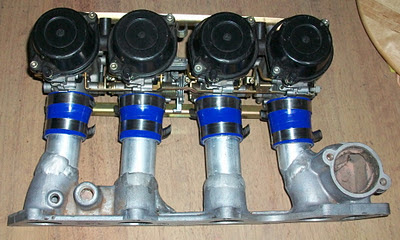

    2,798
    Get the best of both worlds then markmakeitso -
    A little bike carb insanity just for you...

    If you decide to mess with bike carbs, the build and tune thread on sigma-galant is pretty extensive (McGoogle it and you'll find it quickly). I personally would've spent more time on the inlet manifold and also a design for a plenum to improve torque plus allow for cold air induction. Hot air is bad for bike carbs on a bigger CC engine. I haven't had a good look at the 2 barrel Ford ECI so I was only having a guess at compatibility (Ford used Weber carbs on a number of engines - it was only logical they wouldn't change their design too radically). The Mikuni DIDTA type carbs are not fun to pull down and rebuild but they do an amicable job when they're working correctly.
