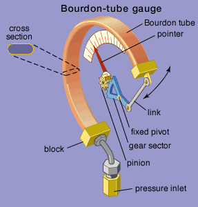

    3,614
    Depending on the guts of the thing. Most work the same way. Just they add in a wiper and contact strip.
Name:	bourdon tube2.gif
