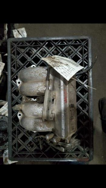

    typical 2.0L starions used modified fwd hyundai sonata intake manifolds for their multiport conversions
    this very quick 2.4L starion retained his converted intake
    this beast grafted a plenum onto the stock truck intake manifold. Dyno'd an impressive340hp at the wheels @ only 16psi

    we also have that intake on 91-92 galant and expo,i have one modified,waiting on some more parts before installing it permanently

    your manifold looks like yet another oem MPI option.
    It don't appear as if you needed to modify the water outlet/thermostat housing location at all. Perfect?
    The sonata intake coolant runs from the back of the cyl head to the radiator top tank

    The factory intake manifold is a 2 piece design, i have the lower intake manifold from the truck and upper plenum from the galant

    [QUOTE=Rahtid;45715]we also have that intake on 91-92 galant and expo,i have one modified,waiting on some more parts before installing it permanently
    /QUOTE]
    Can you give me some more info on this.. I want to build one just like it!!

    Never mind, I found it..
    I got one off a 92 galant and one from a 92 expo form car-part they are shipping them to me today..
