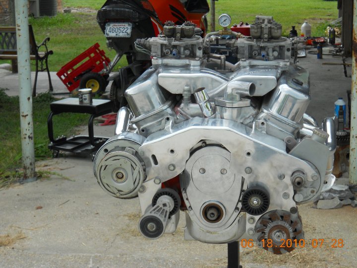

    But I could make what they call a tuffpan on the 2D CNC mill we have at the shop. Its basically a CNC routing table that is stout enough to work with aluminum. Considering the tuffpan is just a flat plate and we have made far more complicated designs starting from 2D parts.. My buddy is a design engineer he has worked for Cameco Tractors and John Deere designing tractor parts..
    Here is a photo of an accessory drive he designed and we built for a SBC.
    Cool. If you decide to green light this please set up a thread and post some nice pics. If your bud can mill up something like that pulley system for a SBC, he can make a sump cover in his sleep. IDK if tuff pans are still available, but if you can make something similar and cost effective, you could possibly have a market to sell them through the site if there's enough interest...
