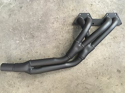

    Out of chance I E-mailed a guy selling the L300 header as they offer a shipping quote built in to eBay. He let me know he did have the L200 headers available.
    I purchased one and hoped for the best.
    It came in and got in on today. I can confirm it's for a L200 / Mighty Max and needed no work to get it on. Bolted right up with the correct size at the bottom. I have seen a few people on here getting the L300 one then having to either bend the header or do extra work to the cab. I didn't have to do any of that so I am very happy.
    Please do not just purchase from this eBay ad. E-mail them first so they can confirm they will send the L200 header.

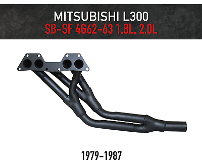

    Was checking out eBay for L300 headers to see how much work they would need to get to fit. This is the one I was looking at
    https://www.ebay.com/itm/254585636961
    I then thought I would send a message to see if they can get any for the L200. He got back to me and confirmed he could for the same price. I was over the moon.
    Ordered it and waited about a month for it to get here. Put it in today and it fits perfectly.
    I asked the seller after to see if he would mind me getting the info out. He didn't mind so here I am.
    Please send him a message first. He will ask you to add in the notes when purchasing for a L200 header.
    I'm very happy with this. Saved me a fortune getting one custom made.

    There is. The exit to the header is lower on the L200. If you use the L300 version you would either have to bend the tube, extend the tube or some people have bashed the underside of the cab in. You don't want to do any of this if you get the one that fits.
    The engine position of L300's is low and behind the driver so they were able to make the primary pipes shorter to pull it up under the van chassis. I bought a stainless steel set too from a JY cheap knowing it wasn't going to fit but was prepared to grind through welds and add pipework to mod it. Then the donor truck showed up with headers and saved me the headaches...

    Thanks . Yes looks like high heat paint . I hope they wouldn't go through all the trouble making these and use a paint that will flake off . Fading is understandable seeing it's a header.Also I heard that wraping the header will cause it to decay and rust faster ??
    Our headers are MIG welded and feature a hi-temp heat proof coating for a lasting and reliable finish. Our extractors are Australian manufactured with over 30 years of experience in exhaust design and fabrication.
