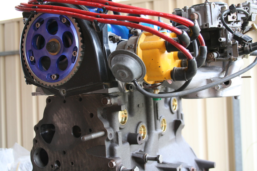

    2,784
    I cut out the cam gear cover on my 4G63 - the front face of the adjustable cam gear sits flush with the cut out section of the cover. You can see the whole gear without the teeth being too exposed. Here's a pic of it dummied together:
    http://i1089.photobucket.com/albums/...psjo1csrec.jpg
    11-29-2015
    137
    miami, fl
    1991 Dodge D-50
    geezer101, that looks fine. Doesn't protrude much at all. I can live with that
    thanks for the replys
