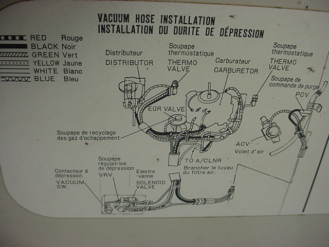

    http://www.mightyram50.net/vbulletin...-hose-diagrams
    Below is one that might work.
    http://mightyram50.net/camoit/picts/hoserouting.gif

    When was the truck built month /year? You may have to look at 81 emissions to find the right diagram - Mitsubishi had a bad habit of changing emissions plumbing mid year.

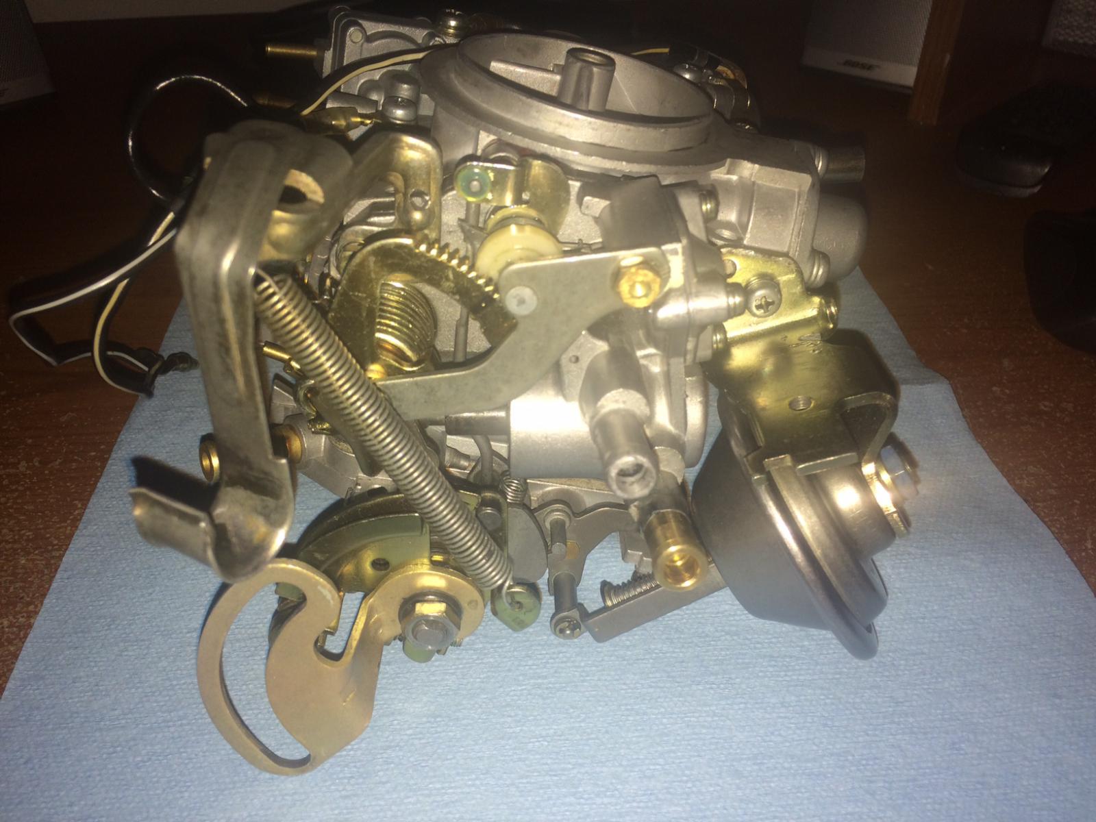

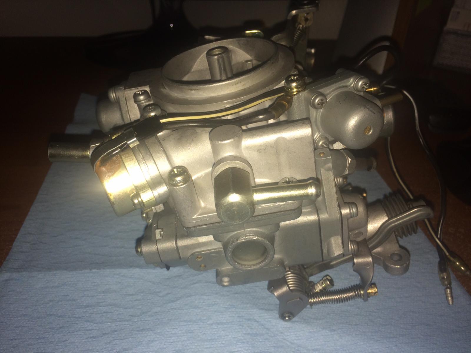

    Here is the finished product.
    This is like three carbs built into one. Some of the parts are brand new, like the choke for example. IMG_0457.jpgIMG_0458.jpgIMG_0459.jpgIMG_0460.jpg

    If you could connect everything that you are sure of, and then take a pic of the carb and post it, you might jog someone's memory and get the answer you're looking for. Its difficult to guess where that port connects to. There are several different versions of these carbs and the vacuum systems are complex. You do know that if you plug the port the engine stalls. This tells us that the port connects to something that allows a continuous air flow through, so it would not connect to a diaphragm like the EGR for example.
