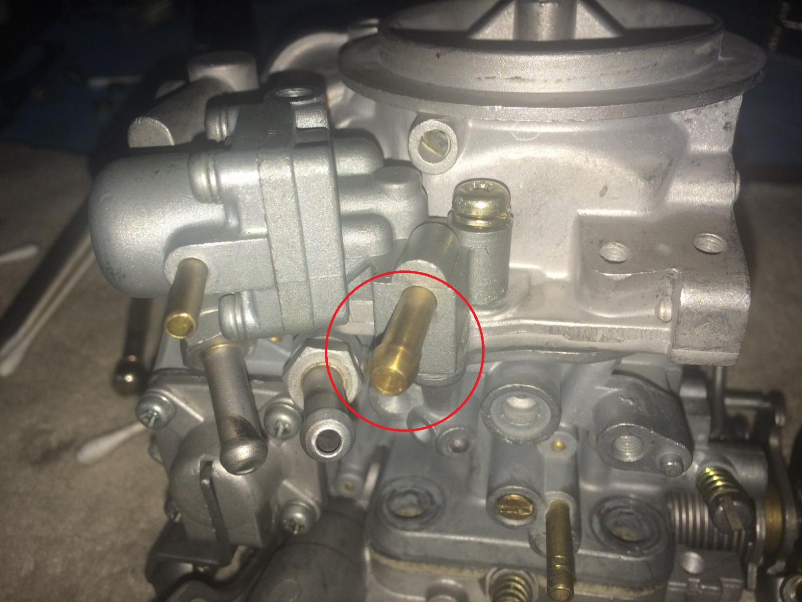

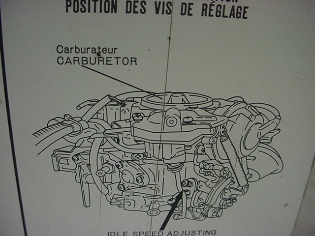

    Specifically from this brass tubing to where? The other is no problem. When I plug the hole the engine will die.

    I know it's in here somewhere.
    I'll keep looking. But if you find it please post them in here.

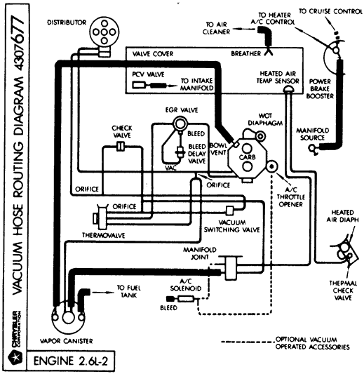

    http://www.mightyram50.net/vbulletin...-hose-diagrams
    Below is one that might work.
    http://mightyram50.net/camoit/picts/hoserouting.gif
    Find me on FaceBook
    clicking HERE.
    OMG, that is one nasty looking Mikuni carb. The amount of emissions control crap on that carb is scary. Is it manual choke or have you stripped it down?

    Thank you for your help. The carb. is a 1980 California. I have the 1980 that black manual. I have the Chilton. Just cannot find that one circled, pictured. Please don't go too much trouble but I do appreciate your help.

    Does that fitting by chance connect to the air filter housing??

    When was the truck built month /year? You may have to look at 81 emissions to find the right diagram - Mitsubishi had a bad habit of changing emissions plumbing mid year.

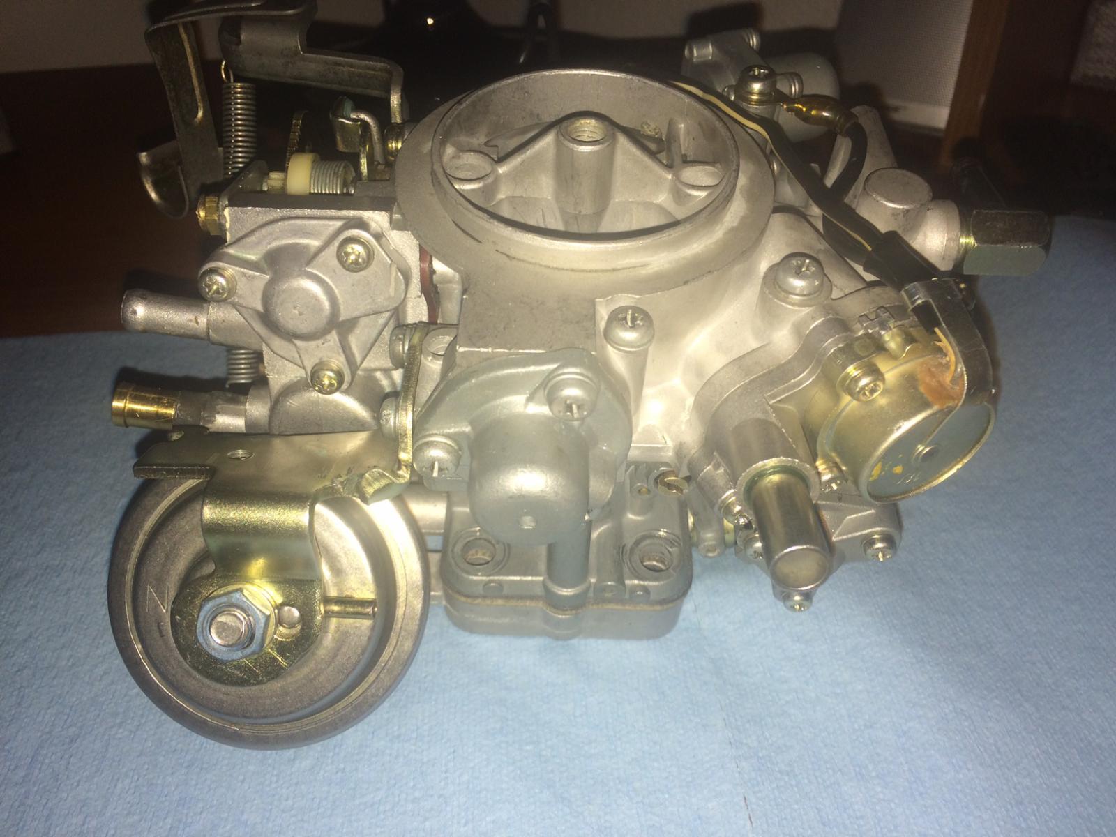

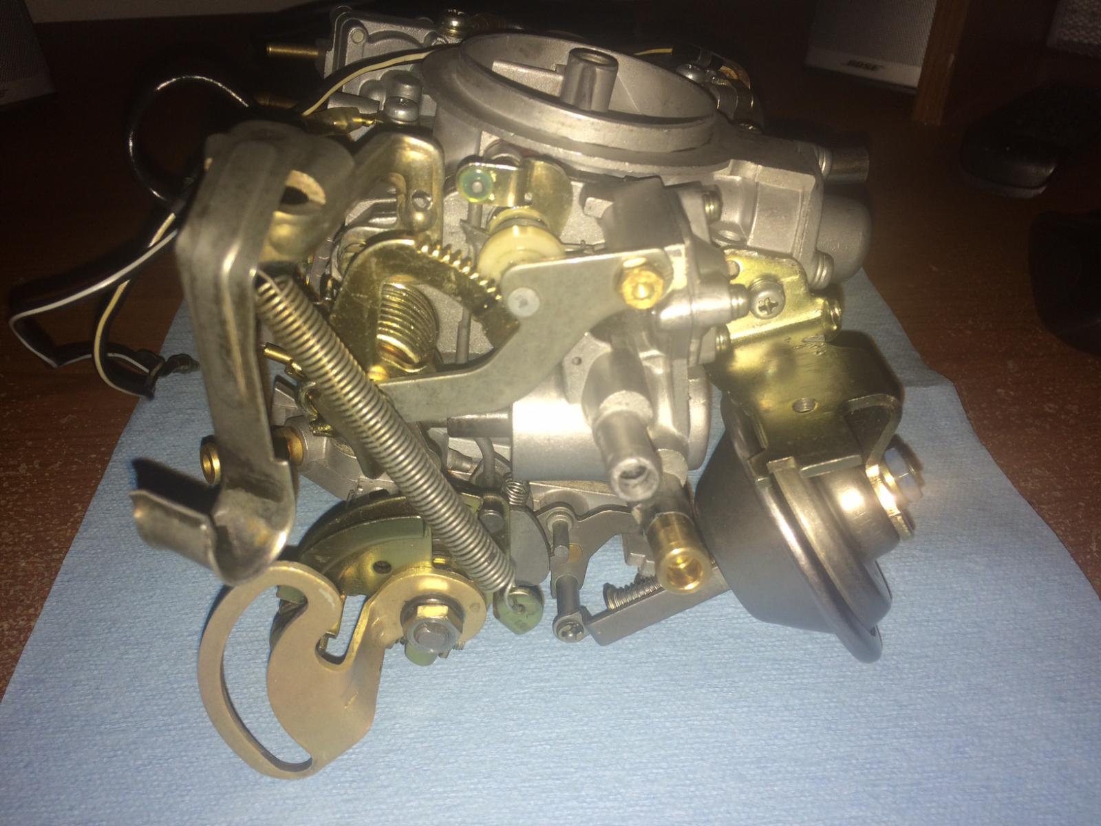

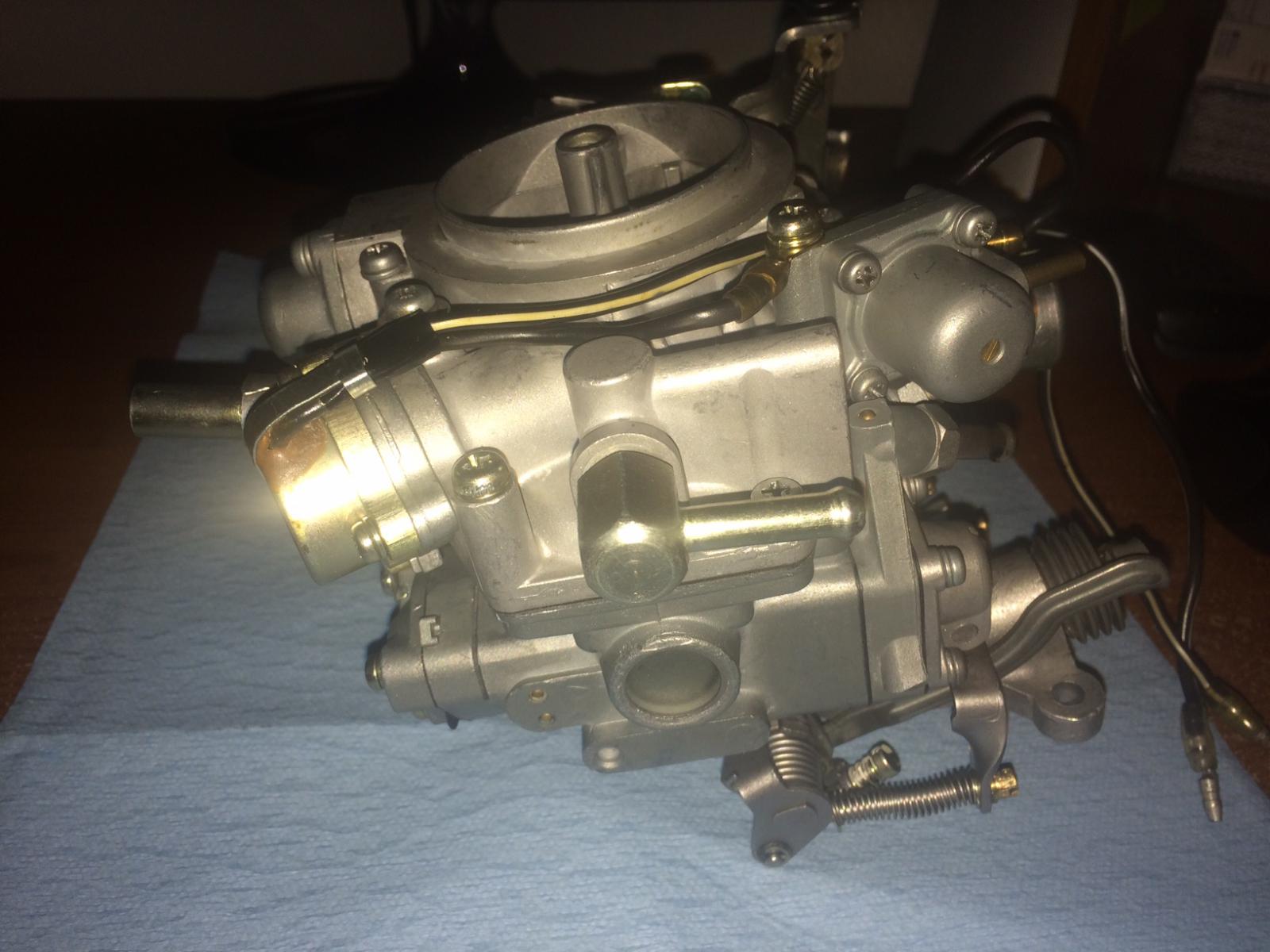

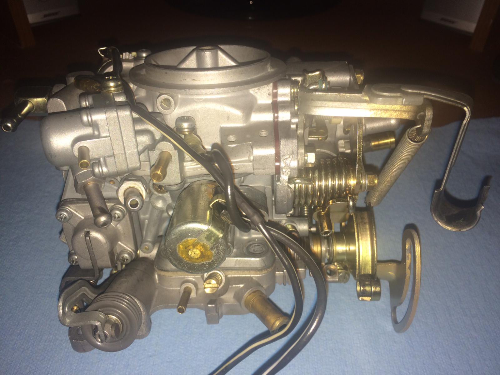

    Here is the finished product.
    This is like three carbs built into one. Some of the parts are brand new, like the choke for example. IMG_0457.jpgIMG_0458.jpgIMG_0459.jpgIMG_0460.jpg

    If you could connect everything that you are sure of, and then take a pic of the carb and post it, you might jog someone's memory and get the answer you're looking for. Its difficult to guess where that port connects to. There are several different versions of these carbs and the vacuum systems are complex. You do know that if you plug the port the engine stalls. This tells us that the port connects to something that allows a continuous air flow through, so it would not connect to a diaphragm like the EGR for example.
    1,267
    Simplest of possible answers: the PCV?
